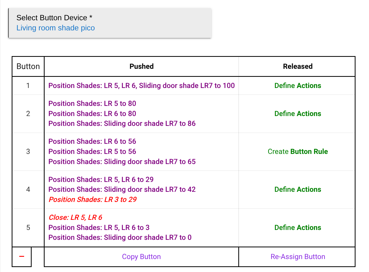

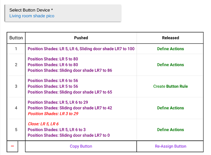

Footnote. They work great with pico remotes and the button controller app. Our west facing shades are normally controlled with a couple of picos with five preset levels.

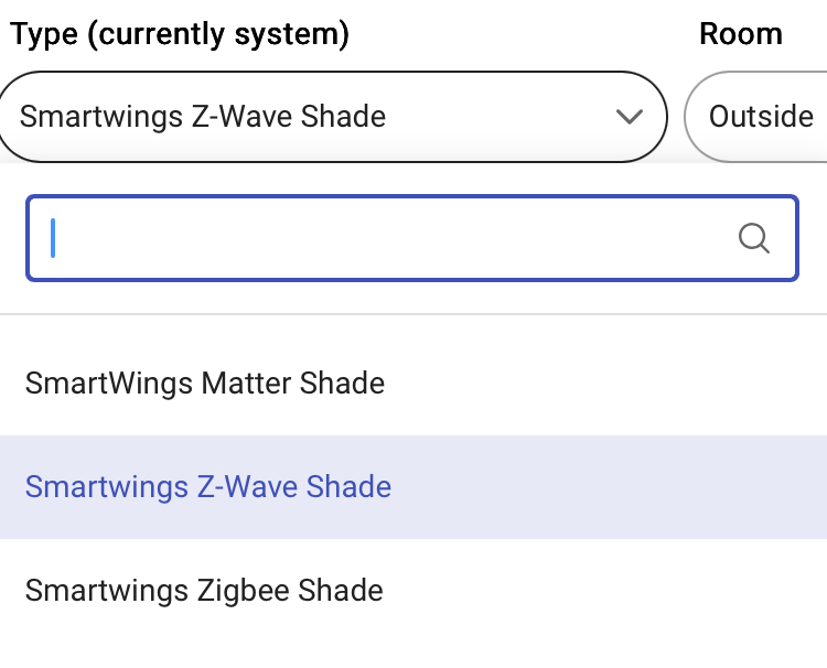

I have SmartWings Zwave shades, both Roman and Cellular, and yes there is an option in the driver to set them to xy% open (or close depending on your perspective). That doesn't change between Zwave, Zigbee, or Matter.
