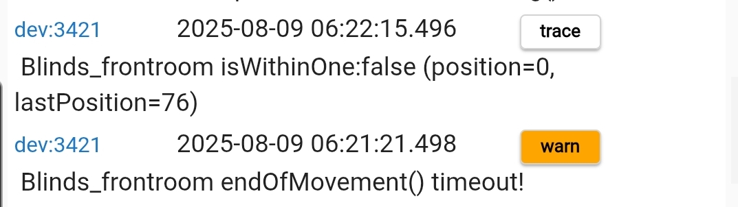

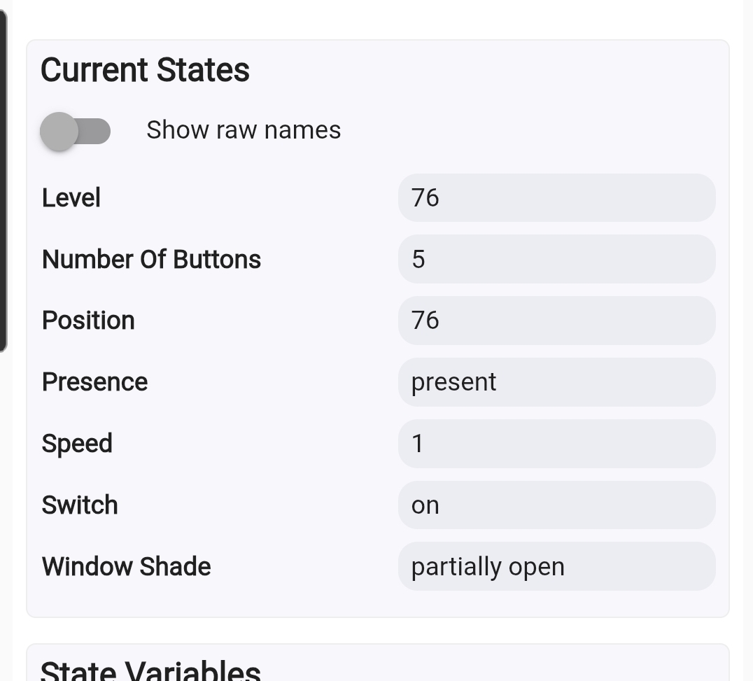

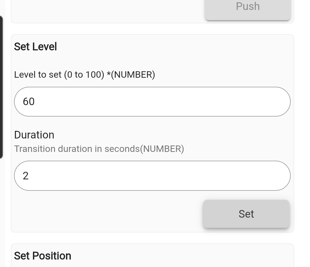

I suspect this may the cause of my woes here too...
