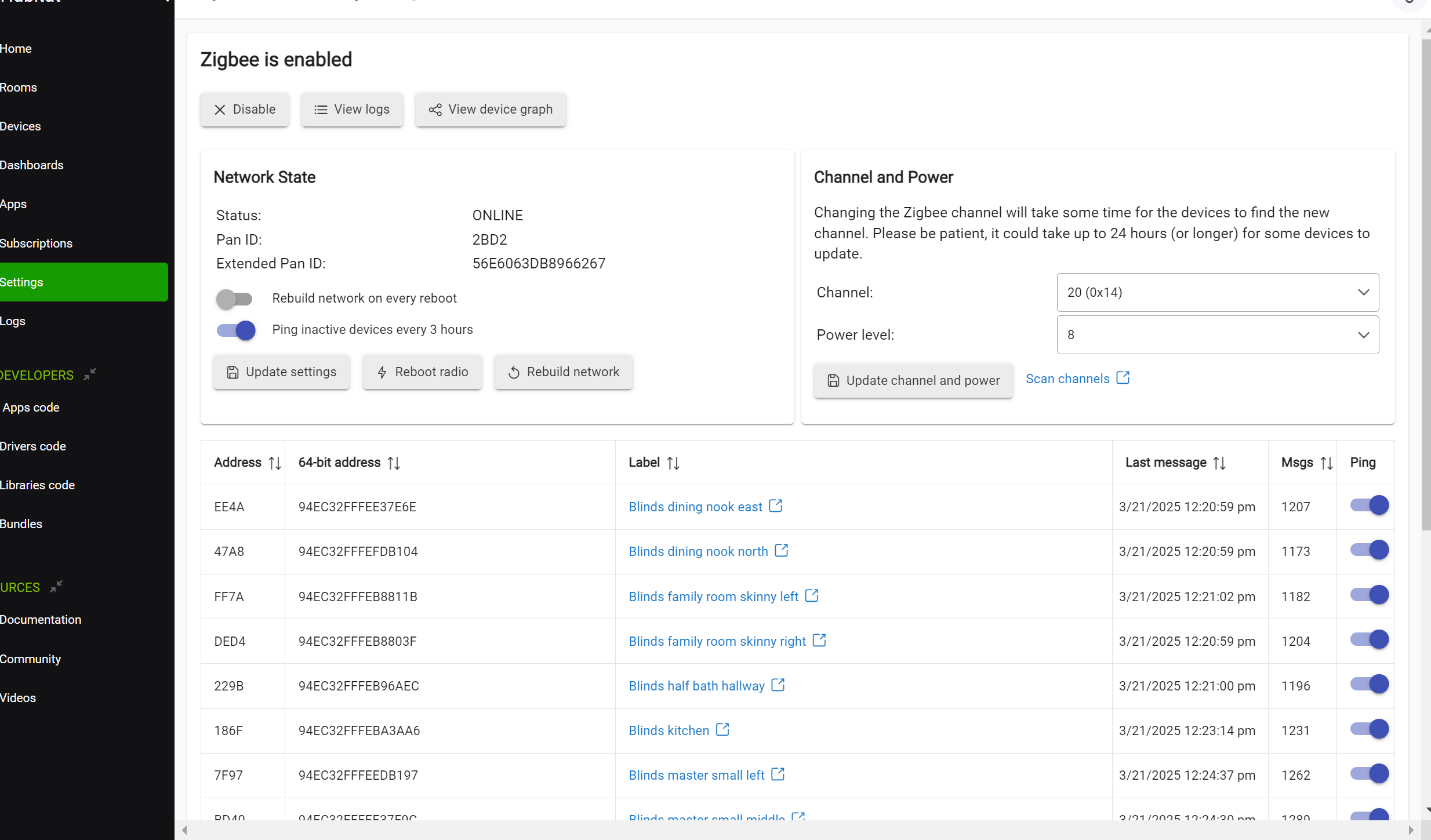

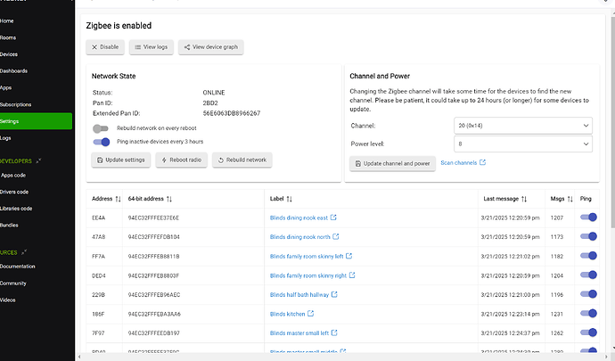

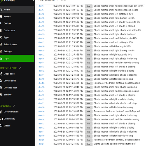

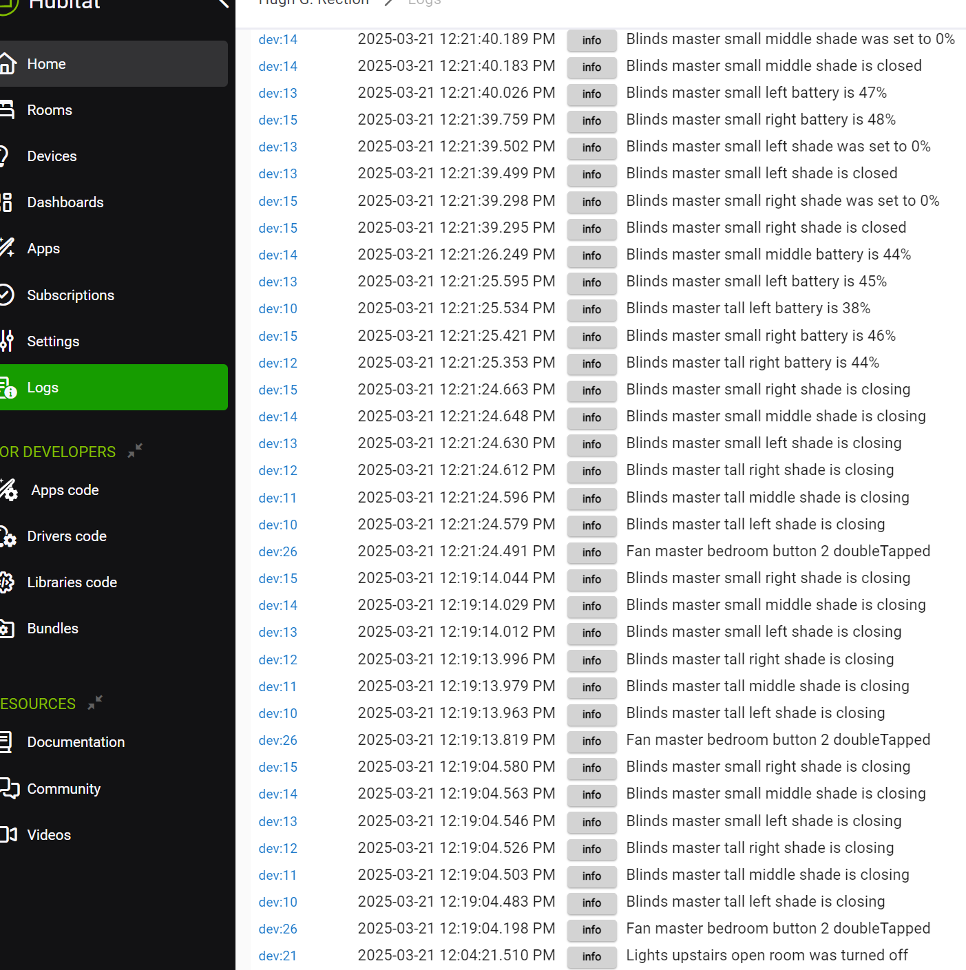

We recently moved into our new house and are slowly building out our HE system. Most things are working well except our Smartwings Zigbee blinds seem to fall off the network every day or two. If I reboot the radio, they work fine again, but I'd like to avoid doing that manually every day. The blinds otherwise work fine with their remote. I'm including my Zigbee network page and my logs to show that it looks like messages are getting sent to Hubitat, but the blinds themselves just don't respond. You can see in the logs that they work fine again after I reboot the radio.
Anyone else ever seen this before? Any ideas? Is my mesh just not strong enough? Thank you for any advice!
