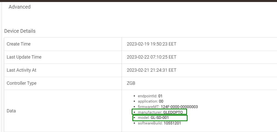

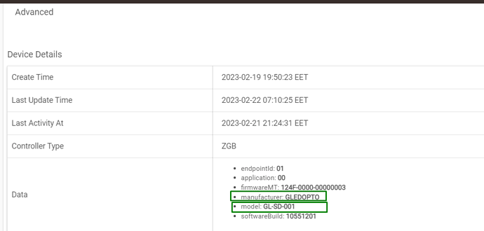

Can you check the devices web page in Hubitat Device Details 'Data' section? There should be a model and manufacturer value for every sensor. The data should look like this:
Does any of the 6 sensors have a filled in manufacturer and model values?
