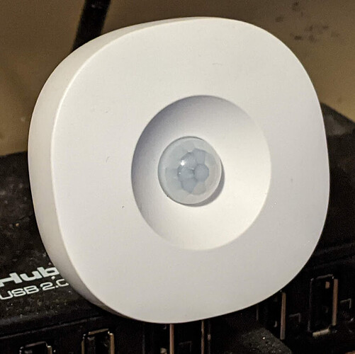

I lost track of the SmartThings Motion Sensor generations. I think Samsung did too. If you have this one (see photos), I believe the correct driver is the Generic Zigbee Motion Sensor.
