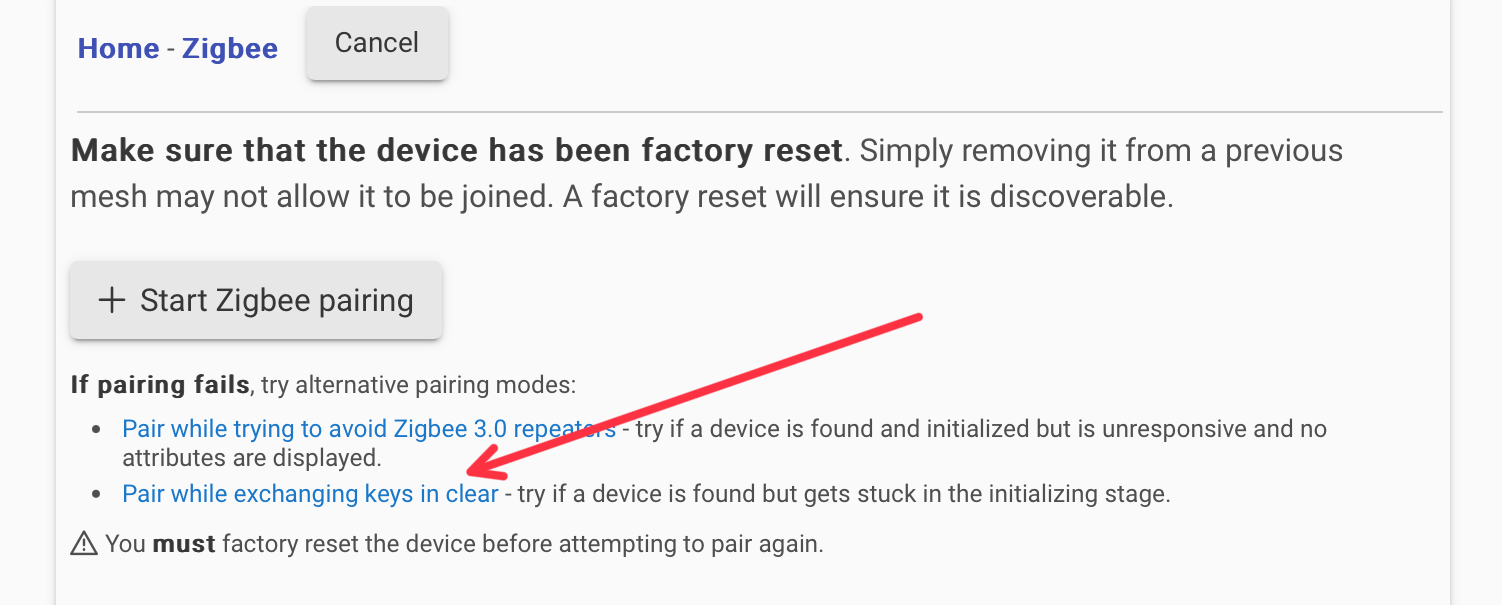

On the C-8 Pro, there are a few other pairing options for Zigbee. The Zigbee 3.0 repeater one wouldn’t apply in this case, but if you are pairing the outlet close to the hub and « normal » pairing still isn’t working, I would try the « Pair while exchanging keys in clear » to see if it makes a difference.
Thanks, Sebastian. I’ve tried pairing the outlet from 2 inches away to about 5 feet away and everything in between. I’ll look up how to pair it while exchanging keys in clear.
Just need to click here:

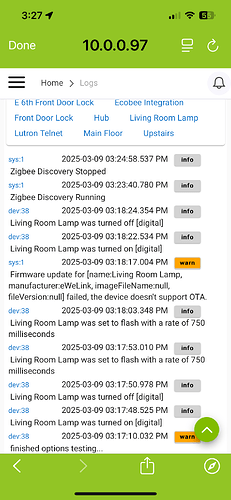

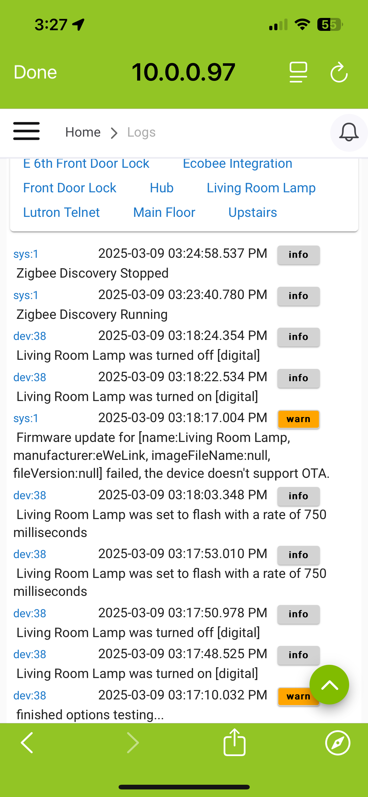

Thank you! I tried pairing a different Zigbee outlet and the hub found it immediately, and I can control it remotely. The hub is using Zigbee channel 23 (I also did a channel scan and 23 had nothing on it), and the Zigbee power setting is set to 8.

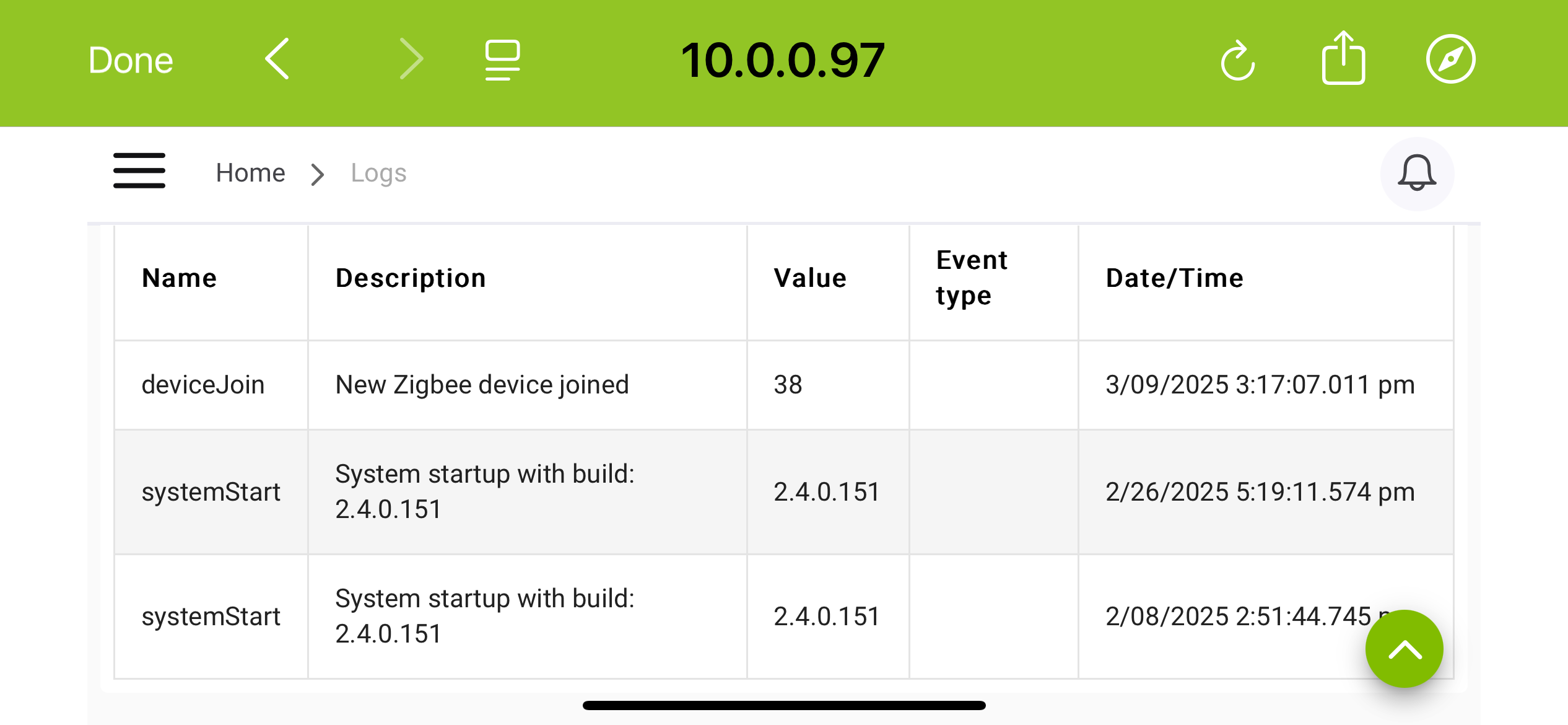

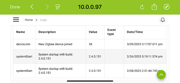

I went back and tried pairing the troublesome SmartThings outlet and here are the Hub Events and Logs pages from the app. You can see the other outlet I successfully paired at 3:17:07.011 pm in the Hub Events, and the unsuccessful pairing of the SmartThings outlet in the log following my turning the newly added Living Room Lamp outlet on and off to test it.
