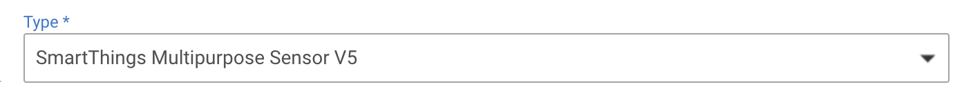

I'm using the V5 driver....

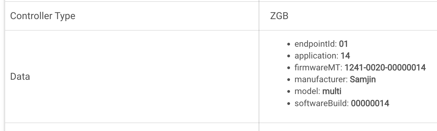

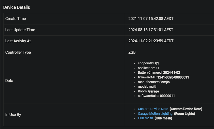

possibly a firmware version thing... it was mentioned some time ago for some performance or other issue I was not experiencing.... Maybe that's it.... (I don't have a ST hub, so can't, I believe, apply a FW update)
