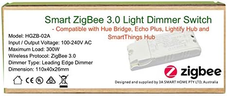

Smart ZigBee 3.0 Light Dimmer Switch HGZB-02A - changed title

You are right. I meant to order this one but accidentally ordered the other. I am cancelling that order if possible or will return it when it arrives and order the right one. It is only $0.50 more each.
Time for an update:
I ordered the two of the Smart ZigBee Light Dimmer Switches. I installed one in our master bedroom ceiling fan and one in the living room ceiling fan. The hardest part was to fit the module in the limited space available and get the cover over it.
Of course, the first is the hardest but It wires up simply. Line power goes to one terminal. Lights come of the next terminal, and neutral goes to the third terminal. In the case of the fan, I want to control lights but leave the fan operating by the chain as we very rarely change it anyway. I connected the source power black to the black of the fan and added a stub wire to connect to the dimmer. Likewise with the neutral wires. The new black and white wires went to the appropriate spaces in the dimmer and the blue light wire went to the center L1 connector.
I turned the switch on and the lights came on which is a very good sign. However, the test would be pairing with the Hubitat hub. I set the Hubitat to search for Zigbee devices and it was detected very quickly. I had to go in to the device settings though and change it from generic "device" to "generic zigbee dimmer" instead. I tested and it worked great. I programmed an Iris Smart Fob to act as a control since it has 4 buttons. Two control on and off and two control brightness. This is temporary until I get more smart buttons in to program for these functions.
The second went in easier after I had gained experience with the first. Likewise, it detected as "device." I changed it to "generic zigbee dimmer" and all is well.
These cost much less than some of the other options. I don't have fan control, but that is not problem. What is though is that I was not able to cancel the other order so I have two switches that I need to get returned. I may just hang on to them though as I have two small ceiling fans in the other two bedrooms that could use them, even if they don't dim.

Now that I have had two of these installed for a few days, I can say that I really like them with a couple of minor quibbles.
First the quibbles: They are rather large so a ceiling fan with a large cover is helpful to cover this device and its wiring. If you would like to install it to control a chandelier with a smaller cover plate, forget about it. It would have to go in the ceiling and then the wiring would be connecting outside a junction box. That does not work for electical code.
Now that I got that out of the way, this dimmer works great. It works with LED lights with no flickering. The good thing is that I can change out a bulb if one goes bad with another bulb capable of being dimmed at a lower cost than purchasing a smart bulb. ZigBee 3.0 appears to be very stable. I had tried a 4-button Sylvania Lightify Smart Switch which was causing problems with my ZigBee mesh and other items to appear to be there but be non-responsive until I removed the Sylvania devices and removed and re-paired the misbehaving devices. The dimmer switches kept working properly. These are the first ZigBee 3.0 devices I have. I will definitely look for more given this experience.
These also function as repeaters which means even more capability for my ZigBee mesh network. My conclusion is that these are a cost-effective way to add dimmer capability for lights at a reasonable cost. It would have been nice if they also included ceiling fan control capability, but in reality, that is not nearly as important to me right now.
