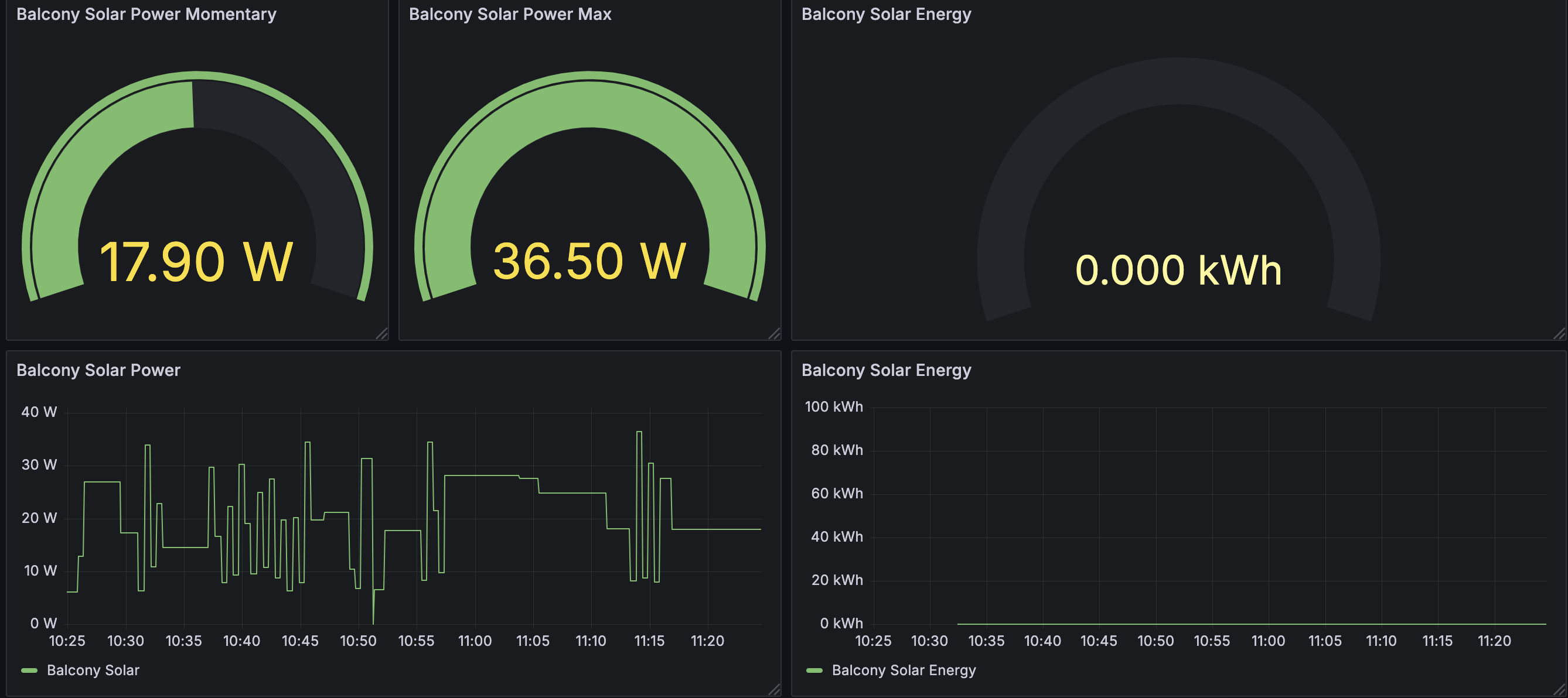

seems Shelly Qubino wave 1pm does the job. My panel is 320w so 16A on 230v is more than enough.
sending data via an influx logger I found in another chat, can now track generated energy.
