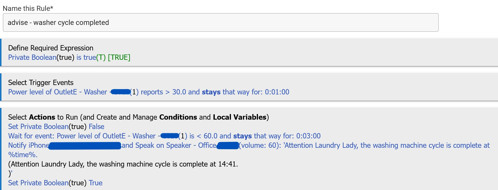

Not gonna claim any rule I script is as good as some of what the sharper tacks in this forum can come up with...but this worked after I figured out the timing & power thresholds that the washer goes through. The announcement in "Nicole's voice" is a real hit; tho she's suppose to be Australian it's reminiscent of the dryly obnoxious computer voice in BBC's Red Dwarf if I recall right.

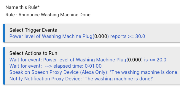

While there are apps, as above, here is a simple rule I wrote that works for my machine. You may need to adjust values depending on the power levels yours actually uses (this is small front-loader) as well as the the reporting settings on your outlet.
Wait for event: Power <= 20, Wait for event: elapsed time 1 minute, Speak/Notify "Washing Machine Done"
The rule in the post above is certainly another way you can handle this (and even mine could be written a bit differently given that the "duration" option could be used on that first wait instead of two waits in a row, but this rule pre-dates that feature and still works fine) ... so, lots of options. :smiley:
If you don't mind answering, what is the reason you have a private boolean requirement?
Hummm,
I may have applied a belt + suspenders approach having seen how the Priv Bool protects me from what I don't yet know will hurt me (as experienced in other cases/rules). Or I might have been testing and found that I ended up spawning multiple instances of the rule unintentionally with human intervention at the machine.
Probably not trusting a clean start & stop of the rule with a human lingering over a momentary button in the middle and the rule-end being highly dependent on a new device's measured wattage levels that I had not fully worked out yet.
Now you've got me thinking how/if this might be detrimental. :thinking:
