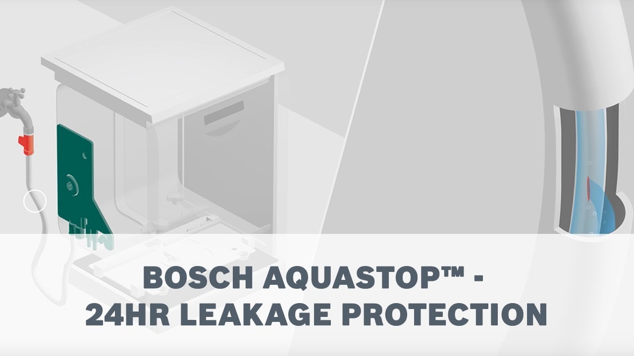

The Bosch dishwasher is sealed and has built in leak detection. If a leak is detected it shuts itself down. The OP stated they were buying Bosch.
True, but the sophistication of the action taken depends on series. Mine will be 500.
Curious what is meant by “sealed”. All dishwashers are sealed. So you mean to say that supply and drain connections are in a sealed space?
I would still have a leak sensor underneath. Belt and suspenders.
It's not too clear in this video but the guts of the dishwashers with that feature are mounted on top of a plastic or composite base (almost like a tray) that covers the footprint of the machine; it actually would prevent you from sliding a leak detector underneath) Supposedly any leakage would be caught by the tray and the sensor would cut off the water supply and pump out the contained water.
Not sure if all Bosch models have this but it was on the 800 series machine I got in 2018; we usually run it fully loaded and it always does a great job. Very quiet as well.. not really a fan of the capacitive touch controls but they're supposed to be more reliable.
Mine is a 300 series and has this feature. We wanted the 800 series but needed an oddball in today's market (24" white) so had to settle for the 300. The 300 works so well I can't imagine how much better the 500 and 800 series are.
Yes there is a plastic tub on the bottom. The supply line is extremely heavy duty and looks to be hardened for leaks and has what I believe to be a valve type assembly on the supply end of it. I had to cut a large hole to get it through the side of the cabinet and then needed to build a small shelf at the back of the sink cabinet for it to sit on. There are adjustments for height but I don't remember how much room is underneath the unit. I do remember it took 5 months to get (from Poland) during the height of the pandemic. It was quite a bit different from the GEs and Whirlpools that we have had in the past.
