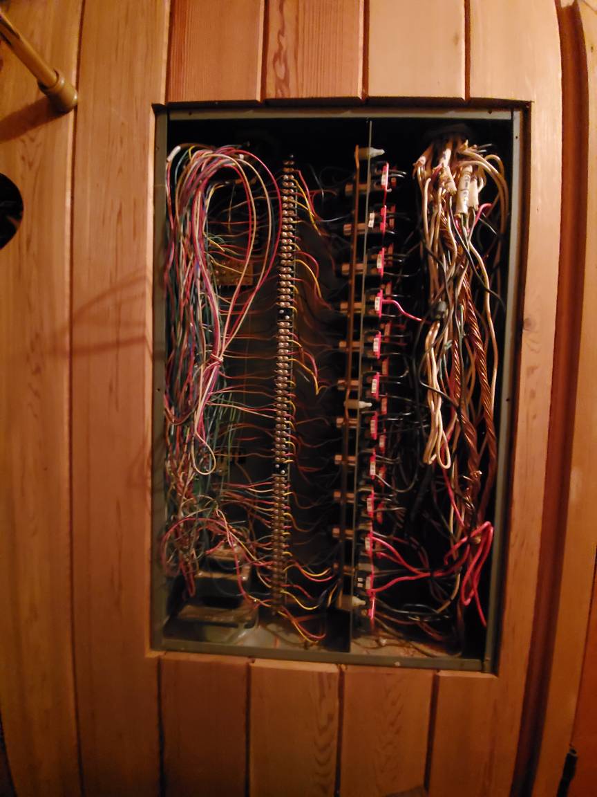

The switch boxes each have a momentary rocker that switches an 18VAC feed line to the input poles of a 120VAC mechanical relay located elsewhere. Depending on which pole of the relay is activated, the relay latches into the "on" or "off" mode. The latching feature prevents the relay from always reverting to the "off" mode during a power outage. The individual relays are contained in an electrical box which also houses a total of 24 of these relays that control lighting circuits throughout the house.
Supposedly, it was the latest and greatest lighting technology of the mid-1970s. I'm just happy that the relays are heavy-duty industrial quality and are still going strong after nearly 45 years, as finding replacements would not be easy.

Indeed, and I have 60 of those relays to contend with
The panels are mostly jumbled bundles of romex, in addition to all the 18V wires, though someone thought enough to label each relay and remote switch so they are a little easier to sort through.
Yeah, those are nice, and I've looked at them... the problem becomes where to put them so they are easily accessible, meet code, and don't look ugly hanging off a wall. Fishing wires through the walls is a nightmare because the builder decided to insulate all the interior walls, and instead of drywall on studs, all the walls are plywood over studs, then covered with 3/4" thick tongue and groove paneling.
I would have guessed that all of your existing 45 year old relays are already inside a large panel. If so, I was envisioning simply rewiring that panel, re-using all of the existing wiring.
I am sure everyone would love to see some pictures of this 1970's high-end lighting solution. That might really help to spark some ideas!

That is what I was thinking too. You shouldn't have to change anything except the relay for the new smart device. Remove the dumb relay and put in the smart one in the same housing/cabinet.
The push button in the wall should be able to be the input to something like those dimmer modules linked above. They take 8-230V input, so 18v is perfect.
That panel of switches does resemble what I'm dealing with, though mine is rather less neat in appearance, even with only 24 relays per box.
The space in the existing boxes is pretty well taken up, so it would be far easier to add a new box alongside and put the smart modules in that. I'll still need to pull some wires if I go that route, but it tends to be a little easier when simply adding to an existing circuit path up into the attic.
Sorry for taking so long to get this posted, but I just have too many other projects to juggle, and this one was shelved for a bit. Anyway, here's a photo of one of my relay boxes.
This one contains 24 relays and has dimensions of 18" X 24" x 4". I have another just like it, plus a 12-relay box as well. Of the 60 relay branches, there are about 5 that are a mystery. They don't seem to affect any lighting circuits, nor do I find any outlets that are switched by them.
