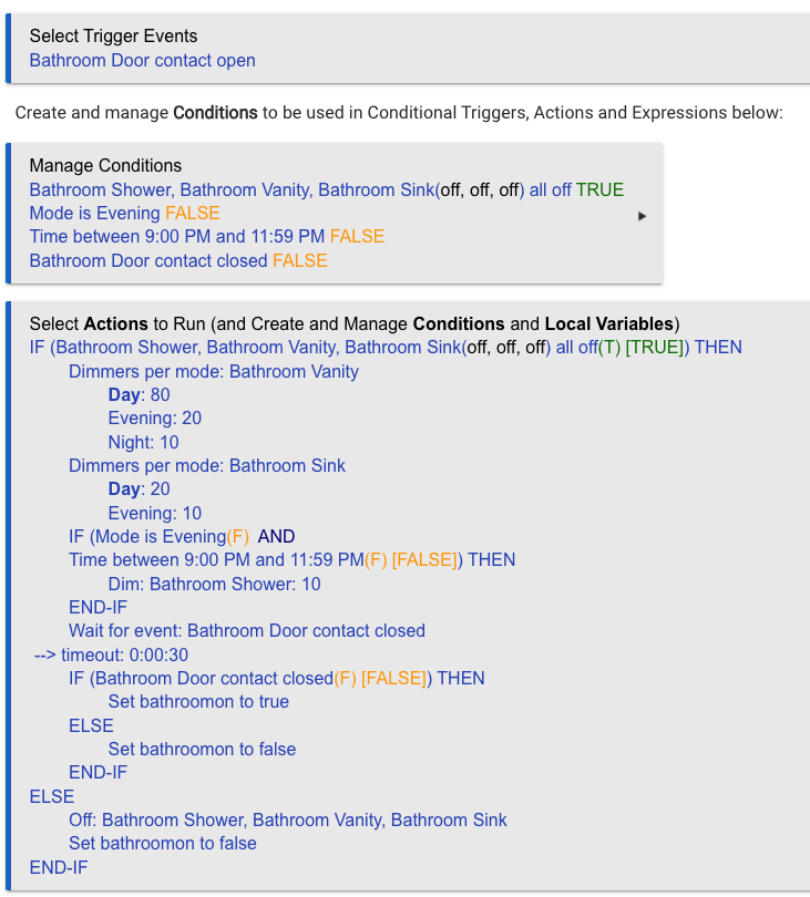

  1. Contact opening

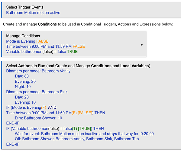

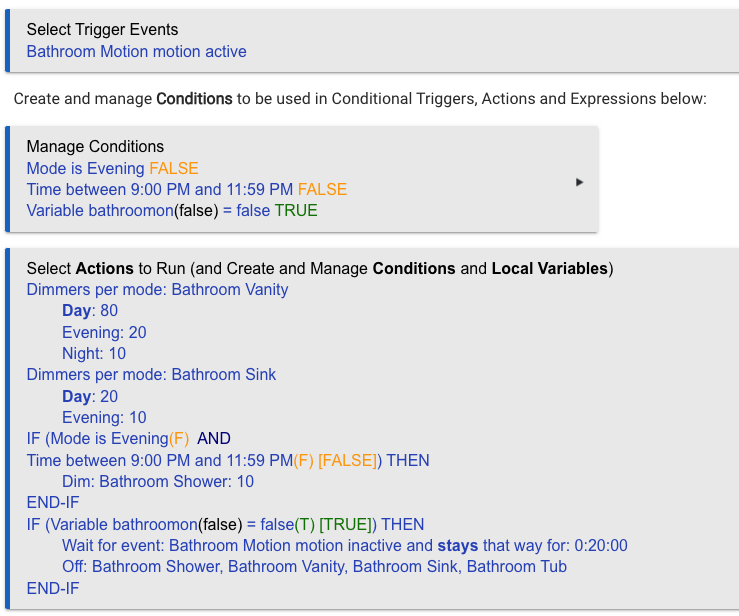

  2. Motion opening

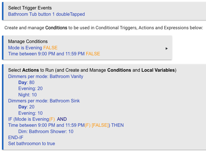

  3. Manual click on

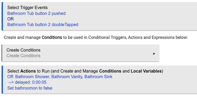

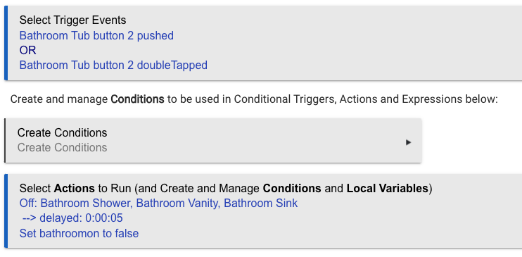

  4. Manual click off
