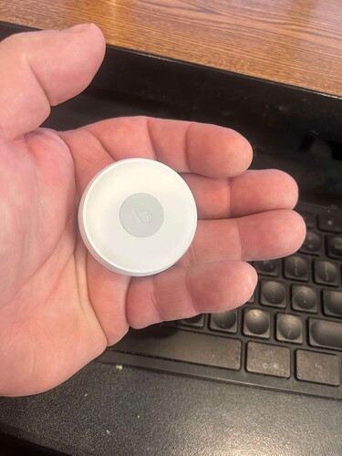

They are quite small
Here it is compared to the standard Neo Coolcam/Tuya sensor (which also works great and can even use a rope probe) Although these are 19 bux vs 6. The advantage of the Neo Coolcam/Tuya is the external 3 foot probes they come with.
Batteries seem pretty good on these. Can't say they will last that long, but they're loud and they send messages to my phone...
