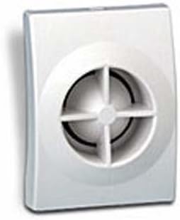

If it has in the preferences the low trigger option problably you need a relay connected to konnected and your siren to the relay and a power supply, what is the voltage required for the siren, 12 volts? The only small siren I seen work without a relay is this
20190309_143041-473x477

Take a look now, but it is just a buzzer

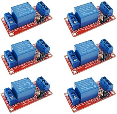

Lol, it's 12v, use this connected to konnected:
And a 12v power supply
