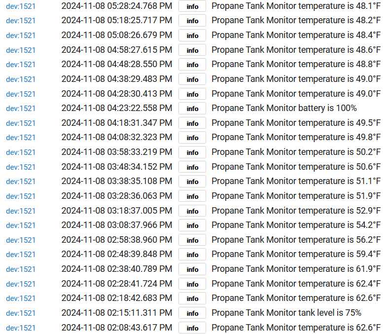

I'm having good luck with it. I've been down on zigbee, and this is the only zigbee device I have. Batteries going strong. Good range-better than most, I'd say. Working well on my 1000 gal propane tank. I've got it set to send the temp every 10 minutes, just to know it's alive, lol. Here's a recent snip. I use it for a generator. It's been at 75% since day one. I try to conserve during power outages. Didn't you have a fitment problem with remote-ready sensor, or am I confusing you with someone else?

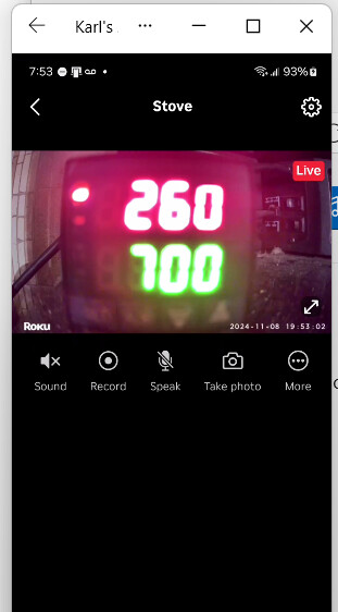

edit: I remember now! You're the guy with thermocouple setup on a wood stove. Here's my current 'solution', lol:

Nice setup. Is that a pid controller?
Yes. I never did get it, or a similar one, hooked up to Hubitat via the Smart Implant as you did. It turns on fan when it gets to 200, and turns it up to high at 700. That's it.

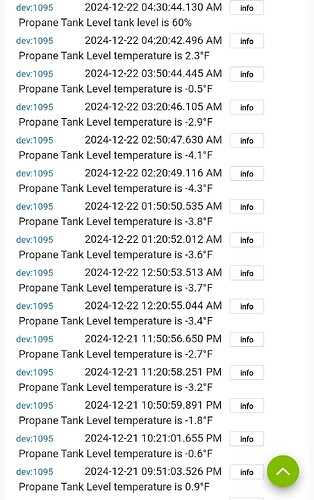

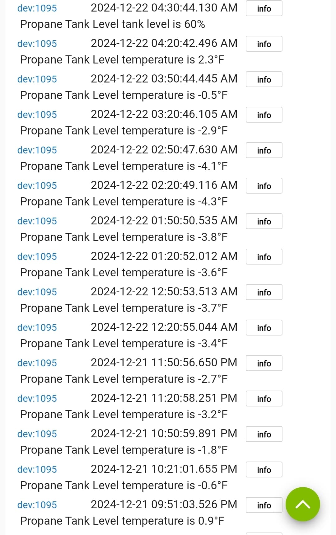

I've been running the Sinope sensor for a few weeks now and it has been reporting temperature reliably every 30 minutes as I requested in its settings. It also has been reporting tank pressure once a day, likely because my tank has not changed from 60 percent since I connected the Sinope.
However, I have not seen any updates in 24 hours. The last update was right before the outside temps dropped from 16degF to around 0degF. Are these sensors bad in the cold?
I'm using the supplied Enerzizer lithium AA batteries. I have the same batteries in other outdoor (Ecowitt) sensors and they are working fine.
I didn't have any problems last winter. It usually gets to 0F a few times a winter where I live.

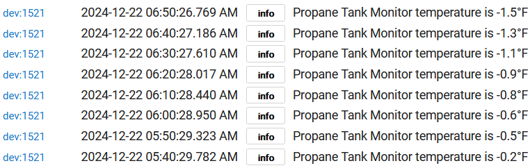

I'm still getting the 10 minute temp readings I set it at.

If I hit "Refresh" on the Device page, the live log changes.

No idea why the battery is still at 100% though, lol.

Mine too. 100 battery after almost a year. I'm guessing it does not report battery correctly and one day will just stop working.
