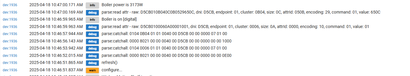

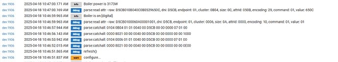

Just added a Sinope Load Controller RM3250ZB to my HE and it will not send the power attribute unless I command a refresh. I have to wonder if the newly implemented 2.4.1.151 wattage setting is not working correctly and mine is set on 5000 watts or something which I don't reach. @mike.maxwell @gopher.ny
Maybe something I am missing?
When I go to configure it with debug on there is no indication that anything has been written to the device, just catchalls followed by the refresh.

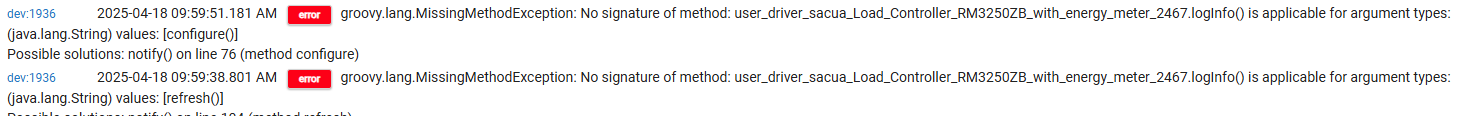

Yep, tried that and I get errors from the code...It wouldn't configure or refresh, strange
This is the one I tried...
Hmm now that I am looking at that driver again, do I need to install some sort of Library first?

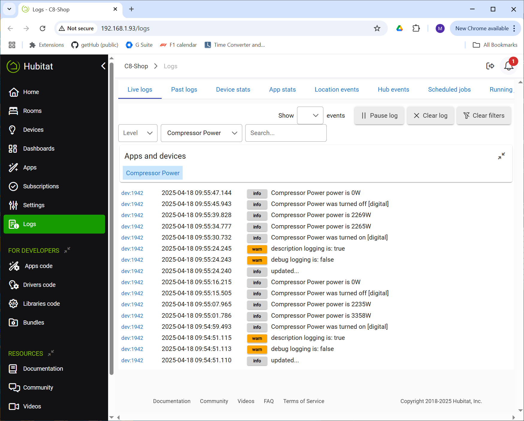

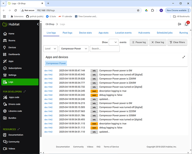

I just tested mine using the following settings, first 1000 watts, then 100, which produced the following logs:
Being an older driver the power reporting configuration acknowledgment isn't currently logged.
You do need to pick a power threshold that your device that's being monitored will exceed...
Also, saving the preference setting is all that's needed to update the threshold, there is no need to click configure.
Configure will actually turn the reporting off...
