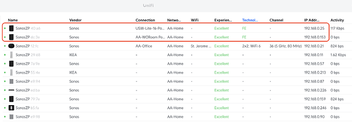

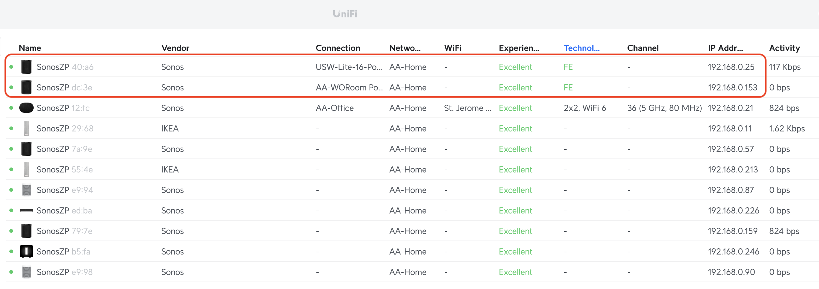

I have about 10 Sonos speakers, listed below. Focus on the Sonos speakers boxed in red. They have IP addresses of 192.168.0.25 and 192.168.0.153.

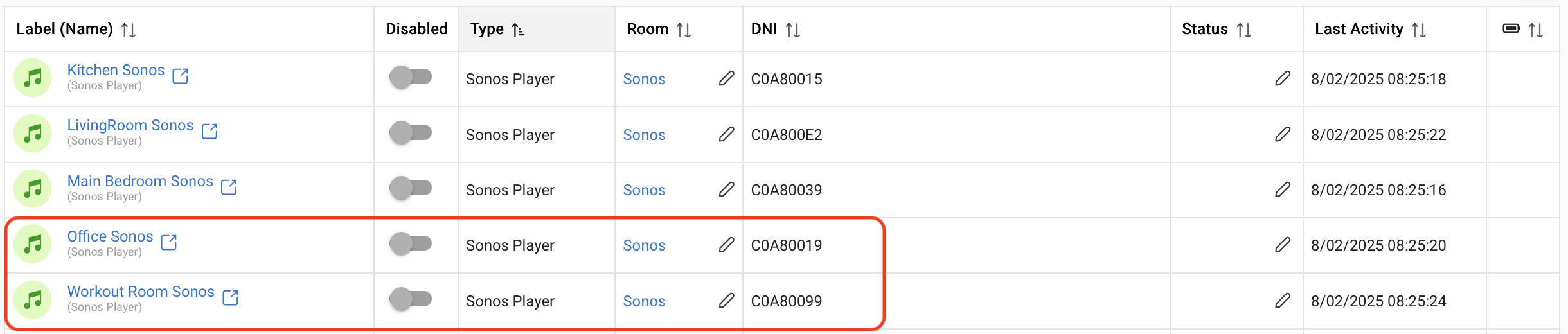

These Sonos speakers correspond to the Sonos players for my Office and Workout Room, boxed below:
Focus on the DNI for these players (DNI = Device network ID).
  1. The Office Sonos has a DNI of C0A80019. This is the hexadecimal version of the IP address 192.168.0.25.
  2. The Workout Room Sonos has a DNI of C0A80099. This is the hexadecimal version of the IP address 192.168.0.153.

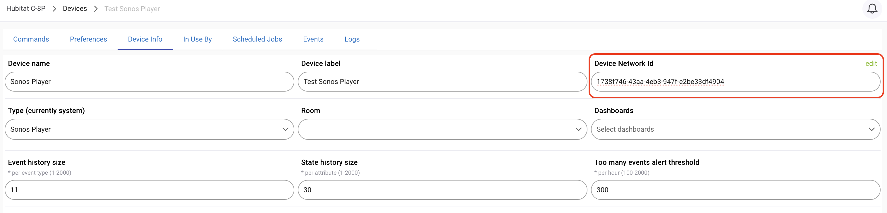

  2. Go into the Sonos Player, and edit the device network ID (see below)

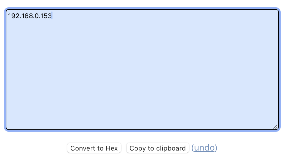

  3. Enter the IP address in hexadecimal and save it. Here's a helpful site that will convert IP addresses to hexadecimal for you.

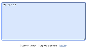

  4. For example, if I enter 192.168.0.153 (see below):

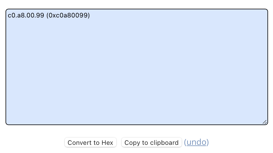

  5. And then click "Convert to Hex", the output is:
  6. Omit the leading "0x" and use the rest as the DNI.
That's it - you now have a Hubitat device that will control the Sonos corresponding to that IP address.
