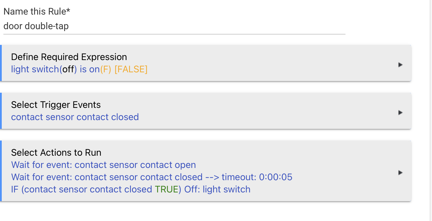

Try this... I think it comes close to doing what you want. I managed to do it with a lot less aggravation than I anticipated!
If I'm following this correctly, it might now work. Because the timeout would just result in the rule executing after 5 seconds, even if the door wasn't re-opened or closed. But I think i'm getting the idea. I think I'm close to a solution. Will share once it's working...

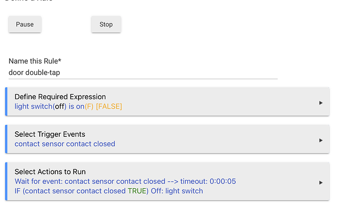

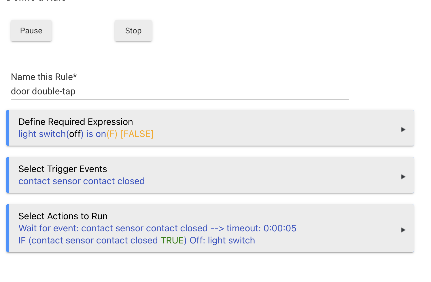

Nevermind. Flaw in my logic. Gimme a few.
I think this one should work better. The required expression means the rule will only run if the light is already on. If it is on, and the door closes, the rule is triggered. It will then wait for another open indefinitely. Once the open comes, it waits either for the contact sensor to be closed or the 5 second timer to time out. The last conditional makes sure the door really did close within that 5 seconds, and if it did, it shuts off the light.

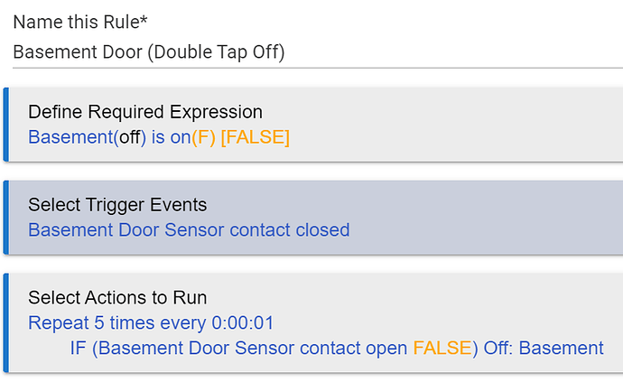

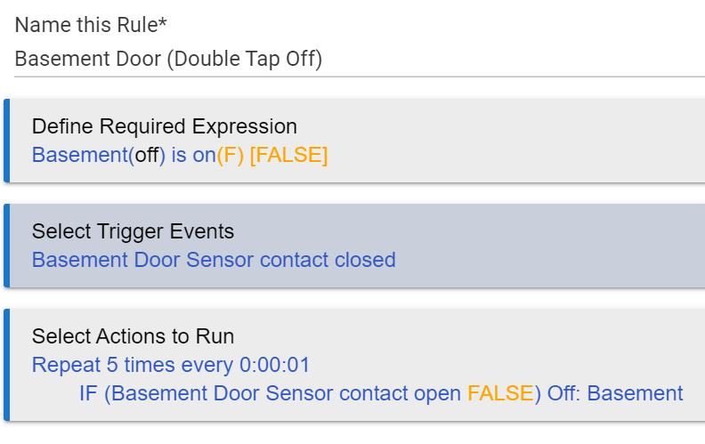

OK thanks everybody for the feedback. Here's the winner. Looks like I just placed an if condition to check to see if the door has opened in a loop that repeats every second, 5 times. Pretty proud of myself for a n00b.
