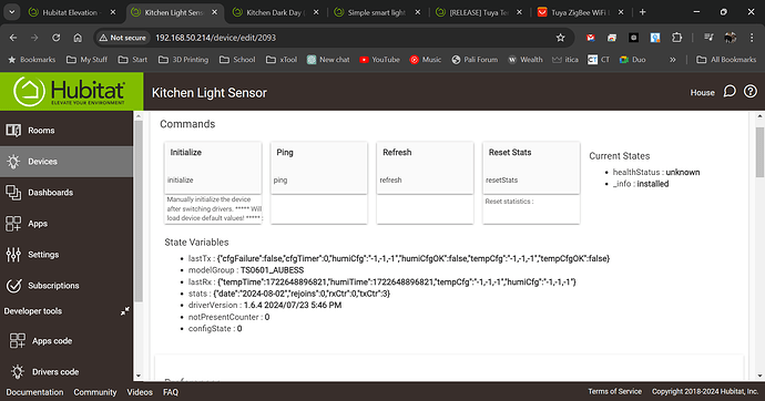

Hello @kkossev I am sorry if i am bothering you. I bought the light sensor you listed above on Amazon Canada, found this thread and a couple of others that you posted a driver for and i installed it and as @Pradeep suggested to set it to TS0601_AUBESS and he got his working, but min is not. I did match the driver to HPM and it is updated to the August 24 version, but its not sending any lux info to my apps
it also constantly blinks the blue light even though my C8 Pro has found it, is tha normal?
Thanks for your time and an help you can provide
You have not paired the sensor successfully.
Try the Double luck workaround.
Ok that seems to have done the trick. it took 5 tries of the 'double tap' method it didn't work from 2 feet away but when i put it within 2 inches it seemed to take right away. Each time it had to select the TS0601_AUBESS to see any change's in the device descriptions. But in the end your magic worked and every seems as it should be. Thank you very much for your help, time and efforts and very fast reply :grinning:

TS0601 _TZE200_khx7nnka fingerprint is actually not included in the Tuya driver, selecting the “TS0601_AUBESS” in the “Model Group” is a workaround / random match of the data points with another device.
