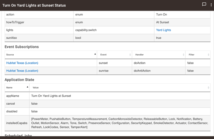

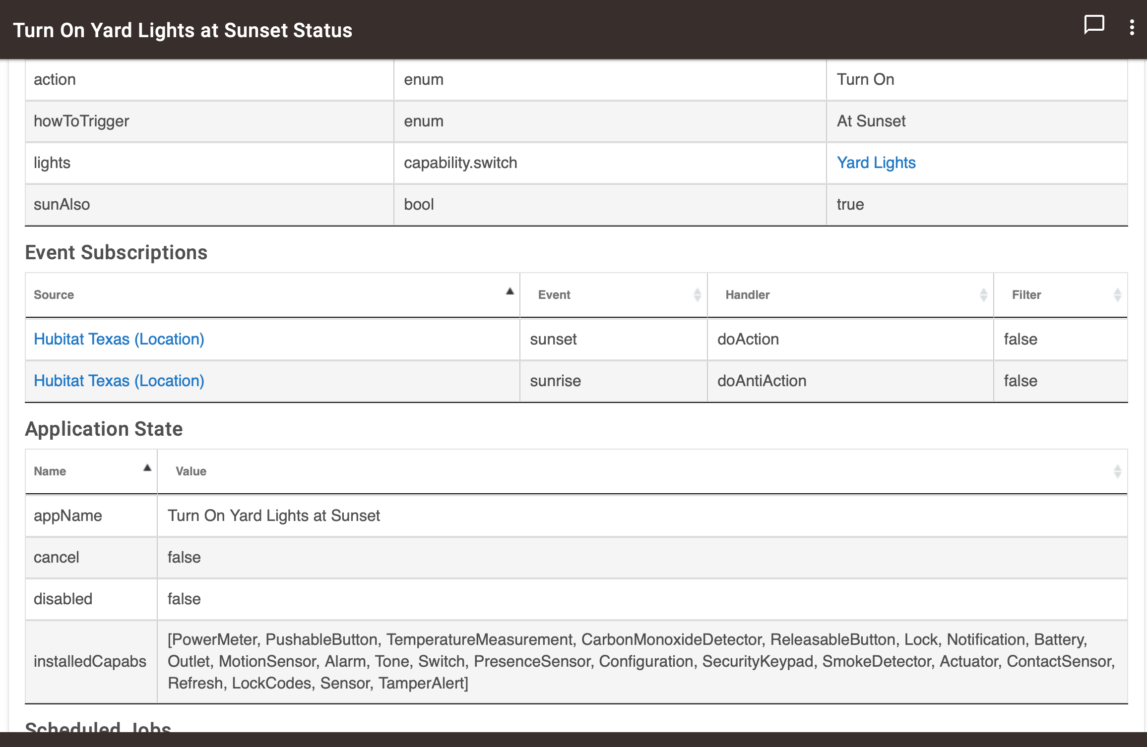

@Dustyd5 There are not supposed to be any Scheduled Jobs for this. It subscribes to the hub's Sunset event, and you can see that in the details posted above. This fires when the hub sends that event. Look at your System Events log to see if Sunset is firing as you expect. Check your timezone setting under Location also, and possibly hit Update there.

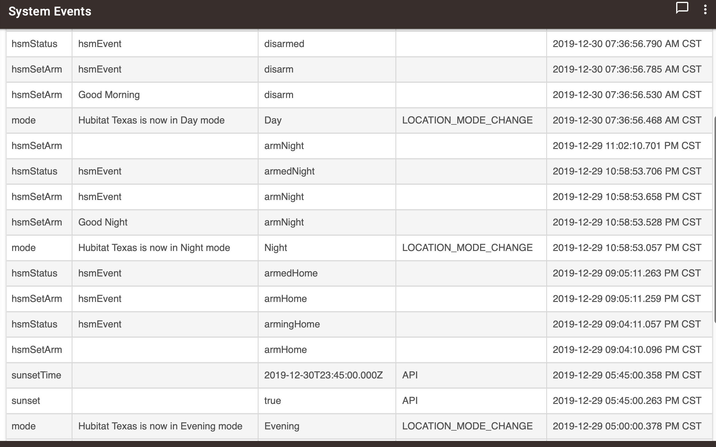

System events:
|sunsetTime||2019-12-29T23:45:00.000Z|API|2019-12-28 05:44:00.121 PM CST|
|sunset||true|API|2019-12-28 05:44:00.084 PM CST|
There are no system events for sunrise, which has come and gone... it was supposed to fire at 7:28 and it's now 7:43. I've hit that update button before. Will try it again.

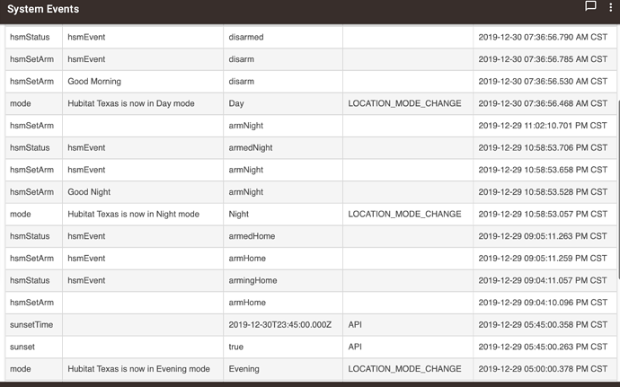

Please post a screenshot (not copy paste) of the System Events page.
Screenshot: (Sunrise was at 7:29. Nothing happened, as you can see...
Yeah, that's a problem...

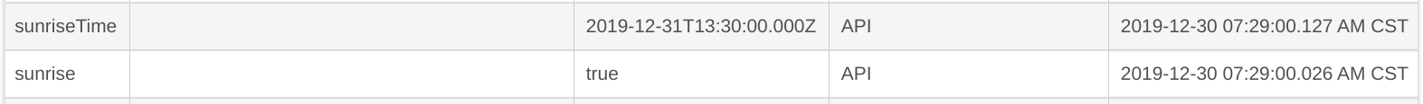

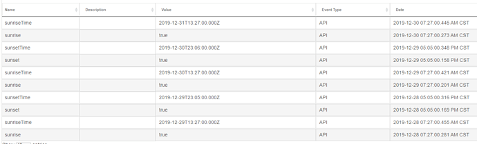

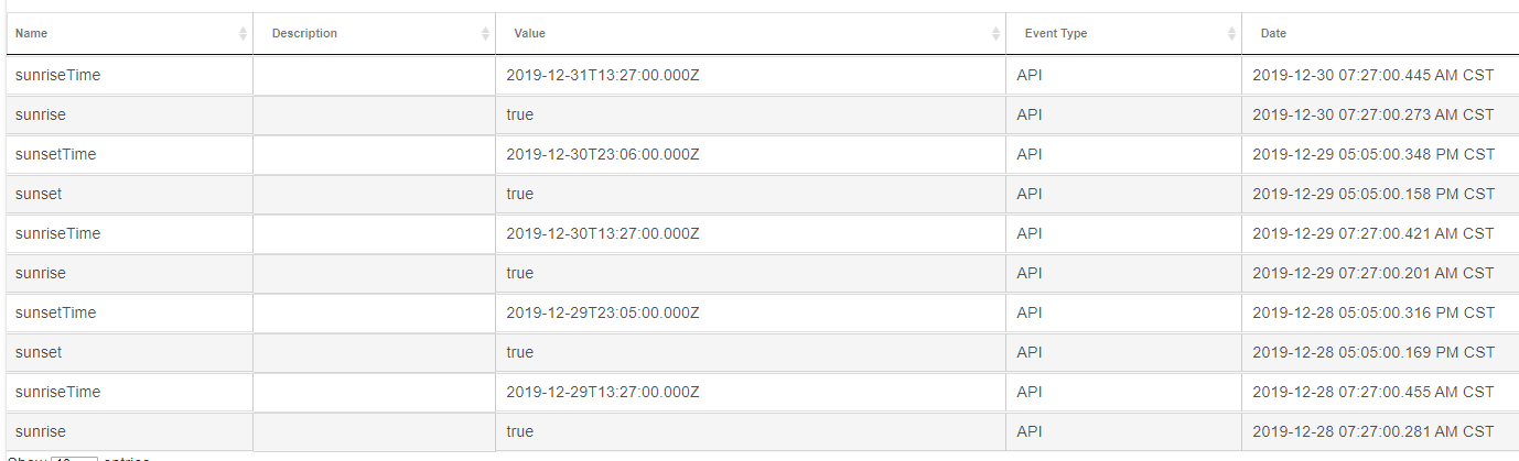

Side note, we must be in a similar longitude, sunrise=7:29am here too:
My sr-ss events have always worked fine. I'm in a similar geo area.
