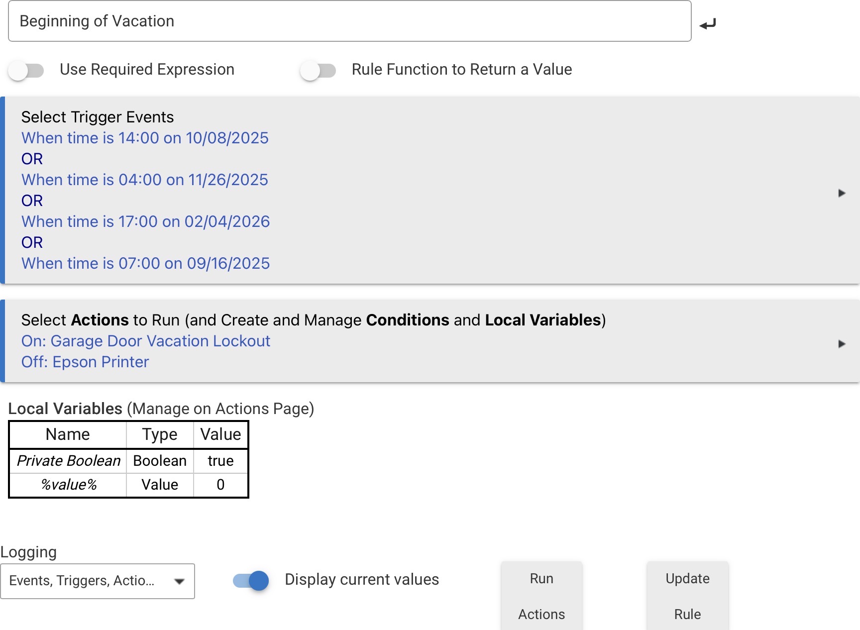

The goal was to allow me to enter multiple dates+times for the beginning of my vacations - and at that date+time, do some things (turn some things on, turn some off, etc). Rule machine seemed the way to go - though I’d be open to other ways of accomplishing what I’m looking to do if it was better than RM.
I created the rule a few days ago - and when I got to my hotel this afternoon, i took a look and neither of the devices changed state, and i can’t see any reference to the rule running at all.
Here’s a screenshot of the rule. Am i doing something silly? How can i fix this? Thanks!
What do Past Logs, filtered to just this rule (app ID) show?'
Did you hit Done after creating the triggers, or any time since then?
I thought i did - but maybe that was the issue. I just pulled up the logs - and although i see the trigger when i go to look at the rule - the logs don’t seem to show the last entry i added for 9/16
[app:755] info Initialized
[app:755] info Scheduled: 18:00 on 03/08/2026
[app:755] info Scheduled: 21:00 on 11/29/2025
[app:755] info Scheduled: 15:00 on 10/21/2025
And when i just hit done - i got an error that the 9/16 date occurred in the past.
Like i said - silly :slight_smile: I think I’m all set. Thanks @bertabcd1234 !
