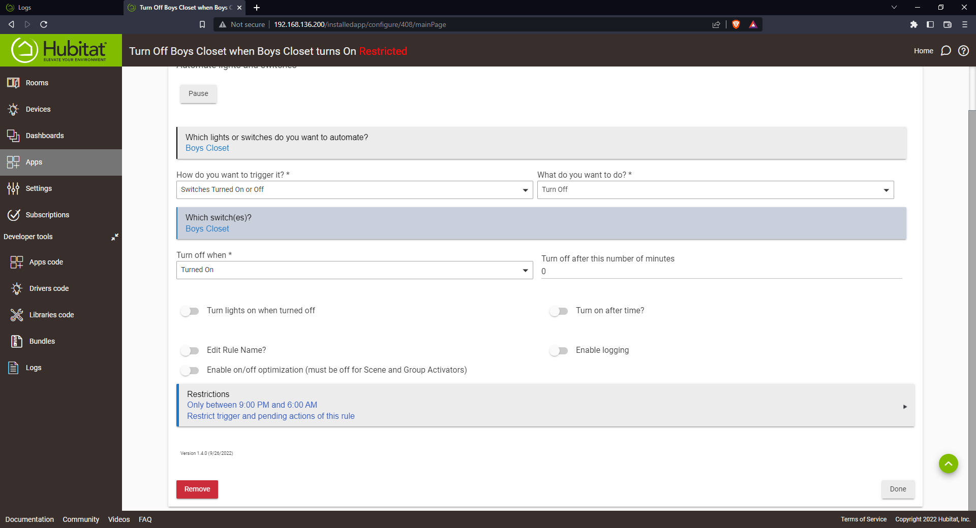

Made a rule to keep my son's closet light off at night. Its a sengled smart bulb intended to function as a regular light bulb with dumb switch, except at night, when the hub senses it come online, it should turn it off at the bulb, causing it to flash on when power is restored, then turn off about a half a second later.
This works, but the first time every day that it is turned on outside of the rules hours, it also turns itself off. Today that was at 11, well outside of the 6AM end time for the rule.

I will try deleting and recreating the rule. Of note: I tried to replicate the issue by changing the exclude times, but it seems that changing the exclude times around the current time (as opposed to the current time naturally moving out of the exclude time) does not cause the issue. Also of note, I noticed in the device settings that under "in use by" was a half created rule with no trigger that I accidently made. I deleted that. Maybe that will fix it.
