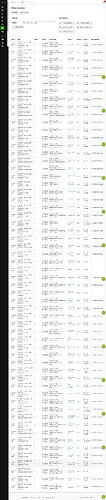

Here is the refreshed ZWave Details Page.
Here is the TOPO

The RTT values are not populated on the details. Did you wait a few seconds and then refresh the page after clicking the refresh stats button?

Yes, must not have waiting long enough or something, the RTT values should update with values and the Route Changes should not be all 0. Some might be 0 but there is no way they are all 0.
This does have the new Aeotec Extender added outside about 60 feet from the back buildings. I don't know if it will help, but the next triggers are at 6:45 AM tomorrow.
So mostly looks good, a few devices to keep on eye on. Instead of listing them all they are easy to find. You look for anything with a high RTT (over 100ms), and you look for higher outliers on route changes. Every route change the device sends out tons of discovery packets and it can disrupt things for a few seconds. Some of your further devices might be re-routing every time they communicate with the hub.
If you make adjustments reboot the hub, the stats will reset that way. So if you have not rebooted since adding the extender it might not be a bad idea.
