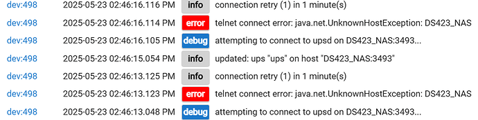

UGH. I'm still pulling my hair out trying to get this APC UPS, connected to the Synology NAS to work w/ my C-7 hub.
Can't get the NUT UPS Monitor device to connect to the NAS.
I've read all the posts here I can, and here's a screen capture of the log.

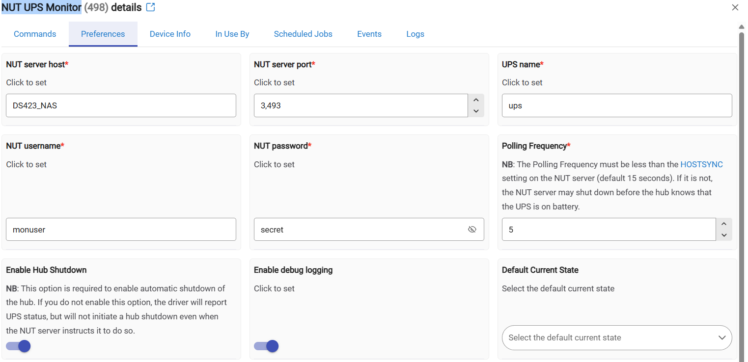

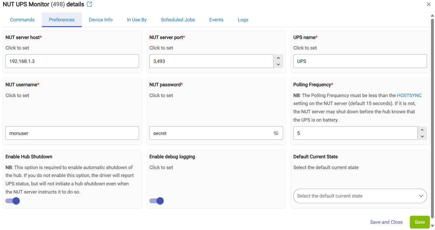

Here's the device Preferances settings

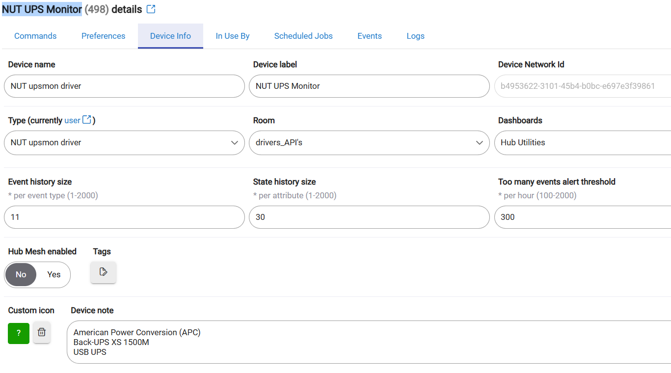

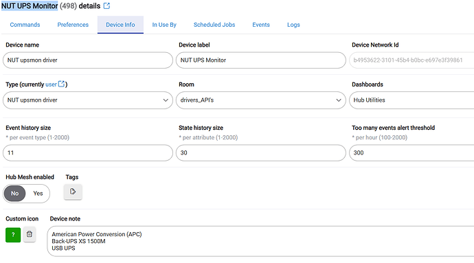

and the device info screen

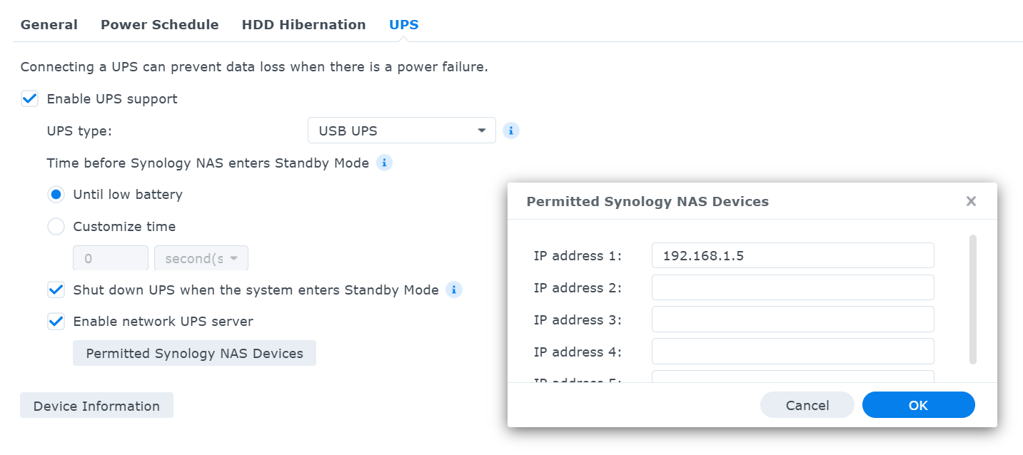

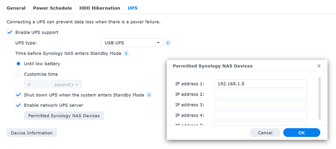

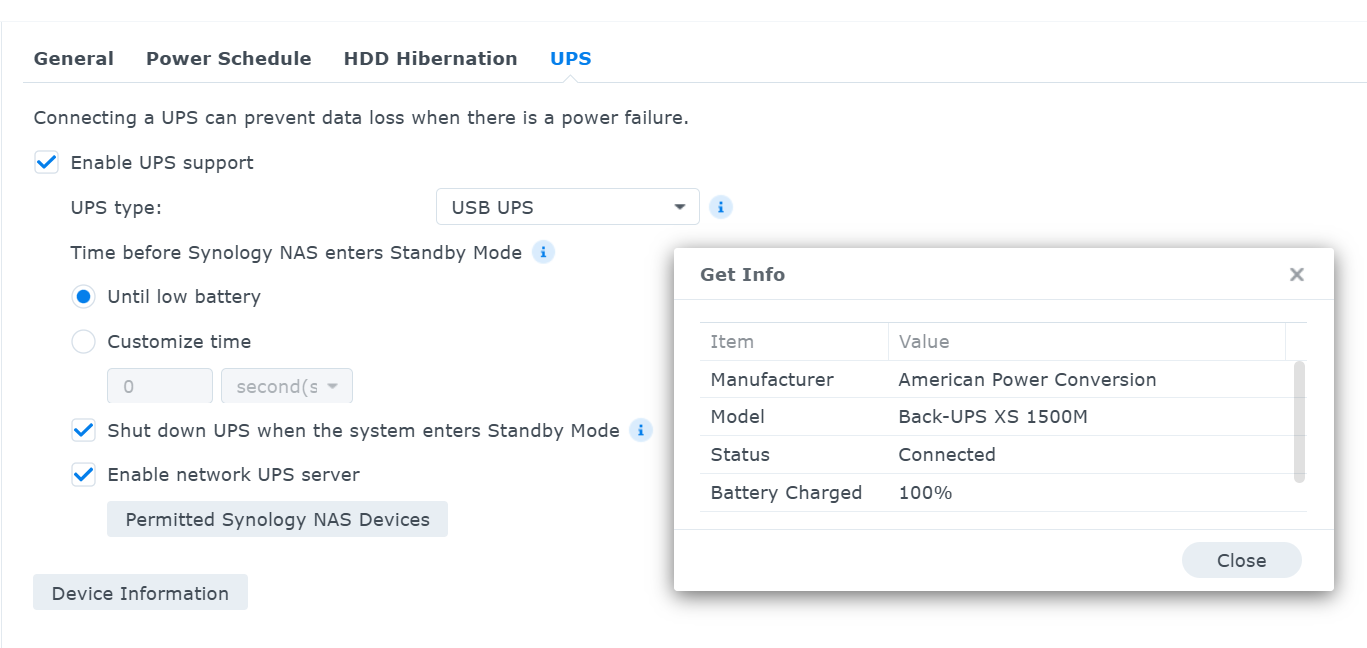

And the NAS screen
My Hubitat C-7 has a static IP address set, and it's in the DSM config page.
I've verified the NAS port address is the same as that in the UPS Monitor driver.
Any help is appreciated.
TIA.

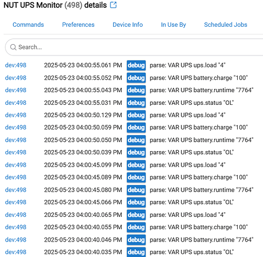

DUH! I think the light bulb went off for this Synology/APC UPS setup
The "NUT server host" should be the IP address of the NAS, NOT the NAS name.....
UPS name field is fixed at "UPS" NOT the Synology name
NUT username field is fixed at "monuser"
NUT password field is fixed at "secret"
After changing all this, the logs change to:
I then changed the polling period from 5 sec to 60 sec, but the max goes to 30 sec.
There is a good reason for this. :slight_smile:
See the note on Polling Frequency in the UI. HOSTSYNC on the Synology is fixed at 15 seconds and the hub's polling interval needs to be less than that value. Polling is not an expensive operation.
Thank you. I'll change it to 10 sec then. I didnt want to overload anything.
