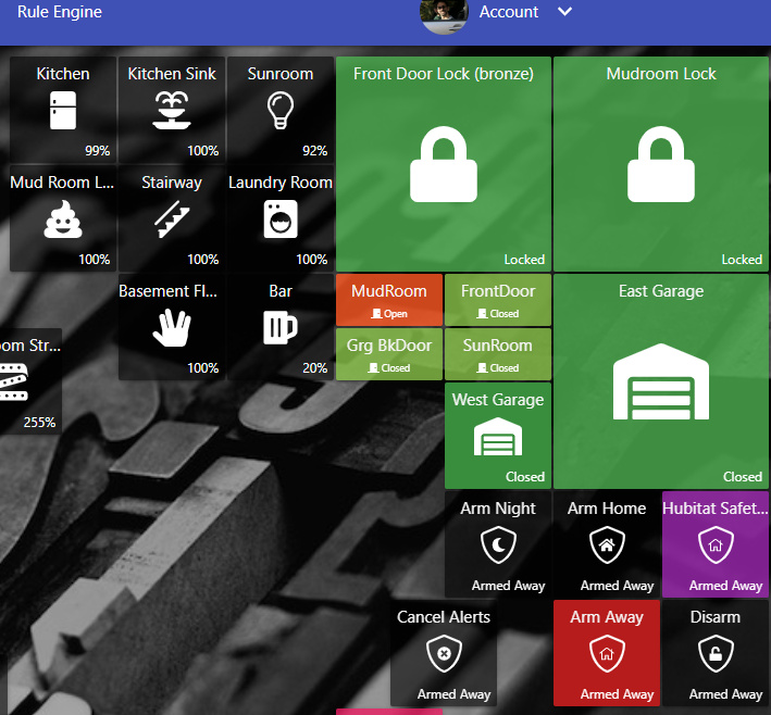

Nice Dashboard. How did you get the sizes of the tiles to be different? The "..." settings only allow you to make a tile bigger/smaller in increments of the original size.

I can't be sure how @cj_rezz did it on his dashboard, but all I did was to set the starting width setting for tiles to be relatively small, say 20-30, set within the dashboard config. When setting the width of an individual tile, I often set them to be 15-20 increments wide, sometimes more. Basically the smaller starting width of 20-30 compared to say 80, gives you more fine-grained control.
Yup, exactly. Here's my settings for that particular dashboard
So a normal tile will end up being 2 units tall and 2 units wide so that then you can have smaller tiles.
