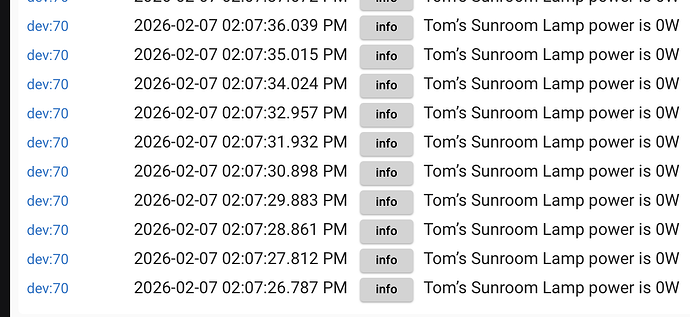

Should Shelly Gen4 plug report power EVERY second?
Paired Shelly Gen4 plug over matter using generic matter outlet on C8pro.

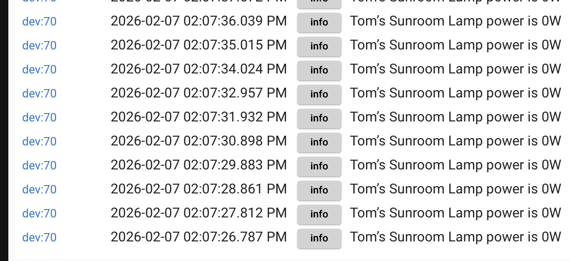

Logs show power report arriving once per second.
Isn’t that a bit extreme ? Cannot find any place to control it in Shelly App.

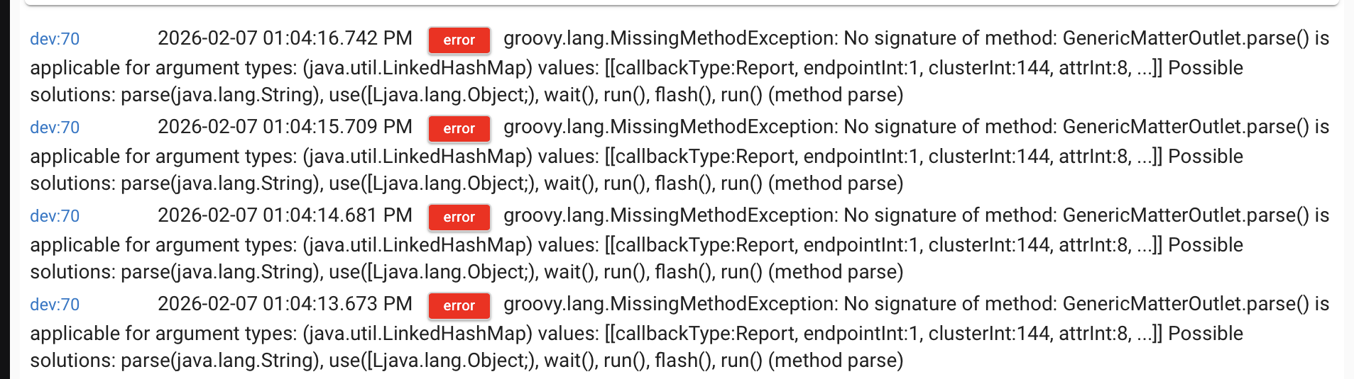

Repaired using Matter Advanced Bridge. Reports stopped, but now no power values at all.

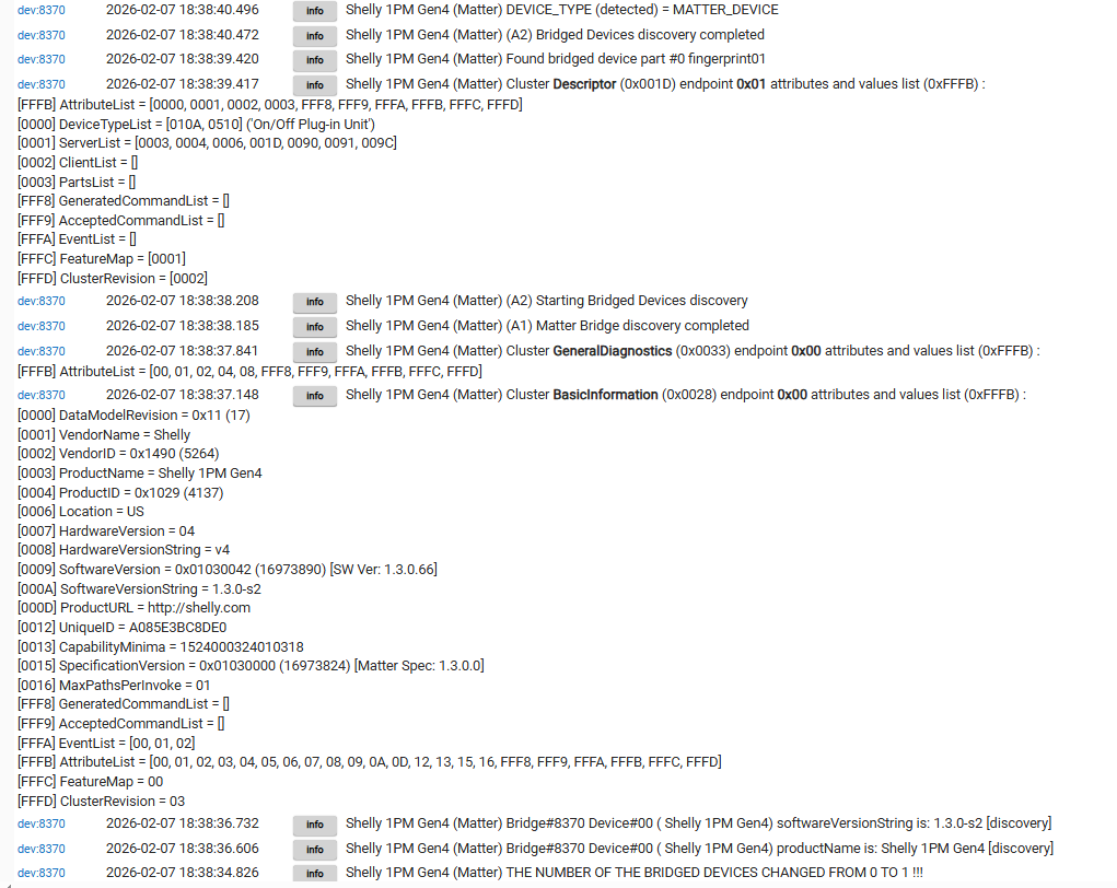

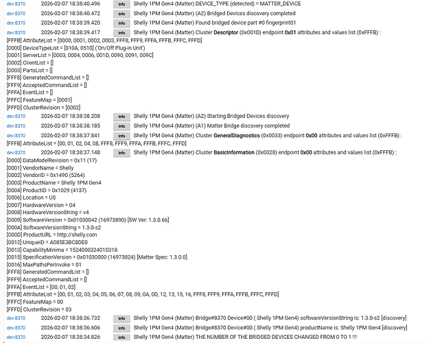

Do you see any error logs?

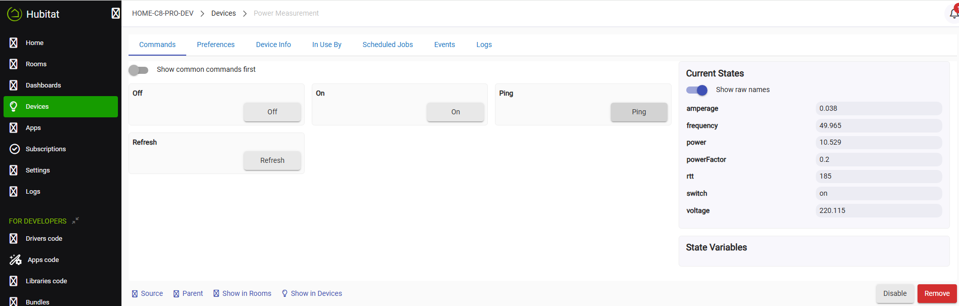

My Shelly 1PM Gen4 seems to be working OK via Matter:
These are the logs during the discovery :
Summary

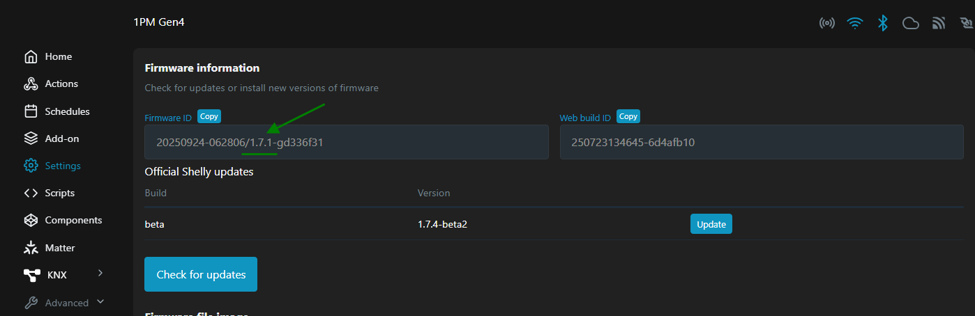

Make sure you are on the latest official firmware - it is version 1.7.1 at the moment :
I have a static load (a LED bulb), but there are no extensive reports when the load does not change.
No errors, Shelly app says firmware is latest.
Which driver are you using?
The screenshots were from the Matter Advanced Bridge.

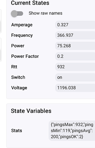

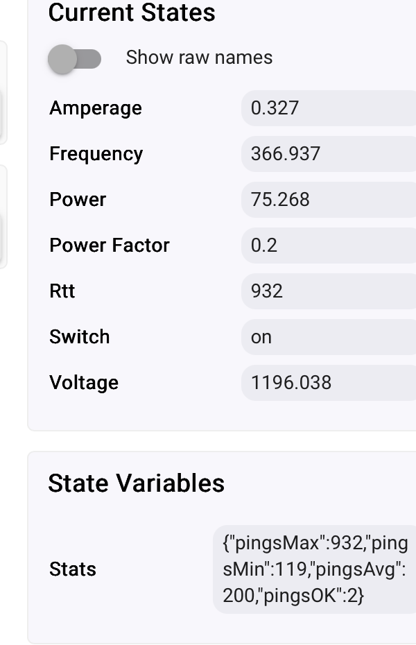

Also using MAB with “ Matter Custom Component Power Energy” driver discovered.
Readings are off by common multipliers.
I see where the problem is with the MAB— do not use it for this device for now...

Switching to Generic Matter Outlet
But,
Ufff... such switching between drivers will be a problem....I'm not really sure how to handle this issue and avoid it.

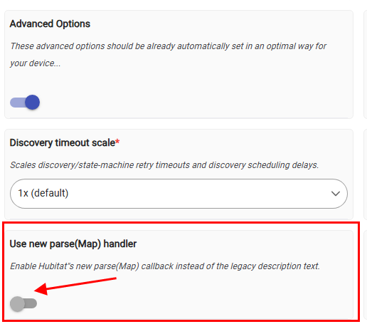

Update 2026-02-14 : the new versions of the MAB relay entirely on the newParse: true decoding, so I have edited this post to hide the obsolete instructions, they are not correct anymore.
Hidden
For now, switch back to the MAB driver, go to Preferences, enable 'Advanced Options', and make sure that the "Use new parse(Map) handler" option is switched OFF. Then Save the preferences.
Afterward, you can witch back to the stock "Generic Matter Outlet" driver.
The newParse:true flag is required to decode Shelly Gen4 energy consumption attributes.

The configure() method should properly set the DeviceData 'newParse'... I tested it and it didn't work with the stock driver... I made a post in the Beta forum. But yes, this new deviceTypeUpdated() method can be very useful in this case.

About the frequent power reports - I think that this is Shelly issue, hopefully will be fixed in a new firmware update. From HE side the repetitive reports could be filtered, but this would be a patch only, the HE hub resources will still be waisted on driver calls when it is not necessary.
Shelly power/energy monitoring devices indeed do report updates every 1 second. They do this when connected via web socket or Matter. And no, there presently isn't a configuration option to change this.
