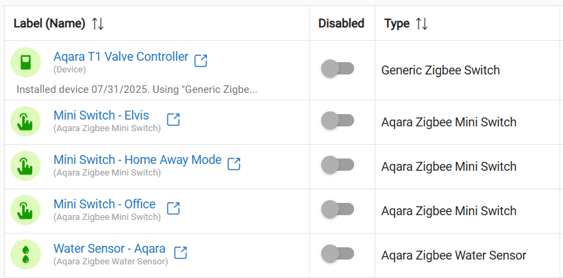

Would pairing an M3 with Hubitat provide more devices details in Hubitat itself, e.g., battery levels? For example now my Aqara T1 valve controller does not show the battery level.
I'm sure using the Aqara app on my phone I would get all of the device details via the M3.

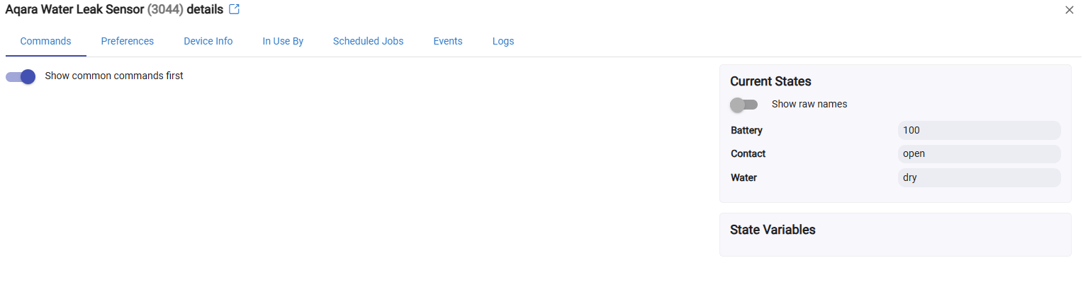

While you are looking into that the water leak sensors come over from the M2 via matter as contact sensors. Can you have that looked into as well?

Not the most elegant way, but the ̶n̶e̶x̶t̶ new update will allow you to select the Generic Component Water Sensor (comes with battery level fixes for all component drivers as well):
After updating to 131, go to the child device in question and manually change the driver from generic composite contact to generic composite water and you should be good to go.
There isn't a way to determine the actual device type within the bridge application.
Thank you. I am not concerned about elegant just that it works. I was never accused of being an elegant guy. :rofl::rofl: I used them as contact sensors but this new update will clean that up. Just had to be aware of the attribute when I was setting up alerts and such. Thank you to anyone that helped get this cleaned up. Much appreciated.
