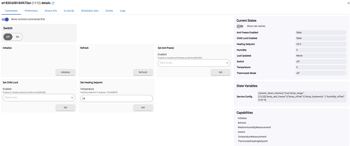

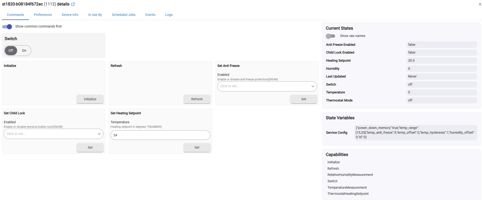

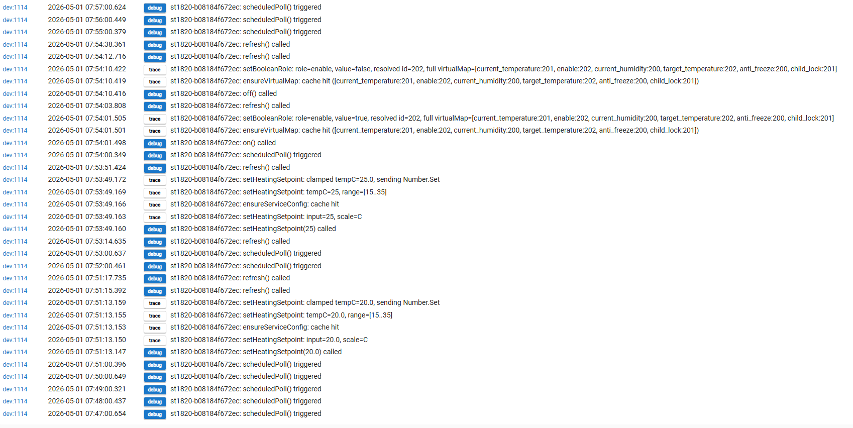

When I then look at the driver:
  • The 'Set Heating Setpoint' changes the setpoint on the device, but the current setpoint is not updated from the device in this field or in the Current States: Heating Setpoint field.
  • Current States: Switch or the Current States: Temperature are not updated from the device into Hubitat
  • When you try to override the switch from the commands page the error log is:
Hope you can make sense of this? Appreciate your help.
Regards
Andy

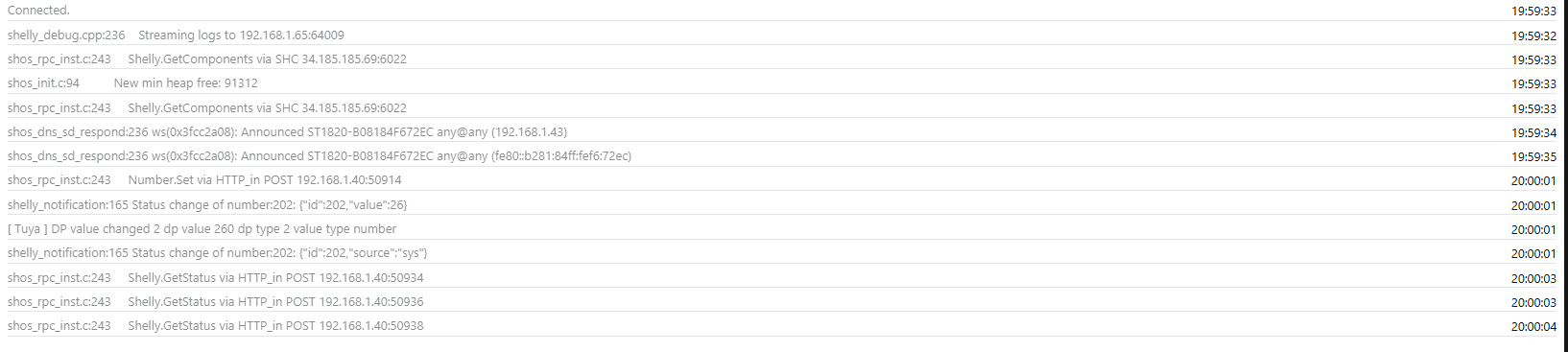

and I've enabled logging on the ST1820 via it's web page and info from that end is as follows:

FYI, 192.168.1.65 is the PC I'm checking from, and 192.168.1.40 is the Hubitat,
Hope you can make sense of this, but to my untrained eye it appears that the St1820 is reporting back parameter 201 as the measured temp, and 200 is the Humidity but the device driver is not interpreting these correctly. Similarly 202 looks like the setpoint reporting back.
Thanks, Andy

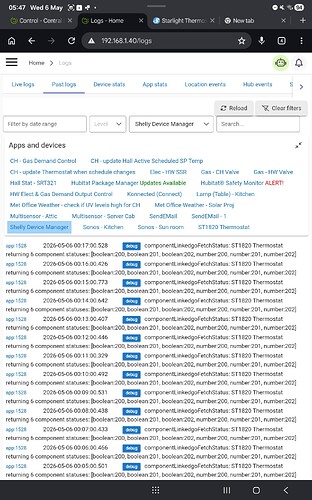

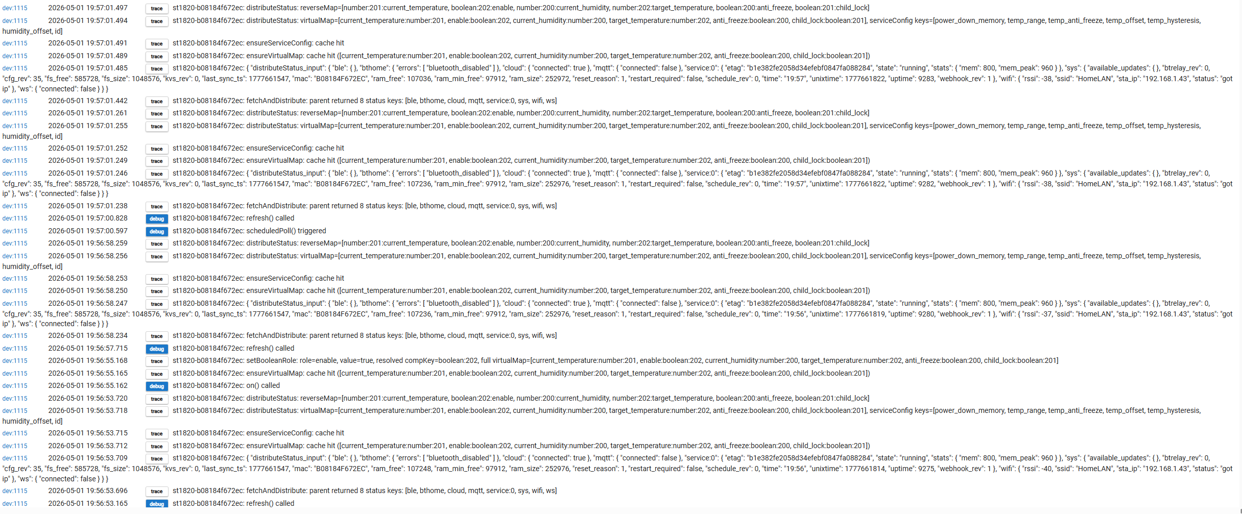

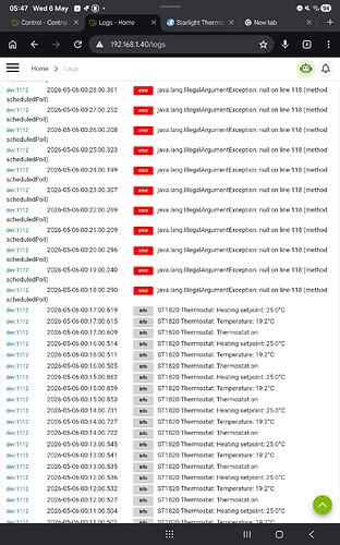

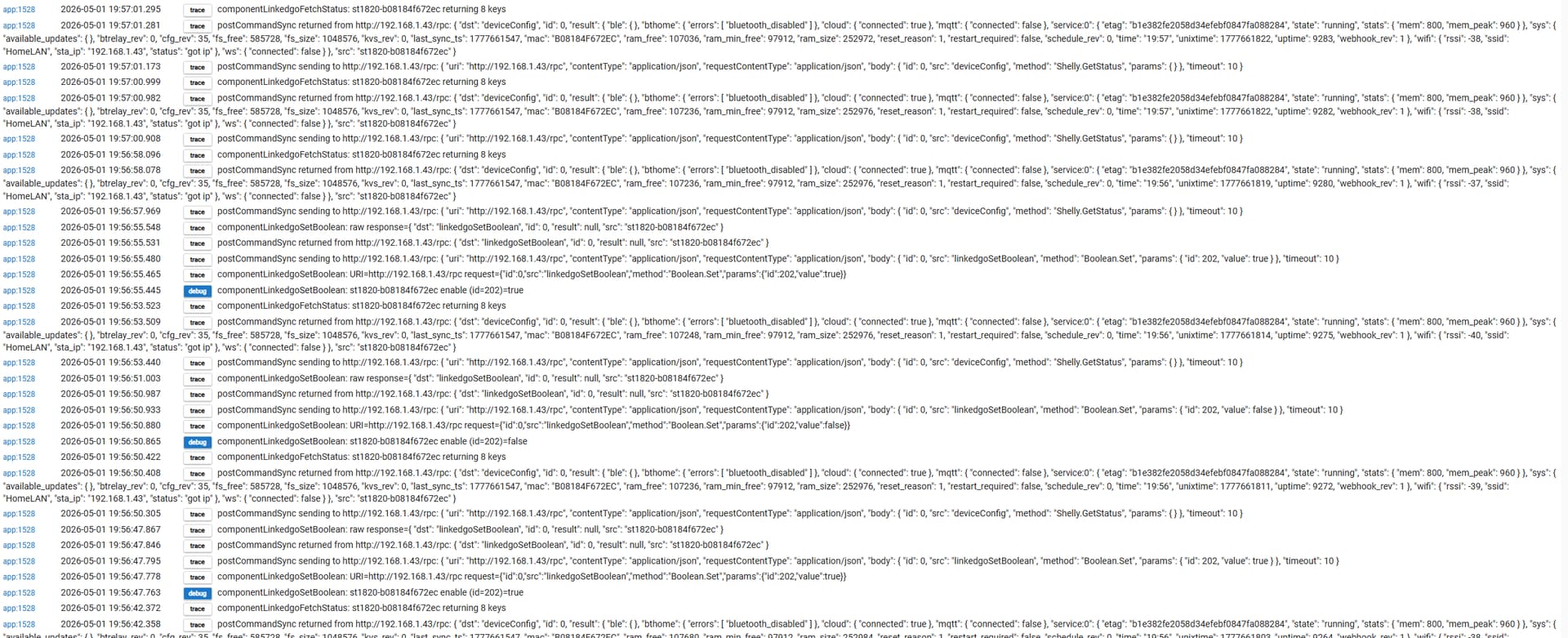

Thanks again... I put out another update with some more changes based on these logs. Give it a go and let me know!

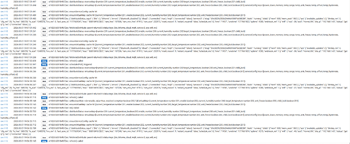

Sorry Daniel, still not reading the status data.
Device Log:
App Log:
The web log from the ST1820 (but not in sync with the others as I hadnt started it):
Is there anything specific you want me to try and capture?
Regards
Andy
Alright, made a few more updates. Nothing specific to capture, just the full logs of each attempt. Just need logs to help narrow down exactly how these thermostats work. They use just a "service" and some virtual numbers/booleans, so they're a bit different than most every other Shelly device.
Give this new update a try and post the complete logs here again if there's still issues. Thanks!

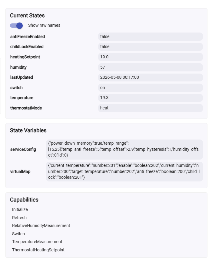

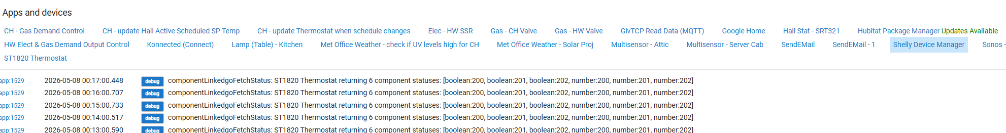

Hi Daniel,
Fantastic progress, I can now see and have access to the attributes of the device for heatingSetpoint, humidity and temperature. These are all I need to run my app for my house heating, as I make the decision in a Hubitat to enable heating based on this data and use a PWM algorithm rather than the thermostat output switch.
However, the reported switch status in the driver is the status of whether the thermostat is enabled - the device allows for itself to be turned on or put into a sleep mode. The switch status in the driver is not reading the status of the 'heat' output relay. I'd suggest for completion of the driver it would be good to get this right.
Other areas as follows:
  • ChildlockEnabled - also works correctly
  • ThermoStat Mode - I think this is a fixed mode, so 'heat' is correct and always will be
  • antiFreezeEnabled - works correctly

dev:11152026-05-03 20:46:02.361
trace
st1820-b08184f672ec: distributeStatus iter: key=number:200, resolved role=current_humidity, data=[last_update_ts:1777837283, source:sys, value:49]
dev:11152026-05-03 20:46:02.358
info
st1820-b08184f672ec: Thermostat on
dev:11152026-05-03 20:46:02.352
trace
st1820-b08184f672ec: handleRoleUpdate: role=enable, value=true, scale=C
dev:11152026-05-03 20:46:02.349
trace
st1820-b08184f672ec: distributeStatus iter: key=boolean:202, resolved role=enable, data=[last_update_ts:1777837347, source:rpc, value:true]
dev:11152026-05-03 20:46:02.343
trace
st1820-b08184f672ec: handleRoleUpdate: role=child_lock, value=false, scale=C
dev:11152026-05-03 20:46:02.341
trace
st1820-b08184f672ec: distributeStatus iter: key=boolean:201, resolved role=child_lock, data=[last_update_ts:1777661047, source:rpc, value:false]
dev:11152026-05-03 20:46:02.338
trace
st1820-b08184f672ec: handleRoleUpdate: role=anti_freeze, value=false, scale=C
dev:11152026-05-03 20:46:02.336
trace
st1820-b08184f672ec: distributeStatus iter: key=boolean:200, resolved role=anti_freeze, data=[last_update_ts:1777661447, source:rpc, value:false]
dev:11152026-05-03 20:46:02.333
trace
st1820-b08184f672ec: distributeStatus: reverseMap=[number:201:current_temperature, boolean:202:enable, number:200:current_humidity, number:202:target_temperature, boolean:200:anti_freeze, boolean:201:child_lock]
dev:11152026-05-03 20:46:02.330
trace
st1820-b08184f672ec: distributeStatus: virtualMap=[current_temperature:number:201, enable:boolean:202, current_humidity:number:200, target_temperature:number:202, anti_freeze:boolean:200, child_lock:boolean:201], serviceConfig keys=[power_down_memory, temp_range, temp_anti_freeze, temp_offset, temp_hysteresis, humidity_offset, id]
dev:11152026-05-03 20:46:02.328
trace
st1820-b08184f672ec: ensureServiceConfig: cache hit
dev:11152026-05-03 20:46:02.325
trace
st1820-b08184f672ec: ensureVirtualMap: cache hit ([current_temperature:number:201, enable:boolean:202, current_humidity:number:200, target_temperature:number:202, anti_freeze:boolean:200, child_lock:boolean:201])
dev:11152026-05-03 20:46:02.322
trace
st1820-b08184f672ec: { "distributeStatus_input": { "boolean:200": { "last_update_ts": 1777661447, "source": "rpc", "value": false }, "boolean:201": { "last_update_ts": 1777661047, "source": "rpc", "value": false }, "boolean:202": { "last_update_ts": 1777837347, "source": "rpc", "value": true }, "number:200": { "last_update_ts": 1777837283, "source": "sys", "value": 49 }, "number:201": { "last_update_ts": 1777837283, "source": "sys", "value": 23.9 }, "number:202": { "last_update_ts": 1777837518, "source": "sys", "value": 22 } } }
dev:11152026-05-03 20:46:02.315
trace
st1820-b08184f672ec: fetchAndDistribute: parent returned 6 status keys: [boolean:200, boolean:201, boolean:202, number:200, number:201, number:202]
dev:11152026-05-03 20:46:00.366
debug
st1820-b08184f672ec: scheduledPoll() triggered

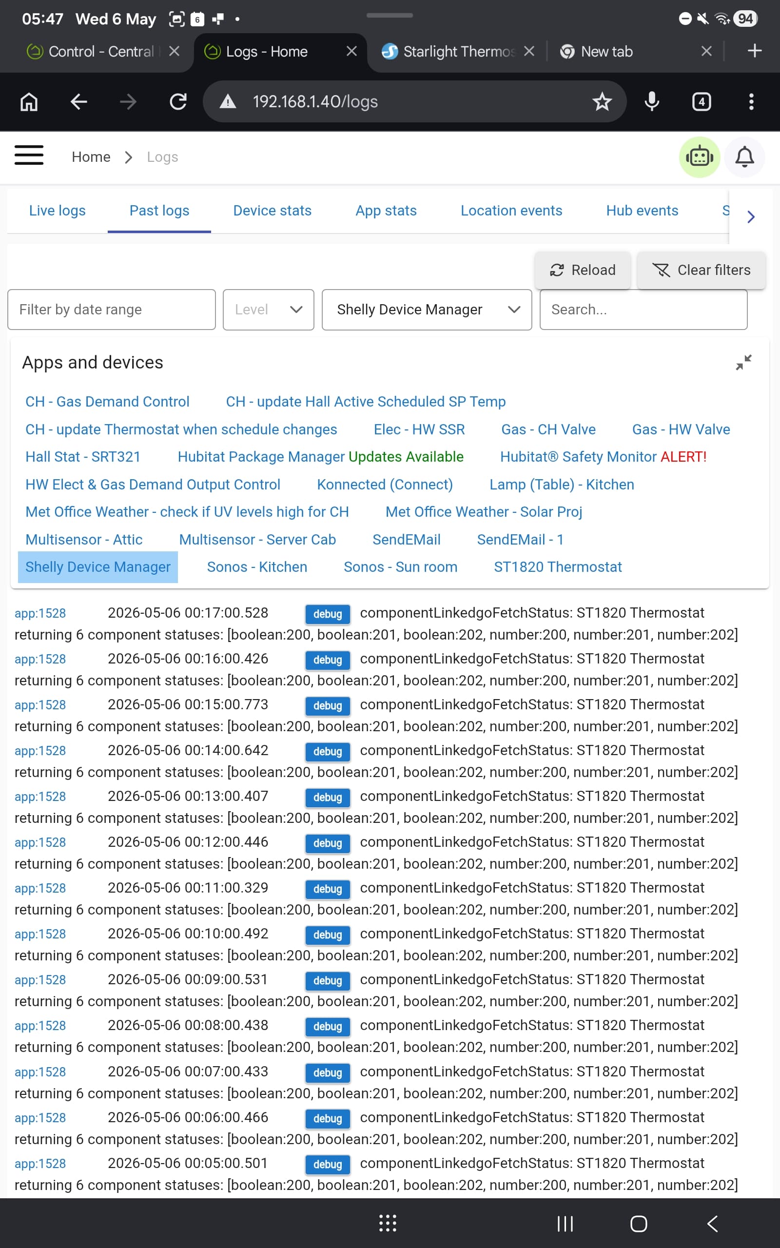

Then logs from the app:
app:15282026-05-03 21:01:02.052
debug
componentLinkedgoFetchStatus: st1820-b08184f672ec returning 6 component statuses: [boolean:200, boolean:201, boolean:202, number:200, number:201, number:202]
app:15282026-05-03 21:01:02.007
trace
componentLinkedgoFetchStatus: raw response={ "dst": "linkedgoFetchStatus", "id": 0, "result": { "cfg_rev": 39, "components": [ { "key": "ble", "status": { } }, { "attrs": { "owner": "service:0", "role": "anti_freeze" }, "key": "boolean:200", "status": { "last_update_ts": 1777838128, "source": "sys", "value": false } }, { "attrs": { "owner": "service:0", "role": "child_lock" }, "key": "boolean:201", "status": { "last_update_ts": 1777837920, "source": "sys", "value": false } }, { "attrs": { "owner": "service:0", "role": "enable" }, "key": "boolean:202", "status": { "last_update_ts": 1777837347, "source": "rpc", "value": true } }, { "key": "bthome", "status": { "errors": [ "bluetooth_disabled" ] } }, { "key": "cloud", "status": { "connected": false } }, { "key": "mqtt", "status": { "connected": false } }, { "attrs": { "owner": "service:0", "role": "current_humidity" }, "key": "number:200", "status": { "last_update_ts": 1777838123, "source": "sys", "value": 48 } }, { "attrs": { "owner": "service:0", "role": "current_temperature" }, "key": "number:201", "status": { "last_update_ts": 1777838423, "source": "sys", "value": 24.1 } }, { "attrs": { "owner": "service:0", "role": "target_temperature" }, "key": "number:202", "status": { "last_update_ts": 1777837518, "source": "sys", "value": 22 } }, { "key": "service:0", "status": { "etag": "b1e382fe2058d34efebf0847fa088284", "state": "running", "stats": { "mem": 800, "mem_peak": 960 } } }, { "key": "sys", "status": { "available_updates": { }, "btrelay_rev": 0, "cfg_rev": 39, "fs_free": 585728, "fs_size": 1048576, "kvs_rev": 0, "last_sync_ts": 1777837953, "mac": "B08184F672EC", "ram_free": 112896, "ram_min_free": 91312, "ram_size": 253116, "reset_reason": 1, "restart_required": false, "schedule_rev": 0, "time": "21:00", "unixtime": 1777838459, "uptime": 185919, "webhook_rev": 1 } }, { "key": "wifi", "status": { "rssi": -31, "ssid": "HomeLAN", "sta_ip": "192.168.1.43", "status": "got ip" } }, { "key": "ws", "status": { "connected": false } } ], "offset": 0, "total": 14 }, "src": "st1820-b08184f672ec" }
app:15282026-05-03 21:01:01.690
trace
postCommandSync returned from http://192.168.1.43/rpc: { "dst": "linkedgoFetchStatus", "id": 0, "result": { "cfg_rev": 39, "components": [ { "key": "ble", "status": { } }, { "attrs": { "owner": "service:0", "role": "anti_freeze" }, "key": "boolean:200", "status": { "last_update_ts": 1777838128, "source": "sys", "value": false } }, { "attrs": { "owner": "service:0", "role": "child_lock" }, "key": "boolean:201", "status": { "last_update_ts": 1777837920, "source": "sys", "value": false } }, { "attrs": { "owner": "service:0", "role": "enable" }, "key": "boolean:202", "status": { "last_update_ts": 1777837347, "source": "rpc", "value": true } }, { "key": "bthome", "status": { "errors": [ "bluetooth_disabled" ] } }, { "key": "cloud", "status": { "connected": false } }, { "key": "mqtt", "status": { "connected": false } }, { "attrs": { "owner": "service:0", "role": "current_humidity" }, "key": "number:200", "status": { "last_update_ts": 1777838123, "source": "sys", "value": 48 } }, { "attrs": { "owner": "service:0", "role": "current_temperature" }, "key": "number:201", "status": { "last_update_ts": 1777838423, "source": "sys", "value": 24.1 } }, { "attrs": { "owner": "service:0", "role": "target_temperature" }, "key": "number:202", "status": { "last_update_ts": 1777837518, "source": "sys", "value": 22 } }, { "key": "service:0", "status": { "etag": "b1e382fe2058d34efebf0847fa088284", "state": "running", "stats": { "mem": 800, "mem_peak": 960 } } }, { "key": "sys", "status": { "available_updates": { }, "btrelay_rev": 0, "cfg_rev": 39, "fs_free": 585728, "fs_size": 1048576, "kvs_rev": 0, "last_sync_ts": 1777837953, "mac": "B08184F672EC", "ram_free": 112896, "ram_min_free": 91312, "ram_size": 253116, "reset_reason": 1, "restart_required": false, "schedule_rev": 0, "time": "21:00", "unixtime": 1777838459, "uptime": 185919, "webhook_rev": 1 } }, { "key": "wifi", "status": { "rssi": -31, "ssid": "HomeLAN", "sta_ip": "192.168.1.43", "status": "got ip" } }, { "key": "ws", "status": { "connected": false } } ], "offset": 0, "total": 14 }, "src": "st1820-b08184f672ec" }
app:15282026-05-03 21:01:01.392
trace
postCommandSync sending to http://192.168.1.43/rpc: { "uri": "http://192.168.1.43/rpc", "contentType": "application/json", "requestContentType": "application/json", "body": { "id": 0, "src": "linkedgoFetchStatus", "method": "Shelly.GetComponents", "params": { "include": [ "status" ] } }, "timeout": 10 }
app:15282026-05-03 21:01:01.327
trace
componentLinkedgoFetchStatus: URI=http://192.168.1.43/rpc request={"id":0,"src":"linkedgoFetchStatus","method":"Shelly.GetComponents","params":{"include":["status"]}}
app:15282026-05-03 21:00:13.184
trace
watchdogProcessResults: no mDNS entries found
app:15282026-05-03 21:00:12.163
trace
watchdogProcessResults: checking for IP changes
app:15282026-05-03 21:00:03.014
debug
app:15282026-05-03 21:00:03.009
trace
componentLinkedgoFetchStatus: raw response={ "dst": "linkedgoFetchStatus", "id": 0, "result": { "cfg_rev": 39, "components": [ { "key": "ble", "status": { } }, { "attrs": { "owner": "service:0", "role": "anti_freeze" }, "key": "boolean:200", "status": { "last_update_ts": 1777838128, "source": "sys", "value": false } }, { "attrs": { "owner": "service:0", "role": "child_lock" }, "key": "boolean:201", "status": { "last_update_ts": 1777837920, "source": "sys", "value": false } }, { "attrs": { "owner": "service:0", "role": "enable" }, "key": "boolean:202", "status": { "last_update_ts": 1777837347, "source": "rpc", "value": true } }, { "key": "bthome", "status": { "errors": [ "bluetooth_disabled" ] } }, { "key": "cloud", "status": { "connected": false } }, { "key": "mqtt", "status": { "connected": false } }, { "attrs": { "owner": "service:0", "role": "current_humidity" }, "key": "number:200", "status": { "last_update_ts": 1777838123, "source": "sys", "value": 48 } }, { "attrs": { "owner": "service:0", "role": "current_temperature" }, "key": "number:201", "status": { "last_update_ts": 1777838303, "source": "sys", "value": 24.2 } }, { "attrs": { "owner": "service:0", "role": "target_temperature" }, "key": "number:202", "status": { "last_update_ts": 1777837518, "source": "sys", "value": 22 } }, { "key": "service:0", "status": { "etag": "b1e382fe2058d34efebf0847fa088284", "state": "running", "stats": { "mem": 800, "mem_peak": 960 } } }, { "key": "sys", "status": { "available_updates": { }, "btrelay_rev": 0, "cfg_rev": 39, "fs_free": 585728, "fs_size": 1048576, "kvs_rev": 0, "last_sync_ts": 1777837953, "mac": "B08184F672EC", "ram_free": 112596, "ram_min_free": 91312, "ram_size": 253092, "reset_reason": 1, "restart_required": false, "schedule_rev": 0, "time": "21:00", "unixtime": 1777838400, "uptime": 185860, "webhook_rev": 1 } }, { "key": "wifi", "status": { "rssi": -31, "ssid": "HomeLAN", "sta_ip": "192.168.1.43", "status": "got ip" } }, { "key": "ws", "status": { "connected": false } } ], "offset": 0, "total": 14 }, "src": "st1820-b08184f672ec" }
app:15282026-05-03 21:00:02.681
trace
postCommandSync returned from http://192.168.1.43/rpc: { "dst": "linkedgoFetchStatus", "id": 0, "result": { "cfg_rev": 39, "components": [ { "key": "ble", "status": { } }, { "attrs": { "owner": "service:0", "role": "anti_freeze" }, "key": "boolean:200", "status": { "last_update_ts": 1777838128, "source": "sys", "value": false } }, { "attrs": { "owner": "service:0", "role": "child_lock" }, "key": "boolean:201", "status": { "last_update_ts": 1777837920, "source": "sys", "value": false } }, { "attrs": { "owner": "service:0", "role": "enable" }, "key": "boolean:202", "status": { "last_update_ts": 1777837347, "source": "rpc", "value": true } }, { "key": "bthome", "status": { "errors": [ "bluetooth_disabled" ] } }, { "key": "cloud", "status": { "connected": false } }, { "key": "mqtt", "status": { "connected": false } }, { "attrs": { "owner": "service:0", "role": "current_humidity" }, "key": "number:200", "status": { "last_update_ts": 1777838123, "source": "sys", "value": 48 } }, { "attrs": { "owner": "service:0", "role": "current_temperature" }, "key": "number:201", "status": { "last_update_ts": 1777838303, "source": "sys", "value": 24.2 } }, { "attrs": { "owner": "service:0", "role": "target_temperature" }, "key": "number:202", "status": { "last_update_ts": 1777837518, "source": "sys", "value": 22 } }, { "key": "service:0", "status": { "etag": "b1e382fe2058d34efebf0847fa088284", "state": "running", "stats": { "mem": 800, "mem_peak": 960 } } }, { "key": "sys", "status": { "available_updates": { }, "btrelay_rev": 0, "cfg_rev": 39, "fs_free": 585728, "fs_size": 1048576, "kvs_rev": 0, "last_sync_ts": 1777837953, "mac": "B08184F672EC", "ram_free": 112596, "ram_min_free": 91312, "ram_size": 253092, "reset_reason": 1, "restart_required": false, "schedule_rev": 0, "time": "21:00", "unixtime": 1777838400, "uptime": 185860, "webhook_rev": 1 } }, { "key": "wifi", "status": { "rssi": -31, "ssid": "HomeLAN", "sta_ip": "192.168.1.43", "status": "got ip" } }, { "key": "ws", "status": { "connected": false } } ], "offset": 0, "total": 14 }, "src": "st1820-b08184f672ec" }
app:15282026-05-03 21:00:02.241
trace
app:15282026-05-03 21:00:02.225
trace
app:15282026-05-03 21:00:02.137
trace
Registered mDNS listener: _http._tcp
app:15282026-05-03 21:00:02.129
trace
Registered mDNS listener: _shelly._tcp
app:15282026-05-03 21:00:02.110
trace
watchdogScan: starting mDNS scan for IP changes

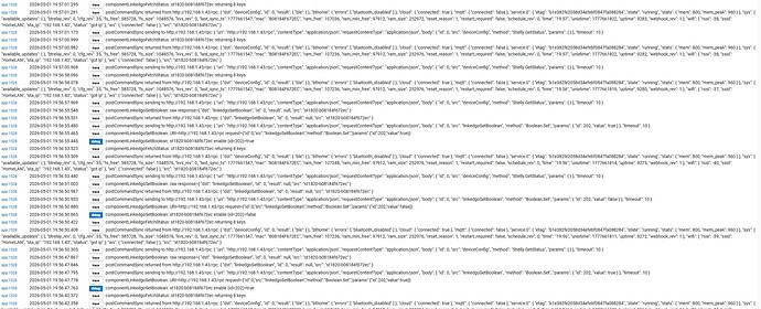

Then from the ST1820 device (note as I up the setpoint the output relay comes in and seems to be reported 'DP Value Changed163 - 4 seems to be output relay off, and 3 is on... or something like??
shos_rpc_inst.c:243 service.getresources via WS_in 192.168.1.65:59955
21:01:53
shos_rpc_inst.c:243 service.getinfo via WS_in 192.168.1.65:59955
21:01:53
shos_init.c:94 New min heap free: 91136
21:01:53
shelly_debug.cpp:236 Streaming logs to 192.168.1.65:52384
21:01:53
shos_rpc_inst.c:243 number.set via WS_in 192.168.1.65:59955
21:01:56
shelly_notification:165 Status change of number:202: {"id":202,"source":"rpc"}
21:01:56
shos_rpc_inst.c:243 Shelly.GetComponents via HTTP_in POST 192.168.1.40:35254
21:01:59
[ Tuya ] DP value changed 3 dp value 240 dp type 2 value type number
21:02:23
shelly_notification:165 Status change of number:201: {"id":201,"value":24}
21:02:23
[ Tuya ] DP value changed 2 dp value 250 dp type 2 value type number
21:02:38
shelly_notification:165 Status change of number:202: {"id":202,"source":"sys","value":25}
21:02:38
[ Tuya ] DP value changed 2 dp value 270 dp type 2 value type number
21:02:40
[ Tuya ] DP value changed 163 dp value 3 dp type 4 value type number
21:02:40
shelly_notification:165 Status change of number:202: {"id":202,"value":27}
21:02:40
shos_rpc_inst.c:243 Shelly.GetComponents via HTTP_in POST 192.168.1.40:35332
21:02:59
shos_rpc_inst.c:243 Shelly.GetComponents via HTTP_in POST 192.168.1.40:35424
21:03:59
[ Tuya ] DP value changed 2 dp value 230 dp type 2 value type number
21:04:05
shelly_notification:165 Status change of number:202: {"id":202,"value":23}
21:04:05
[ Tuya ] DP value changed 163 dp value 4 dp type 4 value type number
21:04:07
[ Tuya ] DP value changed 3 dp value 238 dp type 2 value type number
21:04:24
shelly_notification:165 Status change of number:201: {"id":201,"value":23.8}
21:04:24
shos_rpc_inst.c:243 Shelly.GetComponents via HTTP_in POST 192.168.1.40:35512
21:05:00
Hi Daniel,
One other thought - could you add the 'Thermostat' capability in the device driver to allow the Hubitat to see the device as a Thermostat? It makes the integration into heating schedules simpler.
Only other issue I am seeing is that after a reboot of the ST1820 the read temperature seems to freeze at the default of 20.0 degC. An intervention at the ST1820 (web or local control) then seems to allow correct data to be upated to the Hubitat. This appears to be an issue with the ST1820....
Regards
Andy
What sort of intervention? I might be able to bake that into the driver so it's automatic.
From what I can see here in logs, the actual operating state on the device isn't exposed on RPC. The driver is updated to use current_temperature vs. target_temperature using the device's own temp_hysteresis (read from Service.GetConfig , fallback 0.5 °C) to calculate the current operating state.
The other quirk with the device is that "switch" will reflect the state of the device's heat output relay, but on/off doesn't directly control that, it will instead control having the device on/in sleep mode.
Let me know what "intervention" you're doing and I'll get that plus the changes based on the latest logs and your comments put out in a new version here later today.
Hi Daniel, by intervention I mean I went onto the device's inbuilt web page and changed the setpoint. Up until then the setpoint and measured temperature reflected in the Hubitat driver status were the default values after the addition of a new device. This seems to indicate it's a device issue rather than an issue with your code or the Hubitat framework. Once comms is running it seems rock steady.
The switch status in the device code is simply reflecting whether the ST1820 is enabled or not. The device command switch ON/OFF is simply enabling the Thermostat to operate or not. As you say there's no obvious feedback of the output relay state. This doesnt worry me, as I don't need the output relay as I do my own thing to create a PWM output based on temperature difference to target, but I was offering to help get this output relay state captured if at all feasible. It sounds like it isn't.
Once again many thanks for your work,.
Regards
Andy

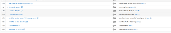

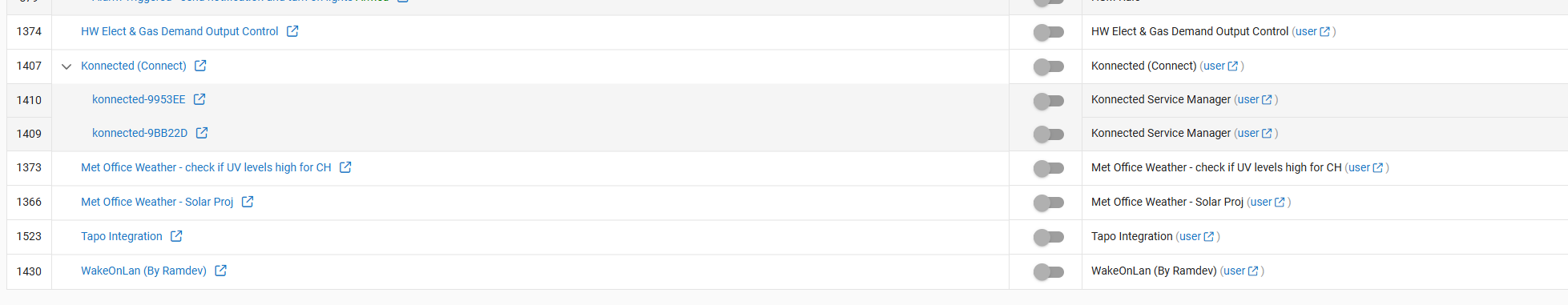

Hi Daniel, the driver locked up about midnight this morning. Logs as follow:
Hmm, did a reboot to see if this would kick off the communication again and the Shelly Manager app has disappeared:
So, perhaps the 'null' the driver is reporting is more to do with the parent app corrupting?
There are no longer any log entries for the app, so looks like to get this working I will need to delete the driver, reinstall the app then reinstall the driver.
PS I am running firmware version 2.5.0.126 - the latest supported release.
Regards
Andy

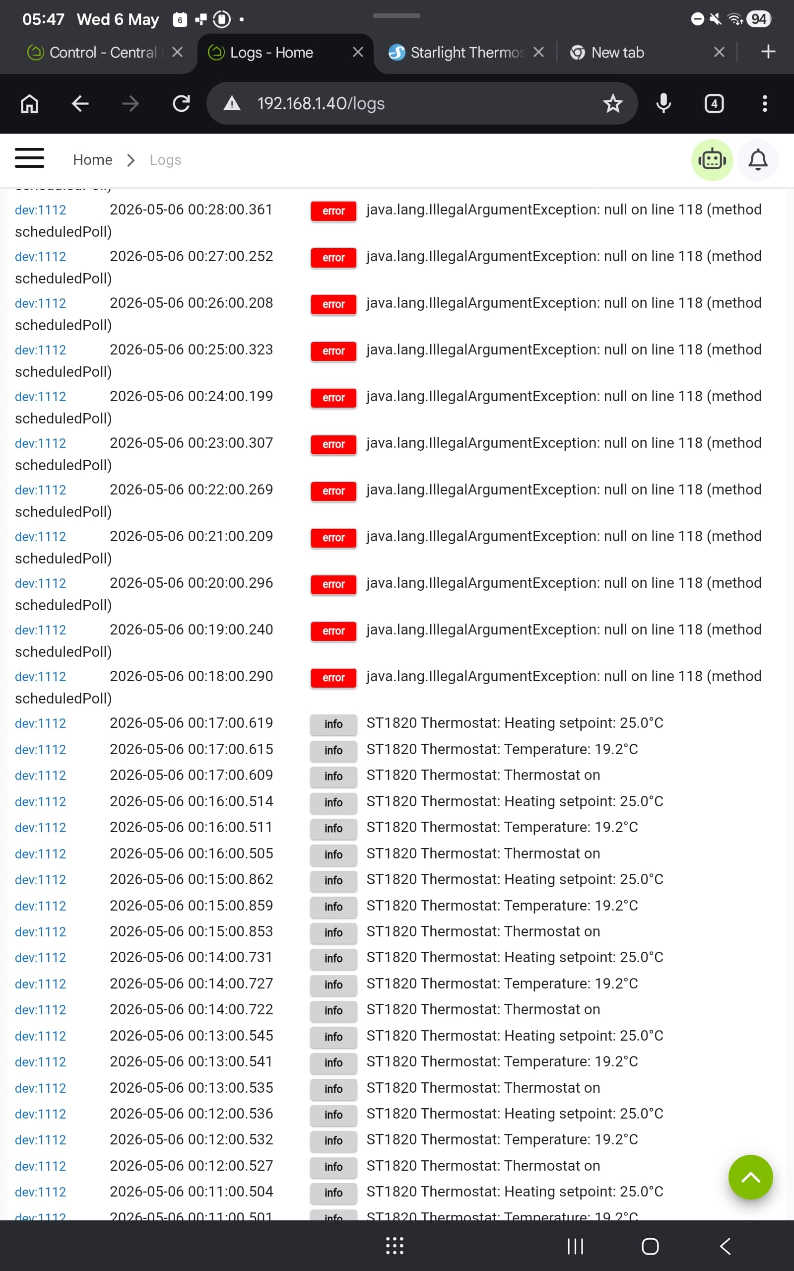

Hi Daniel,
I'm afraid the ST1820 has stopped communicating again at 00:17:
When I check the installed apps, again the Shelly Manager is no longer there, so definitely looks like an app issue.
Nothing in the logs of any use either:
Any thoughts?
Regards
Andy

Then the device log shows:
dev:11182026-05-11 18:11:42.434
error
groovy.lang.GroovyRuntimeException: Cannot read write-only property: schedule on line 180 (method installed)
dev:11182026-05-11 18:11:42.380
info
st1820-b08184f672ec: Heating setpoint: 15.0°C
dev:11182026-05-11 18:11:42.372
info
st1820-b08184f672ec: Temperature: 18.2°C
dev:11182026-05-11 18:11:42.356
info
Hope you can interpret these OK.
Regards
Andy
