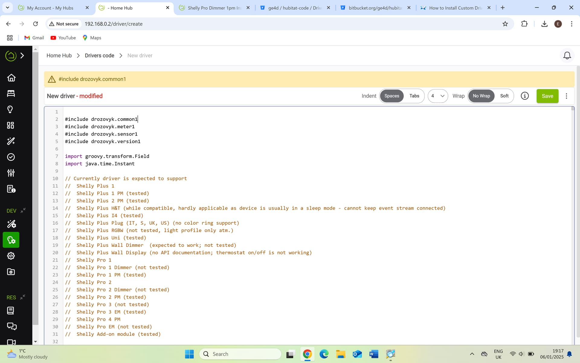

Thank you very much for the support, unfortunately I am seeing this error. Do you know what the issue is?
Yes. You took only a single file. This driver is using libraries (separate files) and child devices (separate files). You better grab entire bundle at once (import bundle zip file trough 'bundles' tab). Bundle contains all in a single archive.
Thank you very much for your help Dmitry. This worked great. I just need to work on my dashboard now!
