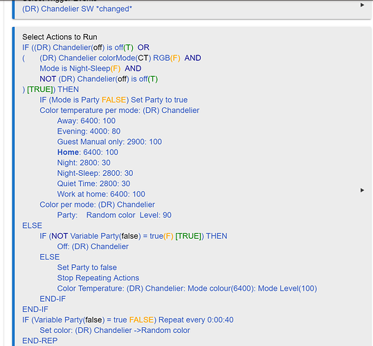

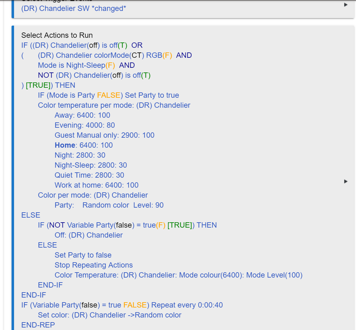

yes, just note that the button event from fibaro dimmer 2 are not built in the HE driver. If enough people request it @mike.maxwell might be happy to add it. I use a custom driver and that bit of it works perfectly but there seem to be some oddities sometimes to the dimmer bit. That bit needs fixing, it works though.
So i use the built in motion lighting app for the motion side of things, I also use modes which makes this setup much easier.
Then as per the above, I also have inputs triggering the a RM rule to decide what else to do, so.
motion lighting app.
The fibaro actually has a few things built in that you can turn on or off ie 1 press turns on/off the light and creates a button event, but a double tap creates a different event type and by default sends the light to 100% (you can turn that off if wanted).
It also has 2 inputs so you can use a centre off retractive switch for ON/UP and OFF/DOWN or just the 1st input for single retractive (push to make) for ON/UP?OFF/DOWN.
So basically without any rules single press ON single press OFF double press ON and it goes to 100%
