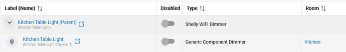

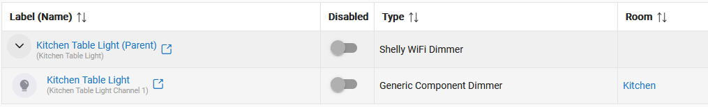

Hello
Check this thread Shelly Device Handlers for Hubitat - :gear: Custom Apps and Drivers / Custom Drivers - Hubitat
It has driver that supports absolute most of the Gen2+ devices out of the box. Dimmers are supported (Plus, Pro, Gen3, Gen4).
