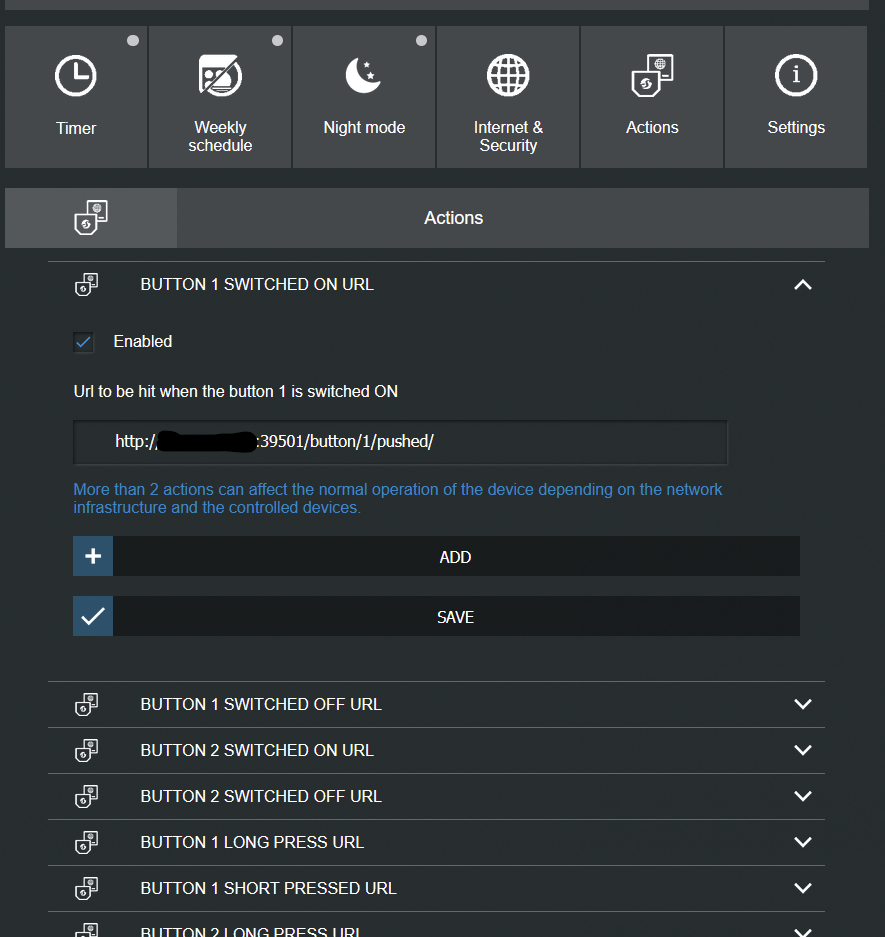

I have a Shelly Dimmer 2 using the system driver. As part of the setup you put in the IP and then save preferences and it configures stuff but an important part is the hub will set the callbacks in the shelly so updates are instant. Can you check those are set? Several of them should be set, but not all:
