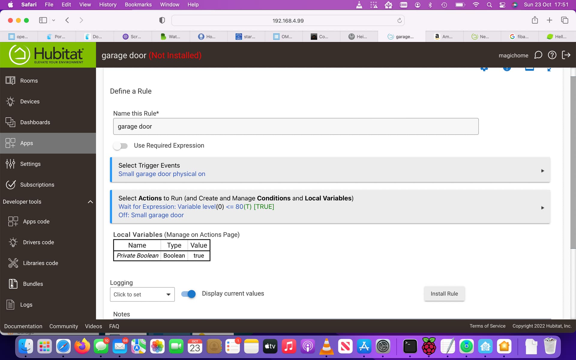

I hope I am getting better, I have a garage door on a shelly 2.5 and for some reason it goes past its calibration level when asking Siri to open the door, I was hoping I could make a rule in Hubitat to stop the door at 80%.

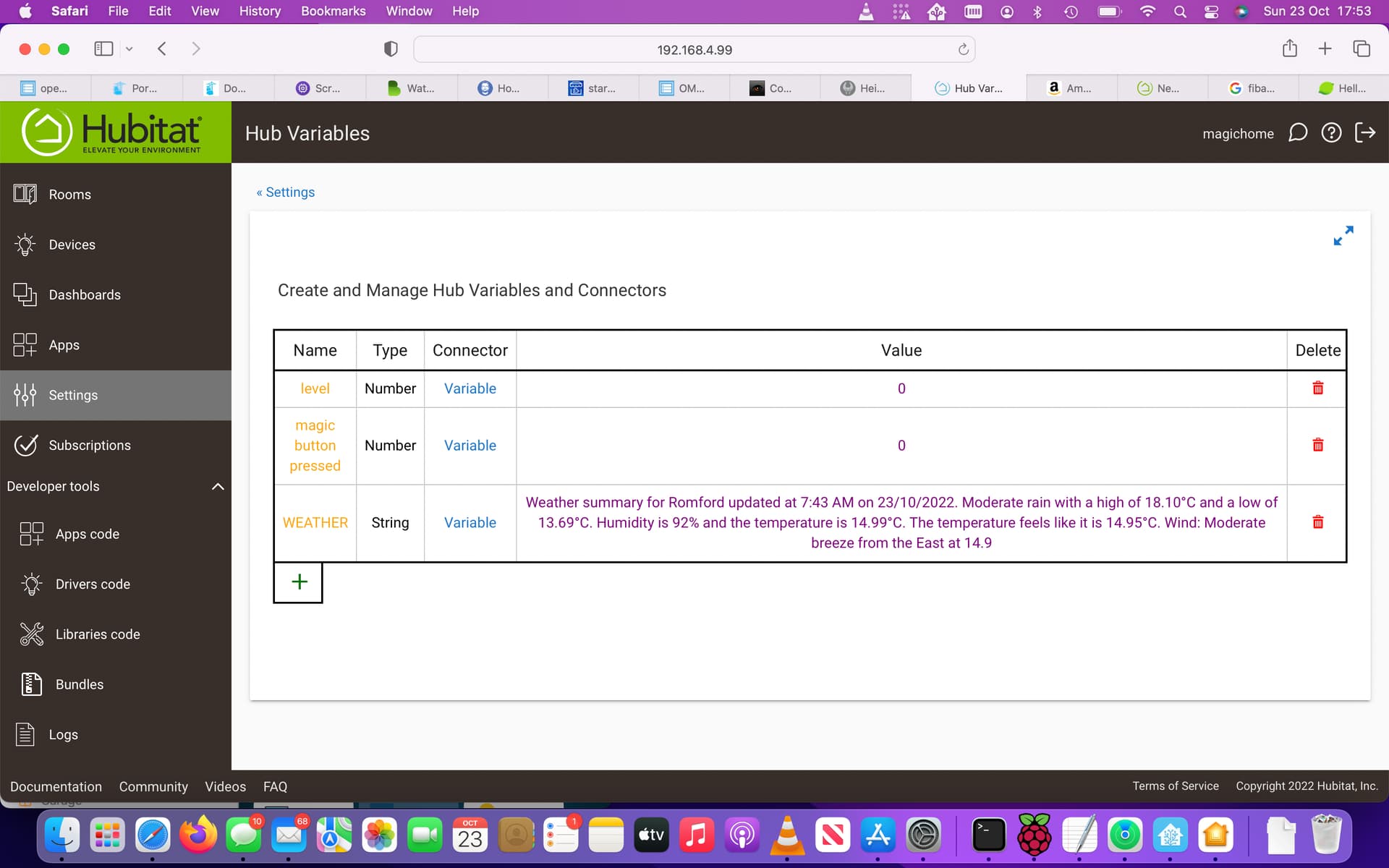

I created a variable for level and made a rule. I haven't tried it yet, just wanted to check to see if it worked
There is no way that I know of to open a garage door at a certain level at this time.
The closest would be to trigger opening and then triggering it again after a certain time. You would need to know how long it takes to get to the level you are looking for in order for this to work.
it opens a little quicker then it closes so I can't do that as I can only find a power on and power off for the shelly 2.5 control, there don't seem to be a up and down function in the rules that I could find. I haven't tried this rule out yet but will give the current one a try as need to work out control on this one before attempting a more fragile plastic garage door, the one I am working on is a old metal beast so will be hard to break
with my current level of stupid I will be surprised if I can get it to work.
I think you can get more control with the fibaro zwave garage door control but the garage is to far from my hub so was trying to go for the cheeper option rather then having to get zwave repeaters ect
