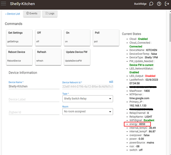

Hey guys, I'm still playing around with energy monitoring and I picked up a Shelly 1pm and installed it into our Kitchen light switch.
Hubitat is reporting energy in a format that I don't think is correct, however Home Assistant is reporting things correctly, am I using the wrong driver in Hubitat?
Now, I don't know anything, but I wonder if you divided that number by 1000 if you would get the right number? As in watt-hours vs kwatt-hours?
Does anybody where I can find version 3.0.8 of the Shelly 1 PM Plus, Regardless it's an outdated driver, it works, none of the new drivers work with my relay switch anymore.
