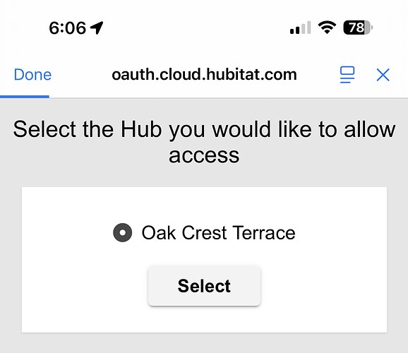

Over the last few weeks, I have been having issues with the integration between Sharptools and Hubitat failing and my dashboards only show placeholders. To rectify, I would have to go into Sharptools to re-authorize my Hubitat Hub. When I just tried to reauthorize my Hubitat hub today, I receive this error. Anyone else having this issue?

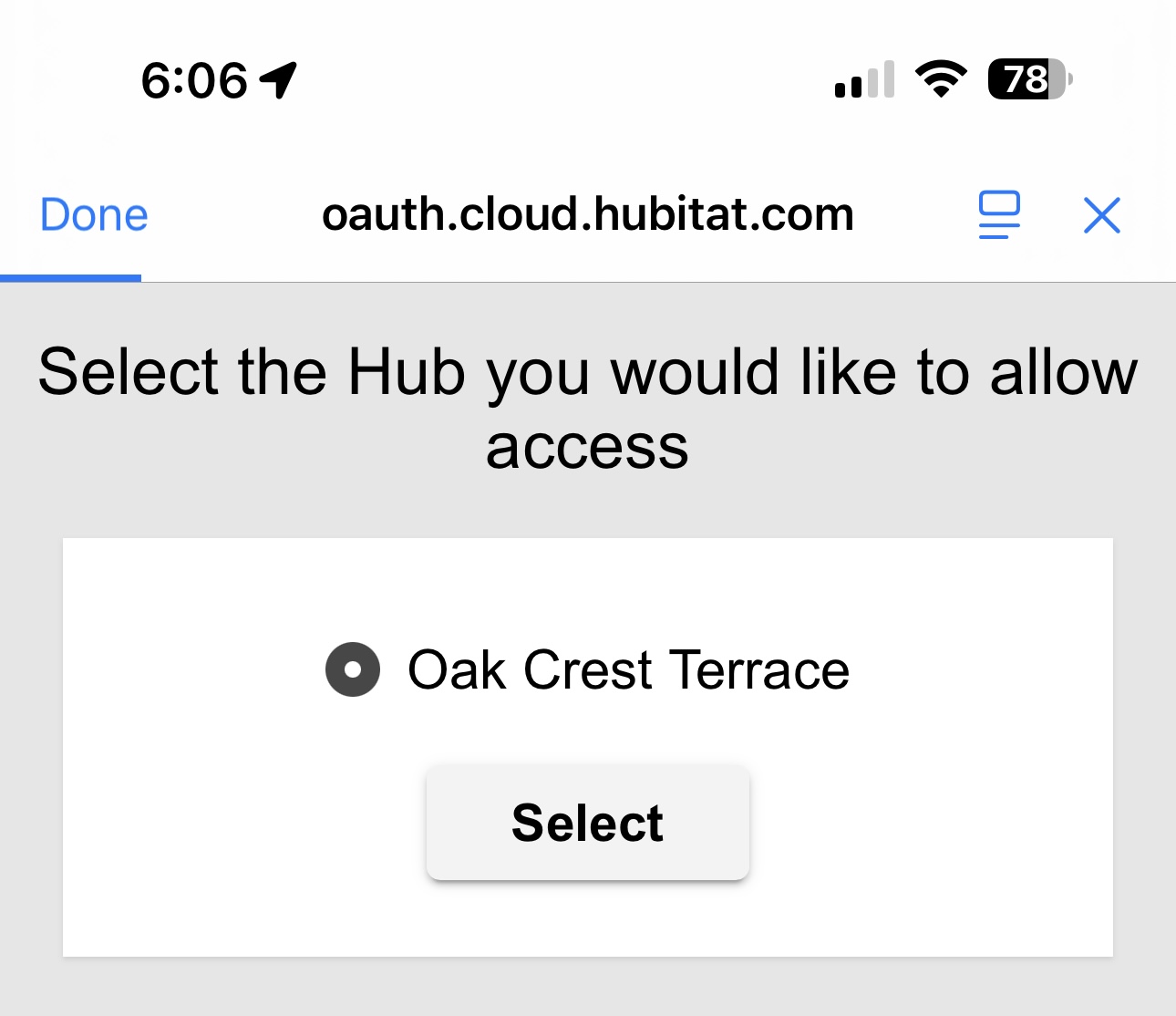

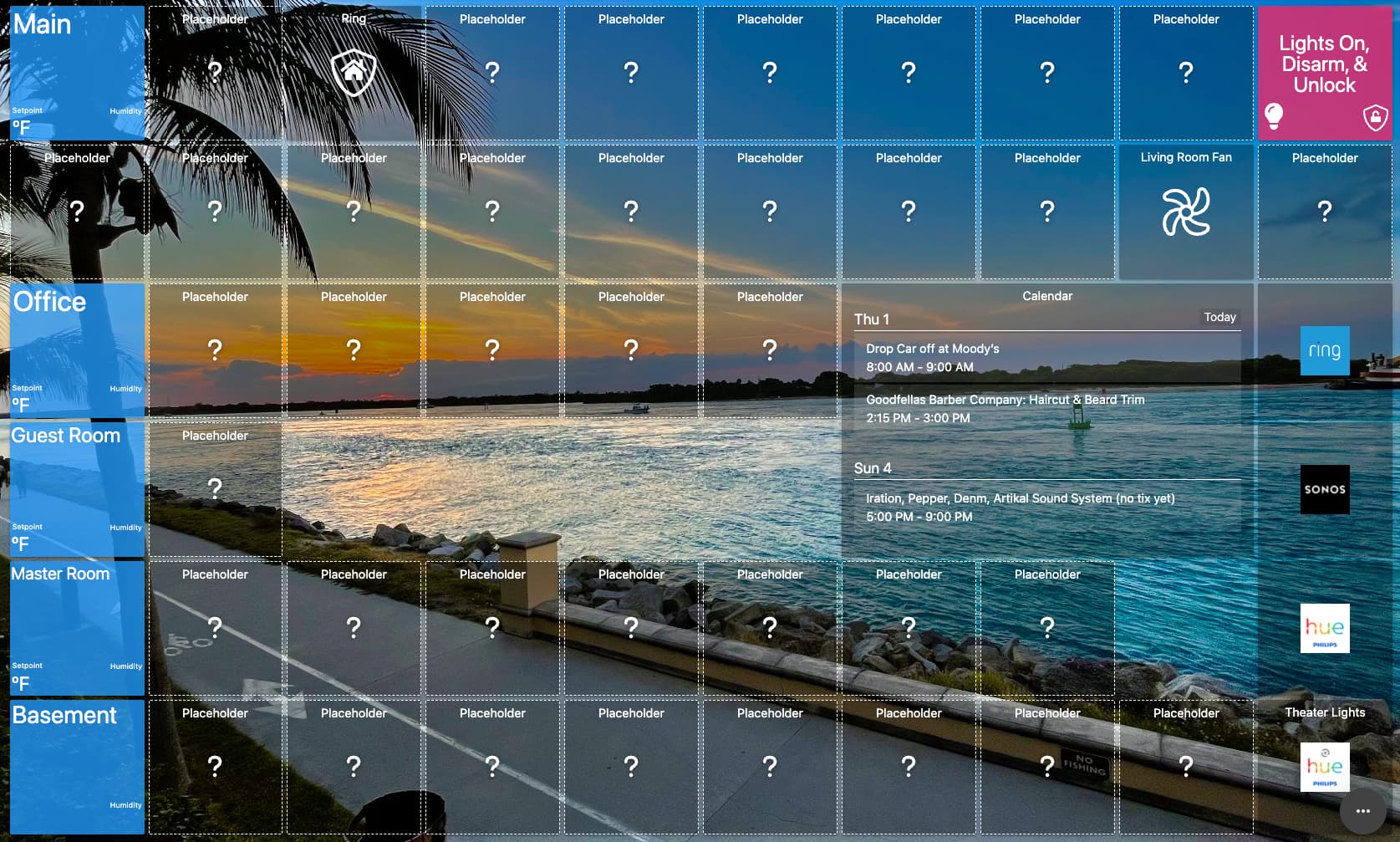

@josh Just started having an issue with my Sharptools dashboard icons not working. I tried reauthorizing from within Sharptools and this is what I'm getting.
Getting Placeholder icons now for everything coming from Hubitat
Rebooted the hub many times, as well as my router/modem. I also tried adding/removing a couple items to the Sharptools app within Hubitat and it "appears" like it's sending over to Sharptools, but something is definitely not linked anymore. It doesn't seem to be the OAuth issue based on everything I've read, but I'm not sure what to try next.
I'm nervous to remove and readd Sharptools in Hubitat in hopes I don't have to redo every tile on the ST dashboard, but do these even have the chance to repopulate with a reconnection?
Thanks for the tag. This is different than the issue originally reported at the start of the thread.
The original issue in this thread was that the Hubitat OAuth servers were fundamentally having issues in July '23. Once Hubitat resolved the underlying issues with the Hubitat OAuth Servers, that resolved the issue.

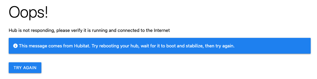

As shown in the screenshot above, your issue appears to be around communication with your hub (using Hubitat's Cloud Relay). Hubitat is reporting the message:
"Hub is not responding, please verify it is running and connected to the internet"

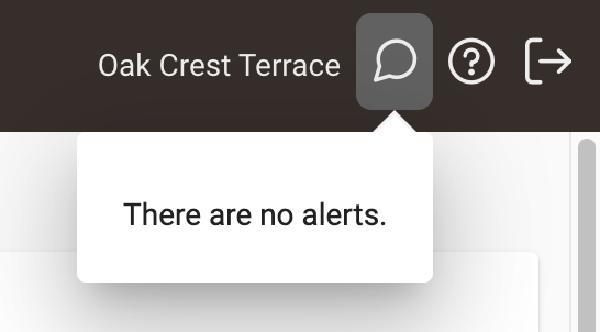

Does your Hubitat Admin Interface show any notifications about cloud connectivity? If I remember correctly, it usually shows in the little message icon in the top-right, but someone who has seen it recently might be able to confirm.
And have you tried other cloud-to-hub communication: Cloud Link for Hubitat Maker API, Authorizing Google Home / Alexa / IFTTT?
That's an outbound communication from your Hub to SharpTools. So your Hub is able to send messages to SharpTools. But SharpTools (+Hubitat Cloud Relay) isn't able to send messages to your Hub as noted by the "Hub is not responding..." message.
I would also take a moment to think if anything else has changed about the hub or your network configuration recently (new apps / drivers, platform updates, driver updates, configuration changes, etc) as those could be impacting your hub's ability to communicate with the Hubitat Cloud Relay.
SharpTools keys off the Location ID (Hub ID) + Device ID for uniquely identifying a device. So you can once your Hub communication issue is resolved, you could reauthorize the hub and the devices should repopulate.
Similarly, you could remove and reinstall the app if you wanted as long as the Hub ID doesn't change (eg. new hub). Your settings / selections would be removed and your issues with the Hubitat Cloud Relay would need to be resolved before you could reauthorize though.

No messages up in the corner

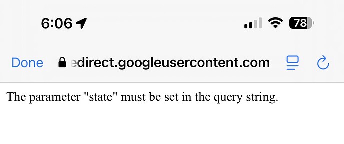

With Google Home, the new device I tried didn't show up in my Google Home app. When I tried to "Check for new devices" in the GH app settings, it won't authorize either...although I don't know what the parameter "state"... message is alerting me to.

It sounds like your hub is having issues connecting to the Hubitat Cloud Relay or something along those lines.

The Google home authorization failing further points to it being a cloud connectivity issue.
