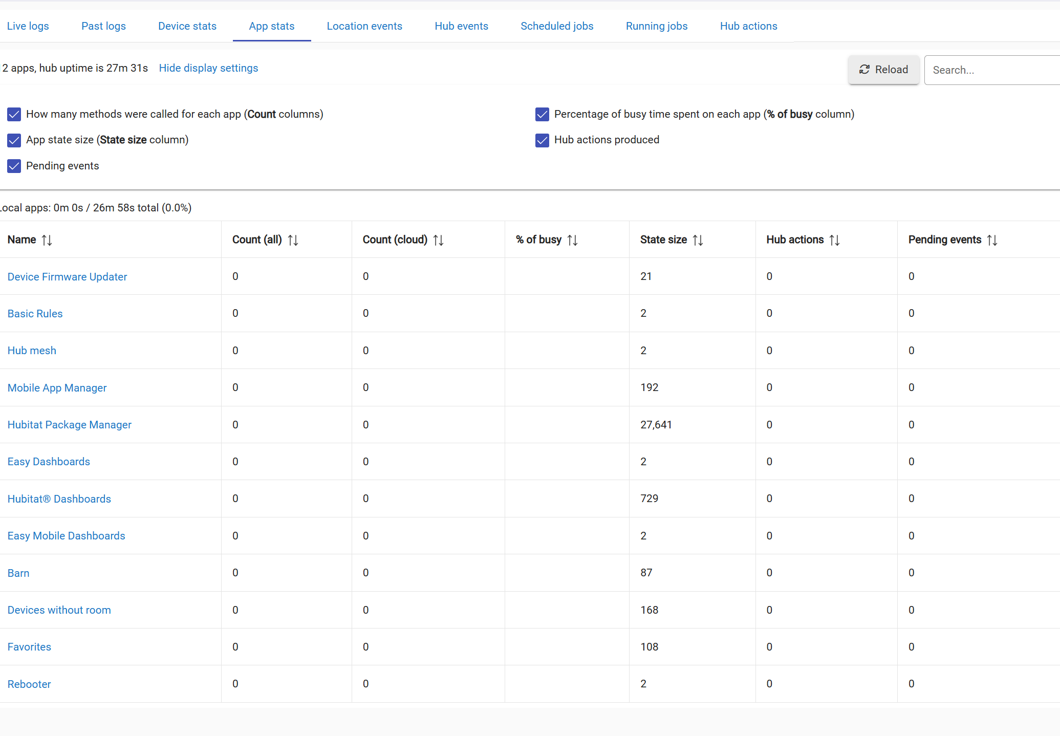

There appears to be nothing in app or device stats, or hub events that something is triggering excessively.
Here are some screen shots of the hub with only 6 Zwave devices...
Any thoughts on what's going on here?
