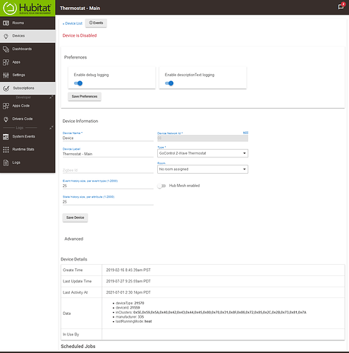

I do have one other thing I think you should try. In all those screenshots, the thermostats seem to rank pretty high in your statistics. I would not only disable those, I would totally remove them for now. See if that makes any difference. I would also reenable all the other devices, and see if that makes any difference. If you have one or more devices spamming the hub, it might be causing you grief.
Oh, and are you polling these thermostats? Can you screenshot the device page for these? Which model are they?
[/quote] I have not had time to try your other suggestions yet but here is a screenshot.
