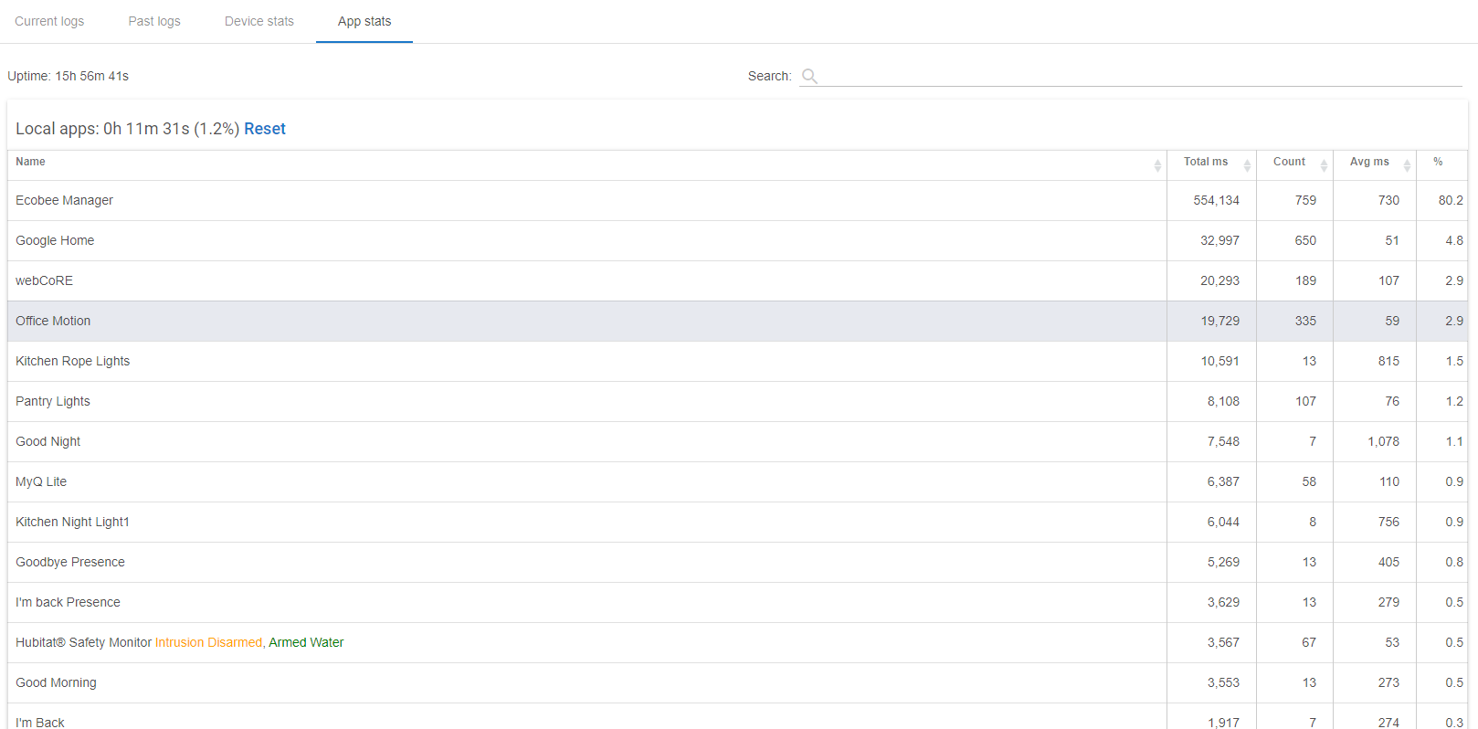

Did you reset these stats? You’ve got 9 days of uptime and only 19 seconds of which an app was running. That seems incorrect to me.
yes i was trying to reset the alert.
Ok so resetting the stats is going to make them useless for someone like @gopher.ny. You’ll have to let things run for awhile for the stats to generate data again to see how time is being spent on the hub and identify if any drivers or apps are going out of control.

I am still having this issue and I think it is my Ecobee thermostat.
