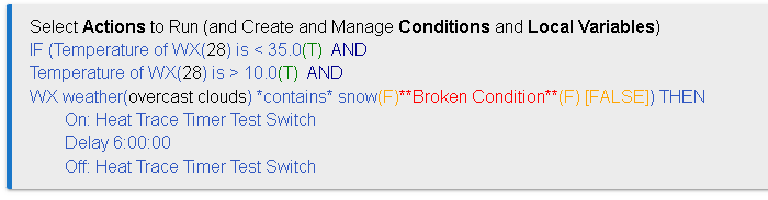

This is one of the first scripts I am writing for Hubitat. If you have a minute to check it, I would appreciate it.
I have a gutter heating system that I would like to operate when there is snow between the tempratures of 10 degrees and 35 degrees, for at least 6 hours.
My understanding is that this would trigger the heat trace to turn on for 6 hours, and then it would turn off. If the conditions for triggering the heat trace remained after 6 hours, it would then turn the heat trace back on.
Am I correct?
If I added: OR WX weather contains rain
would that supersede the temperature requirements or keep the temperature requirements and trigger for both rain and snow?
Nothing will trigger that rule unless you define any trigger events. We can't tell from that screenshot. Can you share the entire rule?
Also, the UI is giving you a hint here that something is wrong: see the red "Broken Condition"? Either fix that condition (on the Manage Conditions page) or at least remove it from this expression, depending on what you're trying to check for.
Finally, I suggest to finish off your IF THEN with an END-IF just to get the habit of correct syntax, even though it won't matter since you don't have any actions after it in this particular rule.
There could be more, but again, seeing the whole rule will allow someone to see for sure.

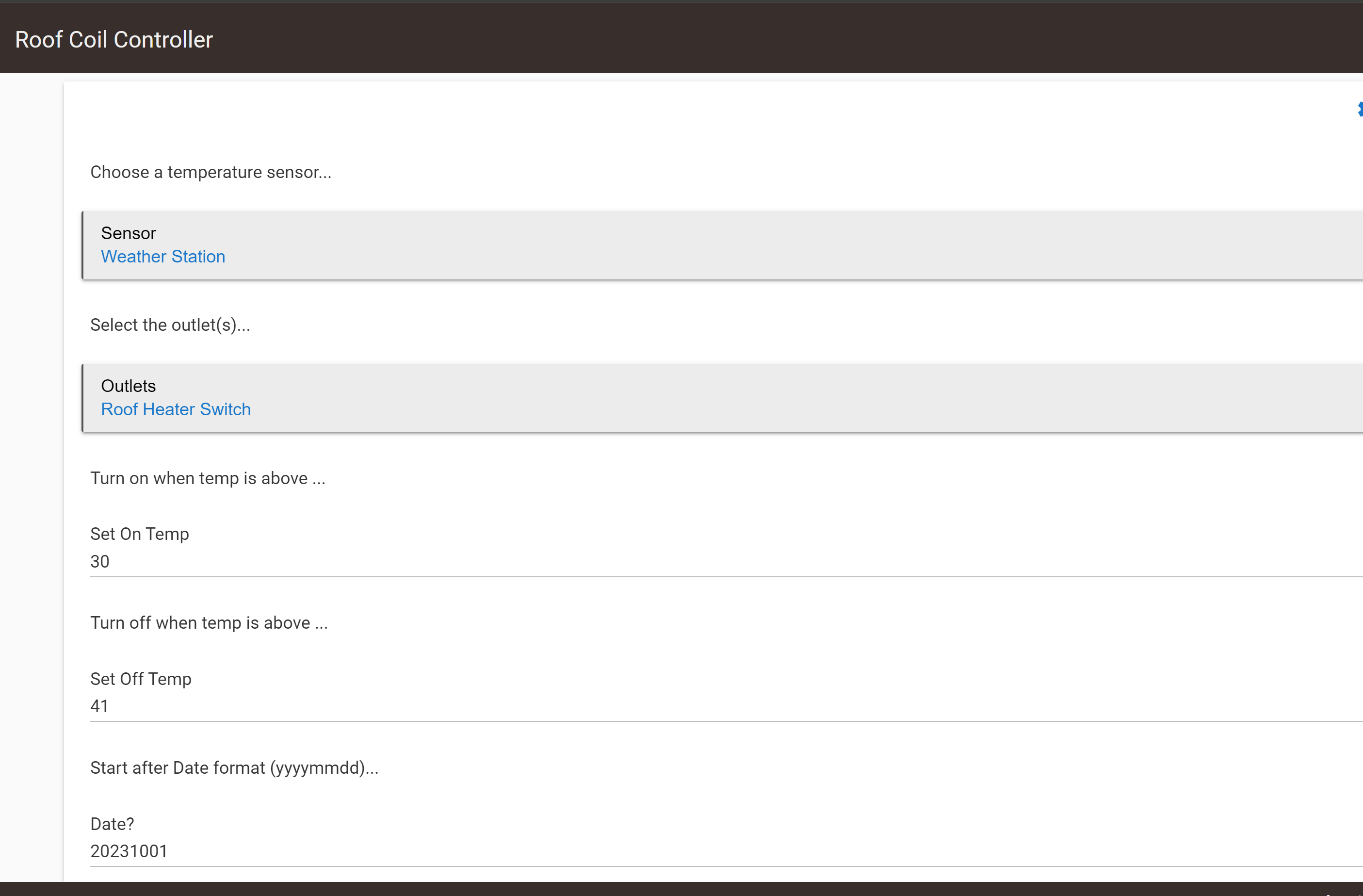

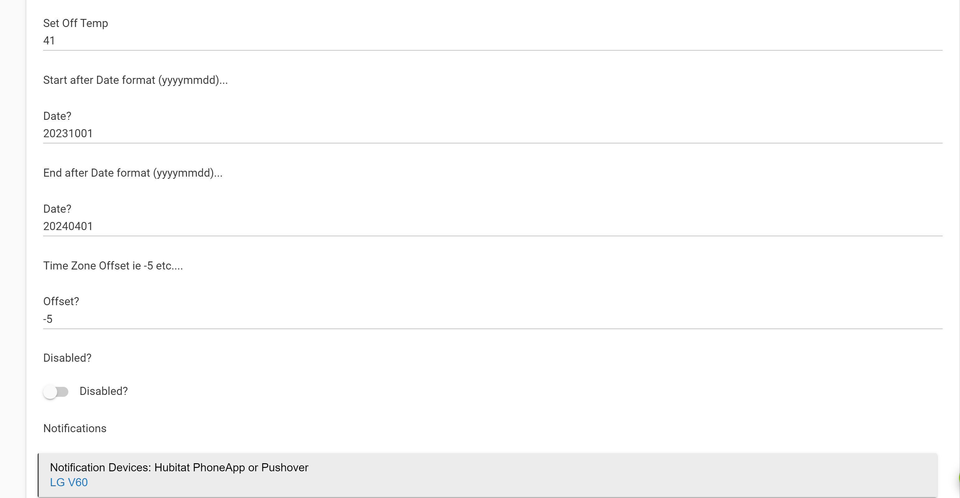

you could use a rule.. but i have an app i wrote for this a long long time ago back in the smartthigns era after my roof got an ice damn because i forgot to turn it on after a snow storm and subsequent melt.. i figured it was better to waste enegy than fff up my roof again..
if you search in package manager it will be there.
i didnt bother with sensing snow as the problem is not when it is snowing but when you get a ton of snow on the roof and next time it warms up and it starts melting.. (that could be days later) at least it was in my case.

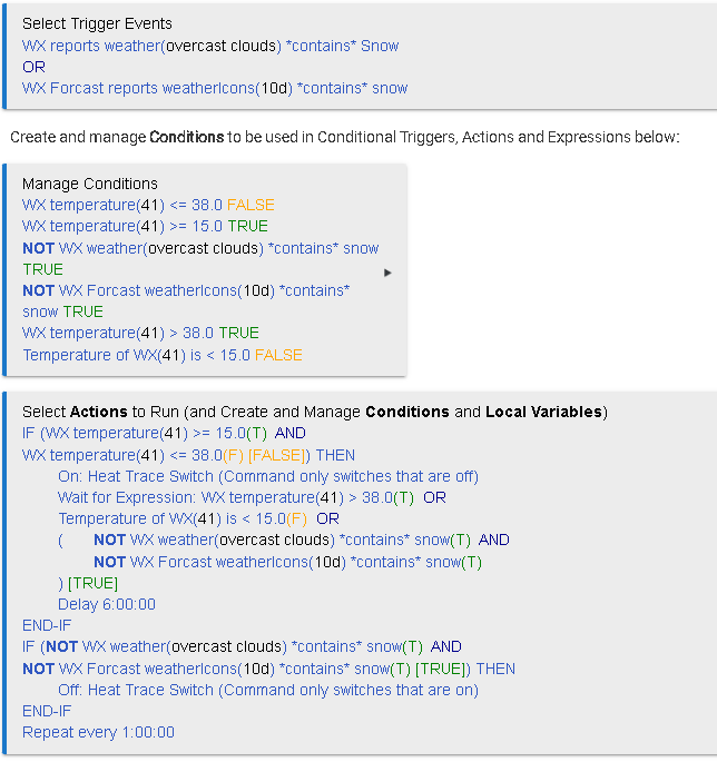

Below is what I have, my issue is that I want to create a second "IF" for if conditions are not met to re-try in an hour. Alternatively, if I can add, "if trigger conditions are met, attempt program every hour," that would also work.
I've read some bits about Boolean, but do not fully understand it. From what I've read, I should be able to create a boolean that would say, "If the temp is between A and B, then true," but I can't seem to figure out how to write that script.

@kahn-hubitat, I'm sorry, I misspoke. I need the forecast bit. We go weeks between precipitation, and I don't want to heat the outside when there is no new snow.
@dylan.c, the END-IF command is exactly what I was looking for. Thank you.
Looking at what you were saying about constraints, if I am running the program for 6 hour after the snow falls, I don't actually need to repeat it. The next time the trigger happens, the program will restart.
The issue arises if the system triggers a new snow event during the cooldown, so I created a new IF to check that a new snow event has not started before shutting the system down. It would then repeat the cycle an hour later to check on the temperature until the triggers are not in effect.

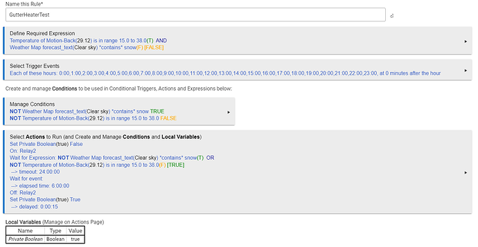

I think I would approach this rule a different way. Not saying yours is wrong...there are multiple ways to accomplish any given task in RM. This one just suits my way of thinking about the intended outcome...
Stepping thought it piece by piece...
Required Expression: Using your desired temp range and forecast condition as required expressions will only enable the rule to execute when those conditions are met. Any other time the rule will simply not run.
Trigger: I have it running at defined times of day (every hour, on the hour). This might be overkill. Another approach is to use the "Every 1 hour(s) starting at 12:00 a.m. " Probably no functional difference. Either way, if the the required expression is FALSE (temp out of range or no snow in forecast), the rule does not run.
Actions:
First step sets the private boolean to false to prevent multiple instances of the rule from running.
Next we turn on the heat trace (Relay2).
Now we wait until either the forecast changes or the temp moves out of range. If neither changes within 24 hours, we assume something is broken and move to the next step.
Now that its stopped snowing, warmed up, or cooled off, we wait another 6 hours for good measure.
Finally we can turn off the heaters. Worst case scenario, they've been running for 30 hours.
We set the private boolean back to true and the rule is allowed to run again. You can disregard the 15 second delay...that snuck in at the end and isn't needed.
The way my example is structured, the heater will turn off and then back on at the next triggered time...up to one hour later. If you want to keep the heater on the whole time, you would just move the "Set Private Boolean to TRUE" before the "Wait for 6 hours" action.

The main difference is taking advantage of the "Required Expression" and "wait for Expression" features. These are basically short-hand ways to replace the IF statements and repeats that you were using.
My example could probably be trimmed down even further by removing the "wait for Expression" bit (and the associated conditions) and the private boolean lines. I think it would work exactly the same but without the "safety" privided by the timeout. Don't take my word for it though... be sure to test it in your environment.

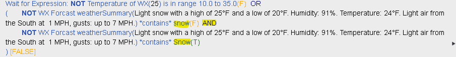

A note for anyone who finds this thread and wants to use the code: since everything is case sensitive, you need to account for both "Snow" and "snow" (the second for when the WX device reports "Light snow."
