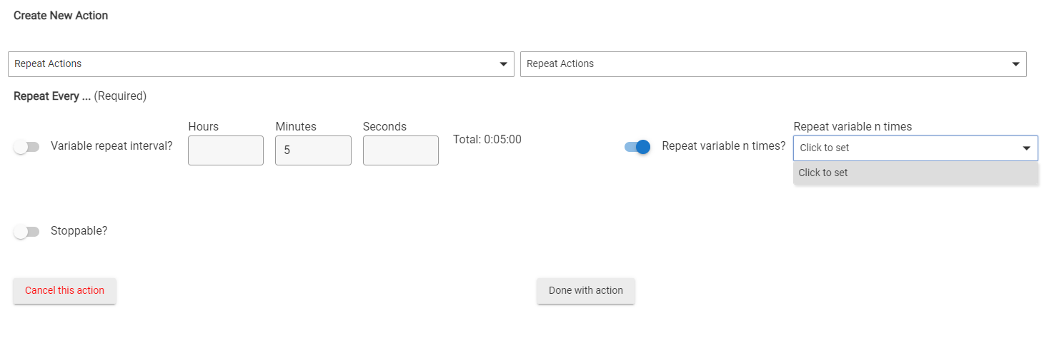

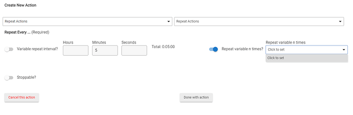

Trying to setup a Repeat function and I don't think the setup procedure is working properly. While creating a Rule, I went to Selection Actions to Run>Create New Action>Repeat Actions>Repeat Actions. Enable Repeat variable n times and you cannot enter a number. Enable Variable repeat interval and you cannot enter an interval. Looks like the only way to enter a repeat interval and repeat n times is to not enable either of them. Or, enter the interval and n times, THEN enable them. Suggestions?

If I enable Repeat variable n times, I do not get the choices you show. I get this;

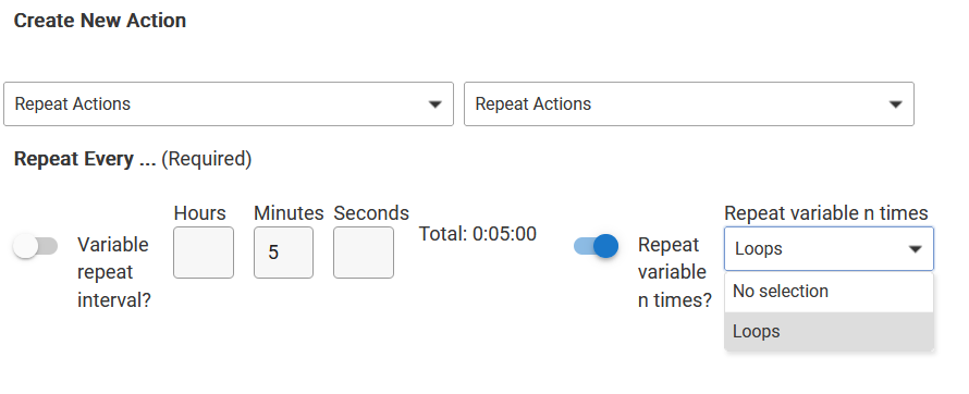

Do you have any local or hub variables of a numeric type set up? If not, you won't have any options.
Like bert said, you need to create the variable first. Then you will be able to select it from the drop down list. I believe the variable needs to be defined as a number variable.

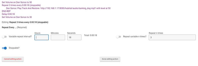

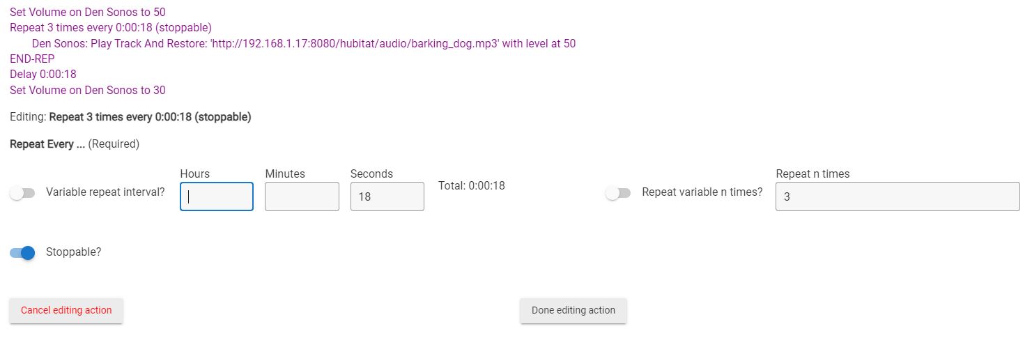

The toggle is only there for if you want to use a variable. If you are using a specific number of time and repeats, simply enter them into the fields, and do not enable the toggles.
Here is a screenshot of my barking dog. I have it set to repeat three times, every 18 seconds (the length of the sound clip).
