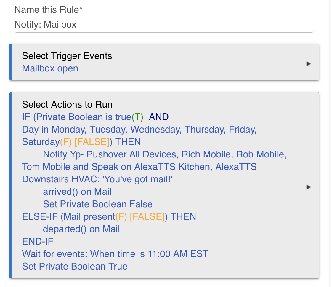

Could be because the condition is re-evaluated after 10 minutes and it fails. Here is my mailbox rule where I notify a few neighbors too given our delivery time is so unpredictable. I also have a virtual presence sensor get flagged when mail arrives and departs when it’s picked up since my kids sometimes get it before I do. I just check my dashboard to know whether it’s been picked up or not. So far this has been working great.
