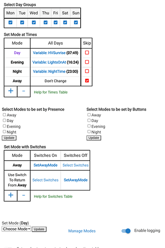

I am trying to set the mode to Away using a Virtual Switch and to return to current mode according to timings when the switch is switched off.
The switch being turned on does set the mode to Away as expected but switching it off does not return it to current mode according to timings.
Where did I go wrong? C
onfiguration and log attached

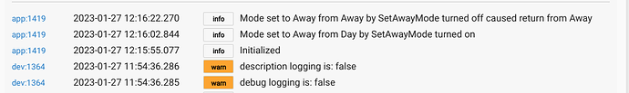

Can you show the mode it was in and the one it returned to?
chrisg
January 28, 2023, 7:52am
3
The mode was Day when switch SetAwayMode was set on, it remained at Away when the switch was set off. The log implied that it was set to Away again.

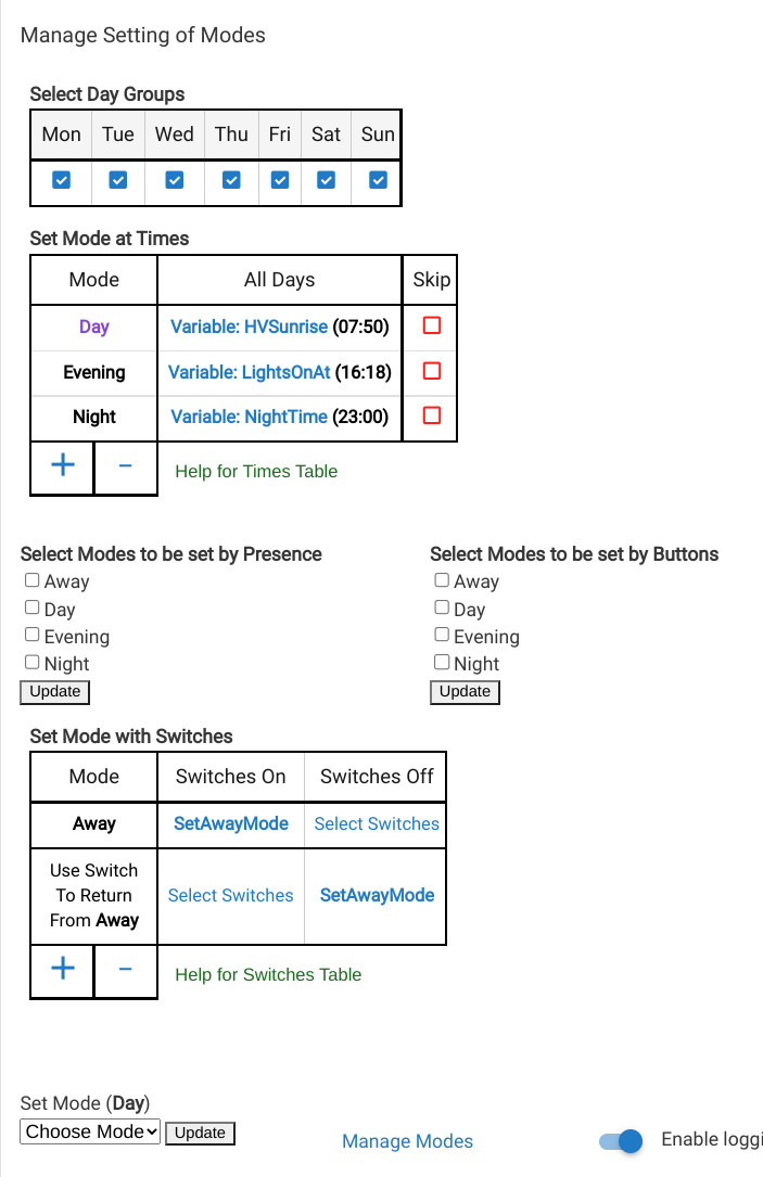

Oh yea, I missed that! I tried to reproduce it, and when I turned off my virtual switch, it went back to “Day”. We may not be on the same version though - what hub platform version are you on?
Try removing Mode Manager and adding it again to see if the issue persists.
chrisg
January 28, 2023, 1:28pm
5
Thank you for your help Sebastien.
I am on v2.3.4.134.
Removing Mode Manager and re-installing and configuring seems to have worked, as per attached.
The Set Modes at Times table has gained an extra Mode of Away but hopefully it is not configured and will be ignored.
