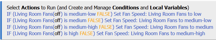

You really want to use the ELSE OPTION shown in this screen shot as a way to allow mulitple conditions to work
Yep, simple conditionals. And those screenshots are of one of my rooms using same as OP, the zooz scene controller and bond fan.

LOL...totally right. I had just redid that one because that fan stopped working with the bond for some reason. I just tested and boom, straight to low. FWIW the other room is correct for going down:
