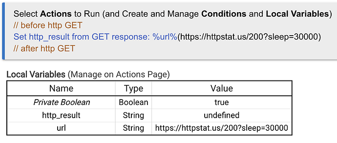

What is the expected outcome of a rule action http GET call timeout? Using a test URL that always times out, for demonstration purposes:
Throws an exception, therefore the rest of the rule never executes:

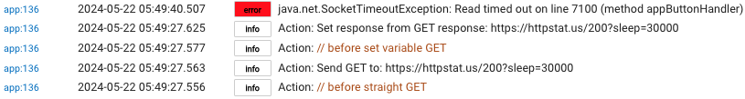

You can use https://httpstat.us/200?sleep=30000

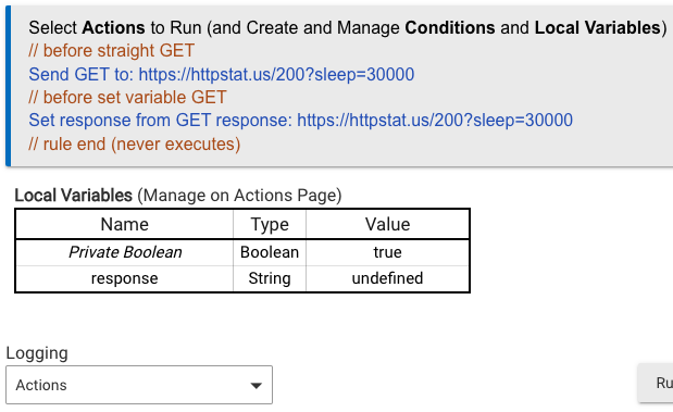

Note that a straight GET action seems to be fire-and-forget and doesn't generate a timeout exception. I am setting a String variable to http GET result.
I'm using that url with no timeout error.

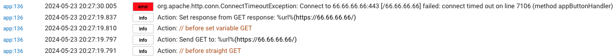

Same with 66.66.66.66, no error.

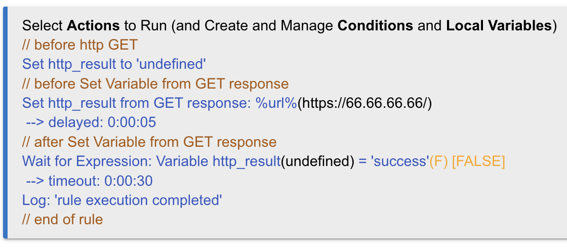

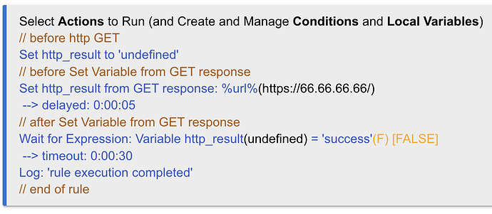

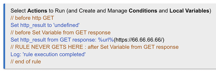

Very strange. I tried the same test rule on another C7, running 2.3.8.140 and set up on a different LAN & internet connection, and get the same result. Here is a slightly modified version to highlight that only the Set Variable from GET (or POST) response is problematic :
Still seeing this on 2.3.9.135.
Am I really the only one seeing this behaviour (on three different hubs) ? Anyone else is game to give this super simple rule a test ?

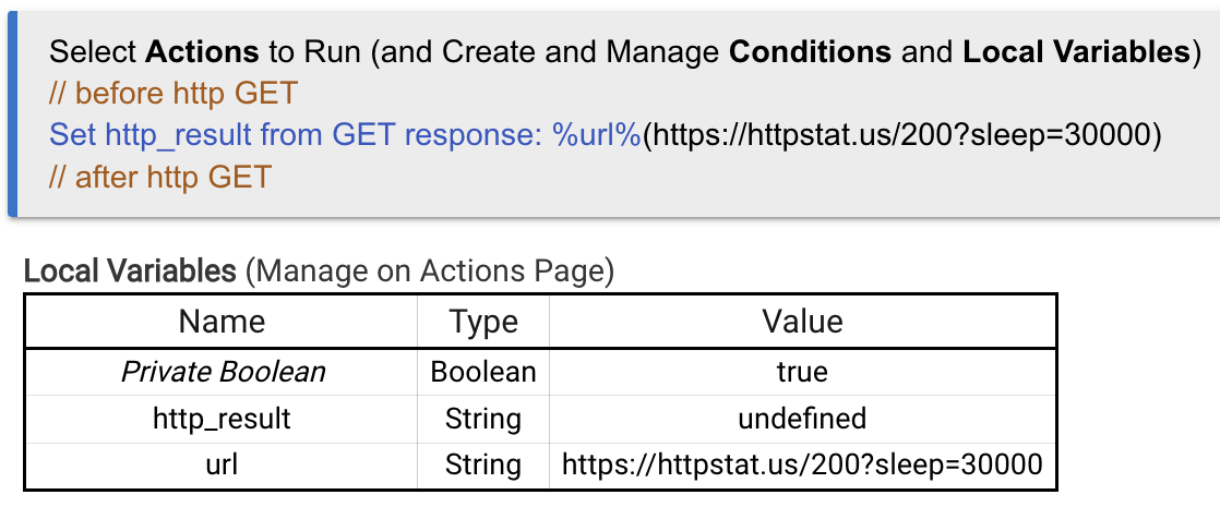

In my case this RM feature throws an exception for anything that's not a 200 coming in within a 10 second timeout:
Throws a different kind of exception (connection error) but same same

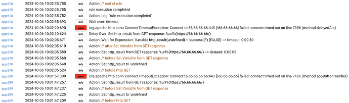

@bravenel I still observe this behaviour in the latest 2.3.9.x release. The rule doesn't continue past the exception thrown.

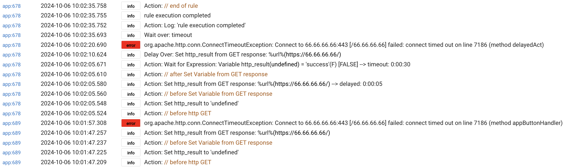

I have worked around it by adding a delay to the Set Variable from GET action and either adding a Delay or Wait for Expression action after it, this way, rule execution continues.

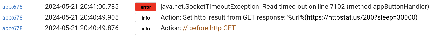

See logs below. App 689 fails to run the actions beyond the thrown exception. App 678 has the workaround.
Actions for app 689:
Actions for app 678:
