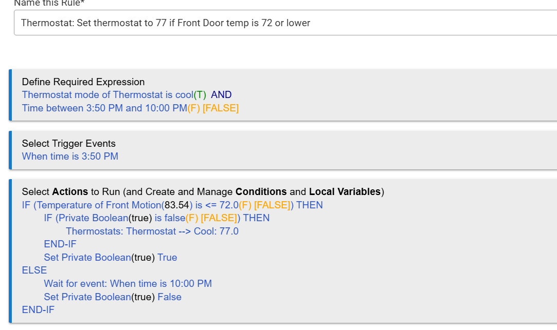

Hello All,
Did I set up this rule correctly? I only want the rule to run once in the time frame 3:50pm to 10pm. I may want to set to a different temperature after the rule has run. I don't want it to set it back to 77 after I changed it.

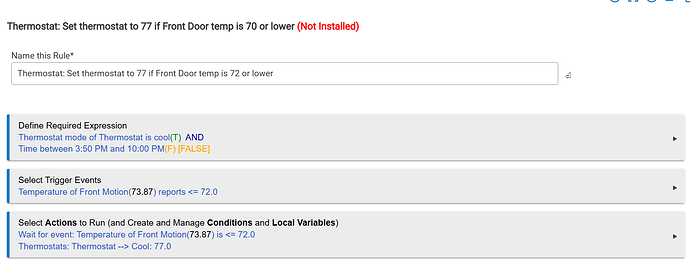

Your first action is just a wait for your trigger event, so that doesn't make sense. This is one idea off the top of my head (I'm sure there are other ways too)...
Reqd Expression = stat is cool
Trigger = time is 3:50 pm
Cancel timed actions (this rule) -> delayed 6:10:00
Wait for expression - temp motion ≤ 72
If stat Not 77, then
    stat -> cool 77
End-If

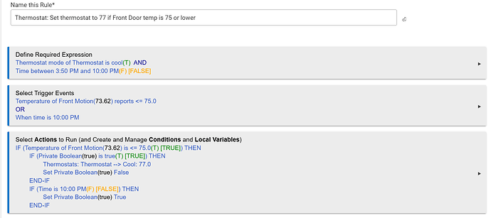

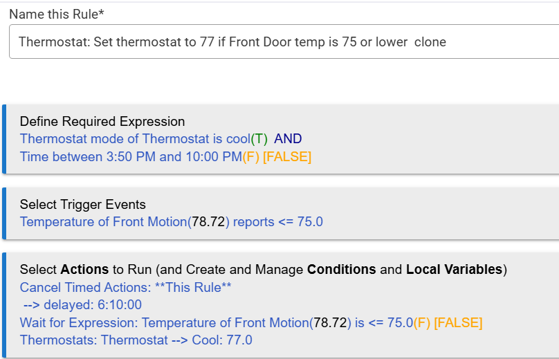

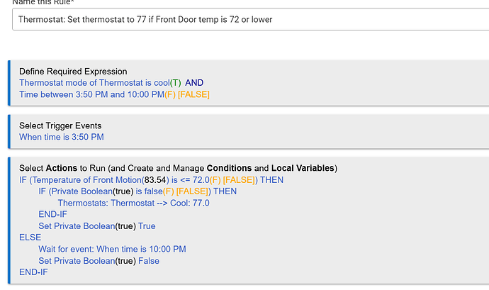

Thank you for your response and explanation on how your rules works. I recreated my rule using Booleans. Do you see anything wrong with it. If that doesn't work then I will try your rule with Booleans included to run once. I've never used "cancel timed actions" because I never understood it until your explanation. I understand now how to use of it instead of using a time frame in required expressions. I like having the required expressions on the time frame because the rule can only run in that time frame.

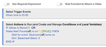

Here are 2 examples of "once per day" rules I use... This first one requires no time window, since "Mudroom" is activated by a motion sensor that we trigger dozens of times throughout the day, so this rule fires with 100% reliability whenever we happen to get up every morning.

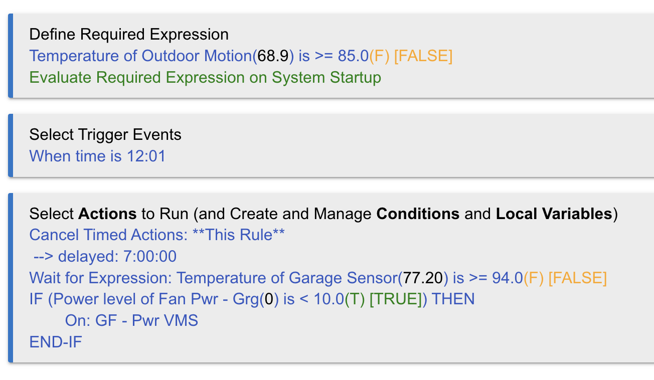

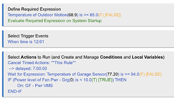

This next one is what I based my suggestion off of... This one turns on an exhaust fan in our detached garage when unusually high afternoon temps cause it to get overly toasty out there. The 7-hour delayed cancel otherwise sidelines the rule at 7pm (since the daily threat of rising temps is effectively over by then).
For the rule you posted above my latest post...
Using 3:50 in both the Reqd Expression and Trigger is likely to be problematic - there's a good chance one will step on the other.
Your motion temp is evaluated at 3:50 and then never again - I'm fairly certain that's not your intent?
I think you are right. I'll make a change and see how it goes. I'll post my results tomorrow.

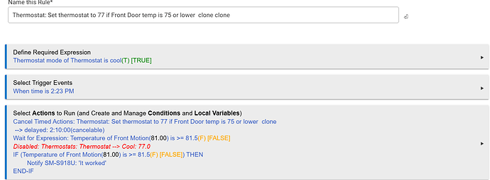

Thanks for your help @hydro311. I was able to apply the Cancel timed actions to a couple of my other rules. I was able to make it work with this rule. I'm sure there's much shorter version to do this. I just don't know enough.
I wanted the ability to turn down the Thermostat below 77 without retriggering the rule until the next day.
Did you mean to say "wasn't able to make [cancel timed actions] work..." here?
If so, what is the issue/concern you encountered?
I didn't try the Cancel rule. I think I could of used it instead of the Boolean. How about this.

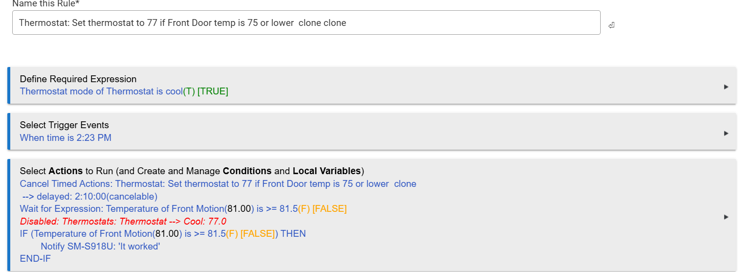

This one also worked. I had it send me a message for testing.
I'll add the start time of 3:50pm instead of the time range. I'll also add the If then for the extra insurance to set the Tstat as a second trigger.

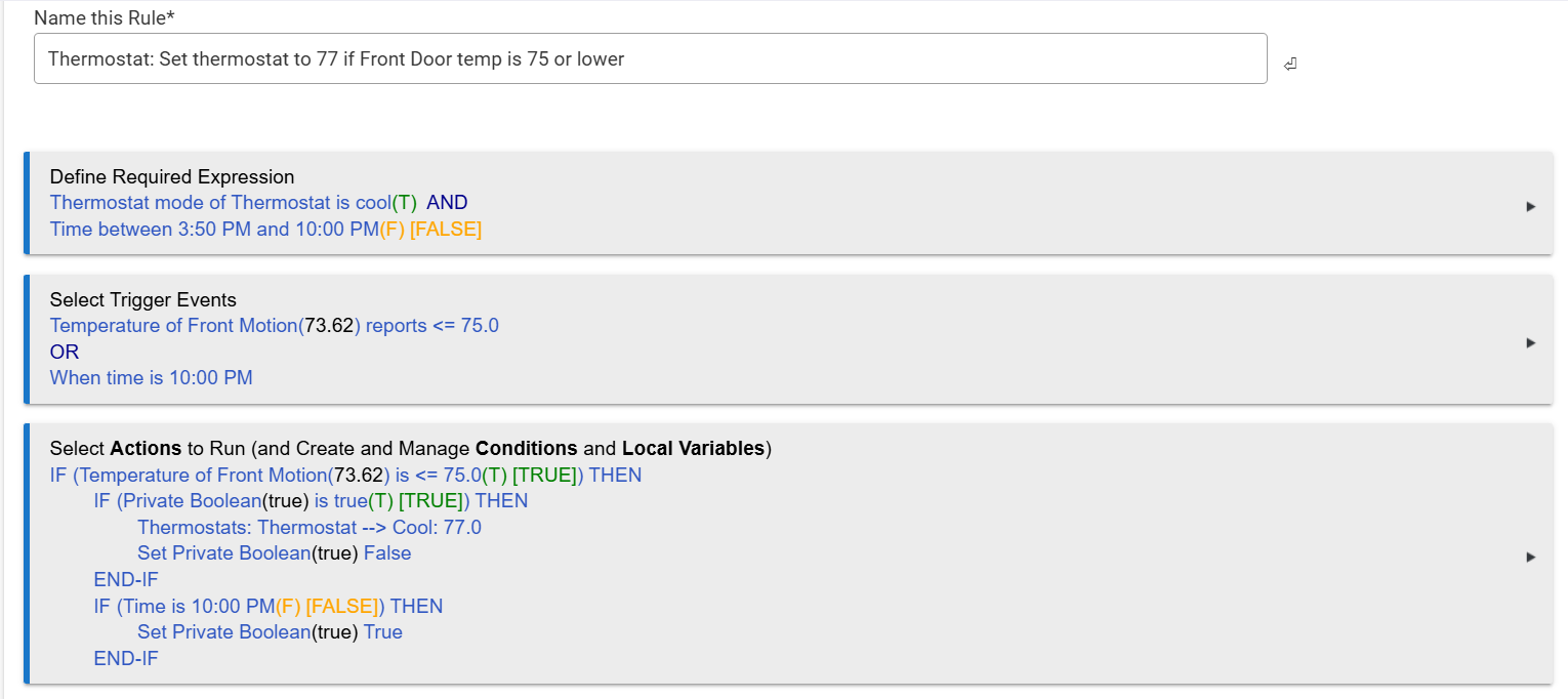

Here's the one I just set.
For Cancel Timed Actions, you literally want to select the "This Rule" option -- there's no need to get any more more creative than that.. When that option is selected, it'll look like my own real-world rule (second image) that I posted in post #6
In the If-Then, I think you want to use Tstat not ≤ 77 instead of Motion temp -- there's no need to involve the motion temp there, as your goal is to prevent the rule from setting the tstat to 77 if you happened to (manually) already have it turned down to 74 (for example).
The last one I posted with the If then statement trigger at 2:29pm. I like the extra insurance that will run. I've made the changes to run at 3:50pm. Much Thanks for your help on this.
Btw, I also changed the if-then to ≤77.
