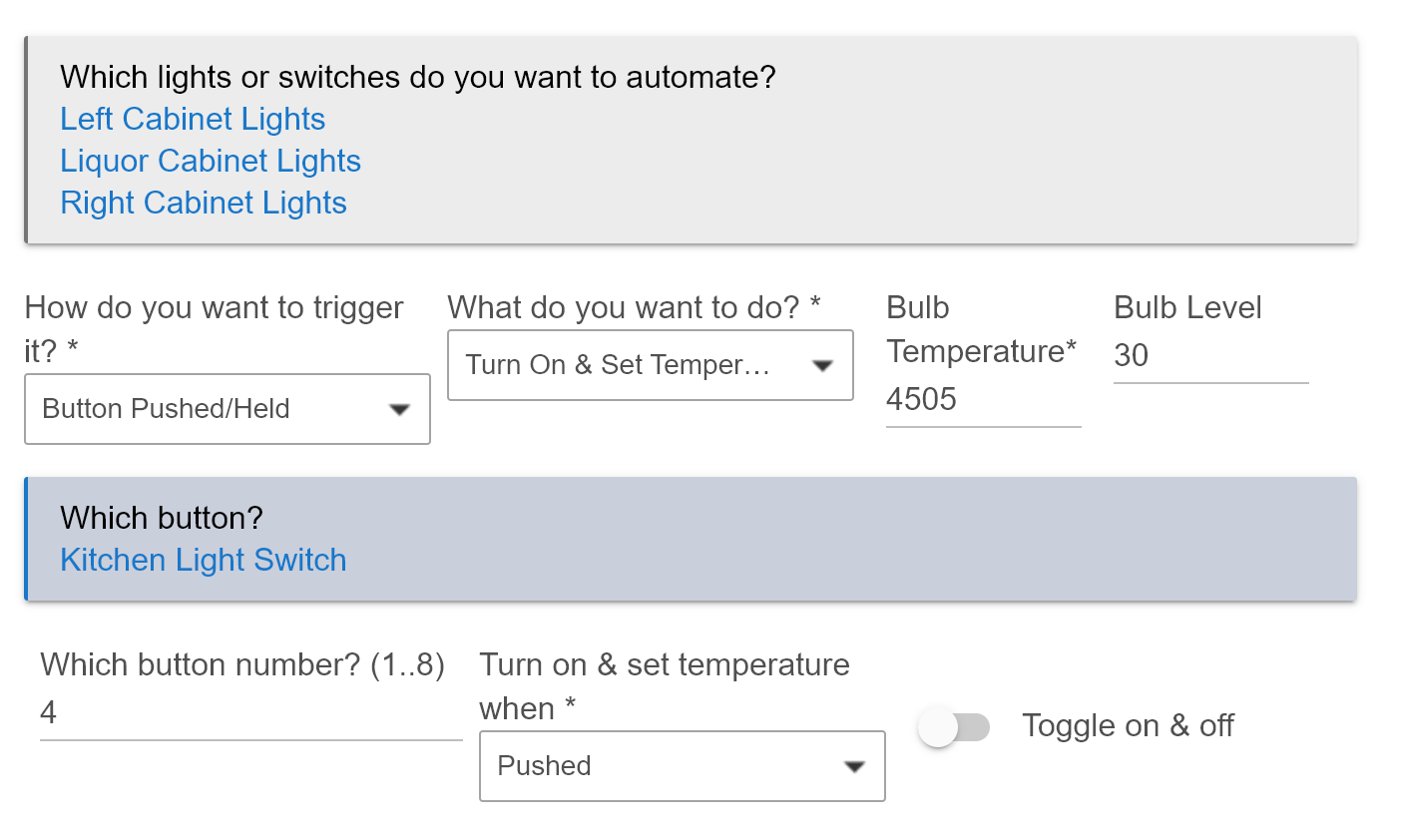

I have a Simple Automation to turn on and set the level and color temp of a LED light strip. This has been working flawlessly in ST for the last several years. With HE, I almost never get the level set correctly. The light always turns on, but 90% of the time, the level isn't set. Occasionally it does work. Once the light is on, then the level always gets set if I trigger the button again.

I am using an Inovelli switch to control three Zigbee LED strips. When I tap up on the switch, the automation must turn the lights on at 100% and when I tap the setup button, it turns on the lights at 30%.

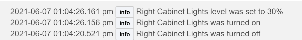

The message is sometimes logged in the device log but not executed by the device. Sometimes I don't see the level message in the device log.
This is the automation:
