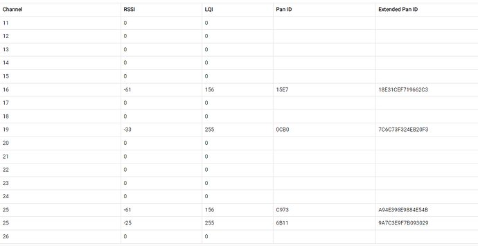

On the Zigbee radio, I have 3 hubs (1 old ST hub which does almost nothing and 2 Hubitats - a C-7 and a C-8). The ST hub is on Zigbee channel 19. The C-7 is on 16 and the C-8 is on 22. A scan on the C-8 also picks up something on 25, so that's why I'm not using it, though I have no idea what it could be. Is it still OK to use?
your voltage looks normal. Channel 25 occupied... signal strenght on the low side? Go ahead and use it. No WiFi is on it which is a plus.

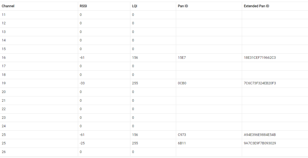

Done. Here is how the channel scan looks now:
Hopefully between this and having the electrician check things out, I can get those 2 bulbs working again. I still feel like something must be wrong at the fixture since it took a working bulb (paired in a different fixture and tested as working) and fried it (moved the bulb, turned it on, didn't work, moved it back, still doesn't work).
