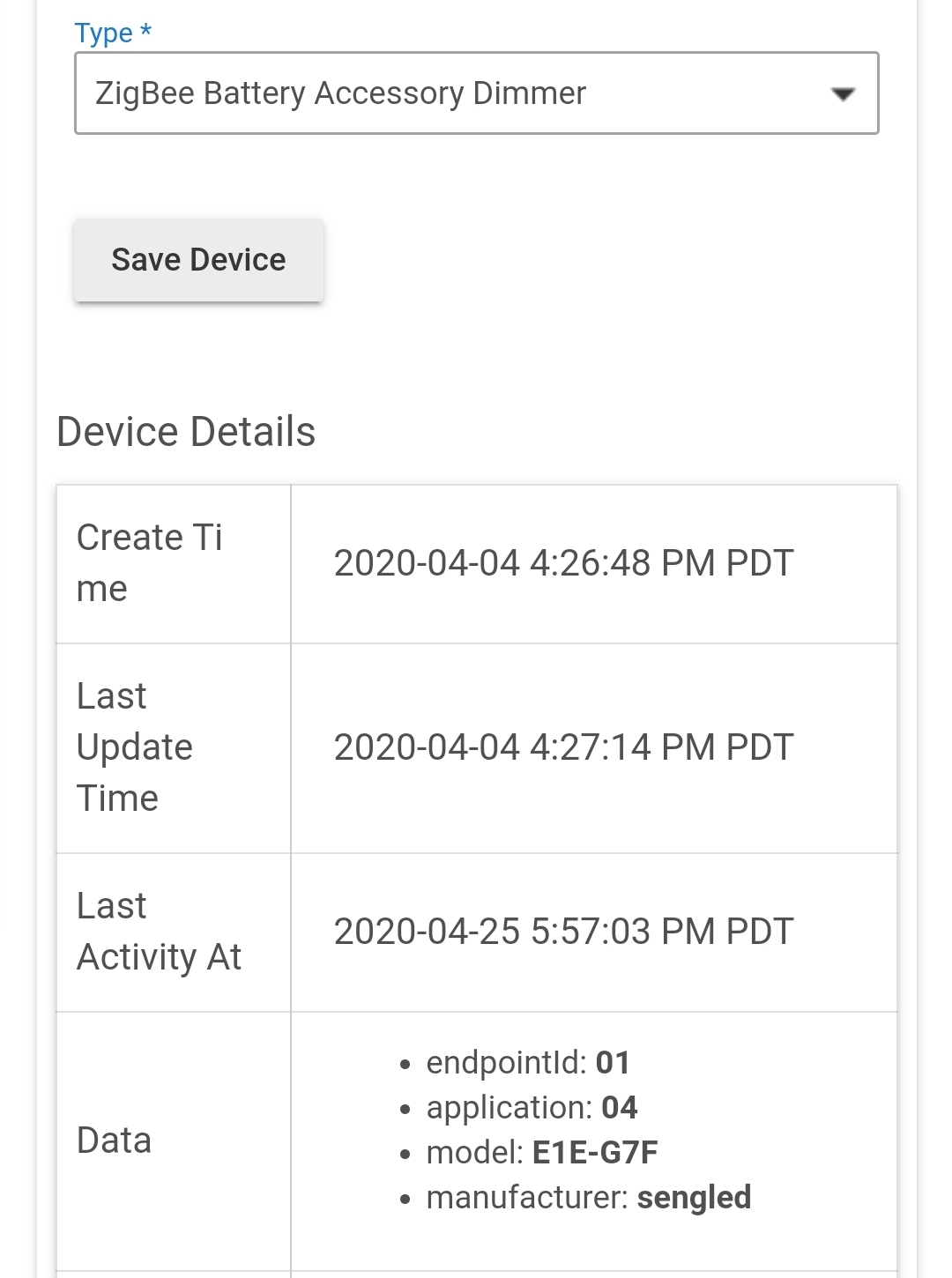

I was able to connect a Sengled Smart Light Switch as part of my migration from ST to HE. All buttons and functions (double press and hold) work fine for me.
I used ST code of a "ZigBee Battery Accessory Dimmer" Device Type with a single modification. "physicalgraph" needs to be replaced with "hubitat" in line 14.
Code that works for me:

@hidoyatov.v.i how exactly did you configure this? i paired the Sengled Smart Switch, I used your DH from above. But it only shows 1 button, and even that does not seem to work. thanks
Hi @sanewton72
What do you mean under "1 button"?
Please make sure that type of the device is "ZigBee Battery Accessory Dimmer".
If you open the device on your local HE website, you should see commands similar to other switches (On, Off, Set Level and etc.)
Please see screenshots of my device.
thanks. i grabbed the updated version of the DH you posted earlier which made all the difference, now all configured & working well. If anyone has one of these things, it works well once you figure it out, if you want more info how to configure it going just ping me.
