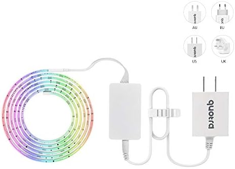

I got this Zigbee one about a month ago, it works without issue on Hubitat

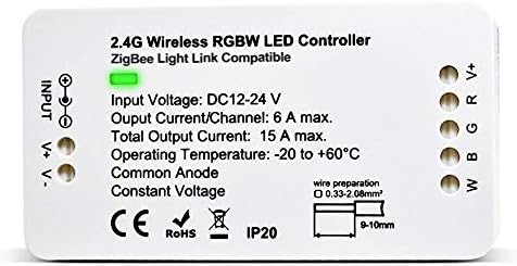

I like the pre-packaged kits but lately I've been using these:
I have had two for months now, working well for me.

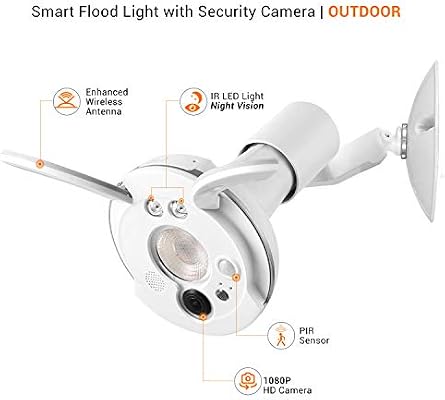

Or the outdoor light with built in camera:
But then I guess I want my home automation to be more like Star Trek. Walk up to a door and it slides open, etc. When is the Hubitat replicator coming out?
I really like skimping with the GLEDOPTO controller like that one, but I undersized the power supply and it overheated. It's recovered and since left the hospital, but I had to buy a bigger nicer one from amazon so I didn't light my daughters room on fire.
Some of the cheap Chinese RF kits are nice to just splice these bad boys into, that's what I've done for my front landscape lights, and soon my pool lights.
Moral with these they really help undercut the price if a power supply doesn't cut into the rest of the cost savings.
Just my experience.
And the push in connectors suck, why wouldn't they be screw terminals!?
